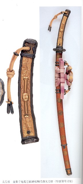

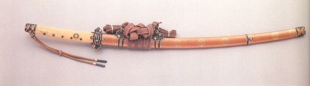

Sorry, PMs don't hold pictures so I've to bother you here again.
The cord at the end of the hilt is a retention cord to be wrapped around the whirst in order to avoid the loss of the sword when cutting. It's impossible to
wrap such a cord on both hands. Even if not all Tachi mounts have such a cord, the mounts has been engineered to have it. This is an evidence of its use as a single hand sword, no matter about the lenght of the Nakago. Don't be fooled by terms, think at the actual use (pictures attached).

Sorry forgot pictures of the tachi whristlace :
tsubame1 is offline   Reply With Quote
