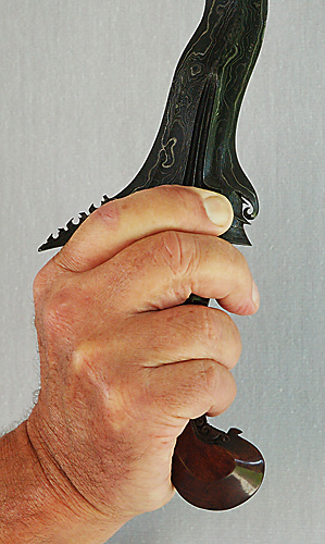

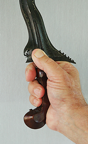

I would like to restate my question about the position of the handle... does anyone have any picture or knowledge of how the handle was positioned in Jawa when the keris was still a weapon? And also, in the Majapahit and earlier eras, what was the keris Bali like?

Several people have asked me for a photo of the grip I describe.
Here you have two.
