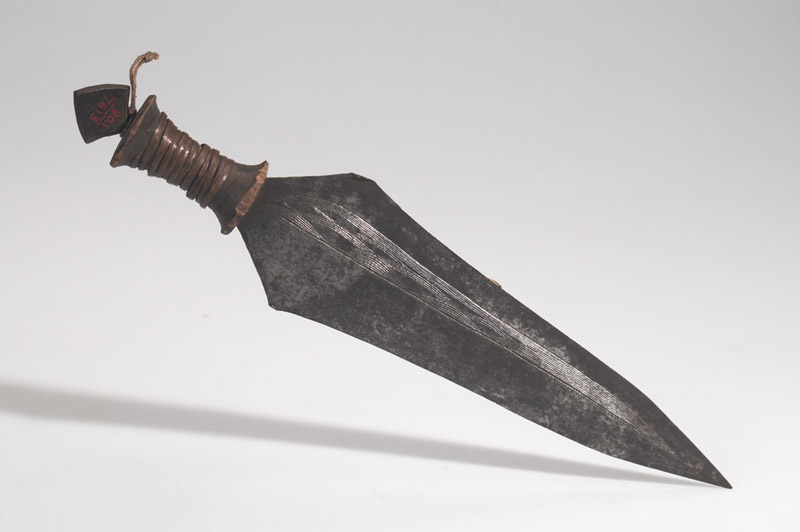

LOKELE knife from AMNH
Luc

Now I know where this one came from, and what a better-class example looks like.
