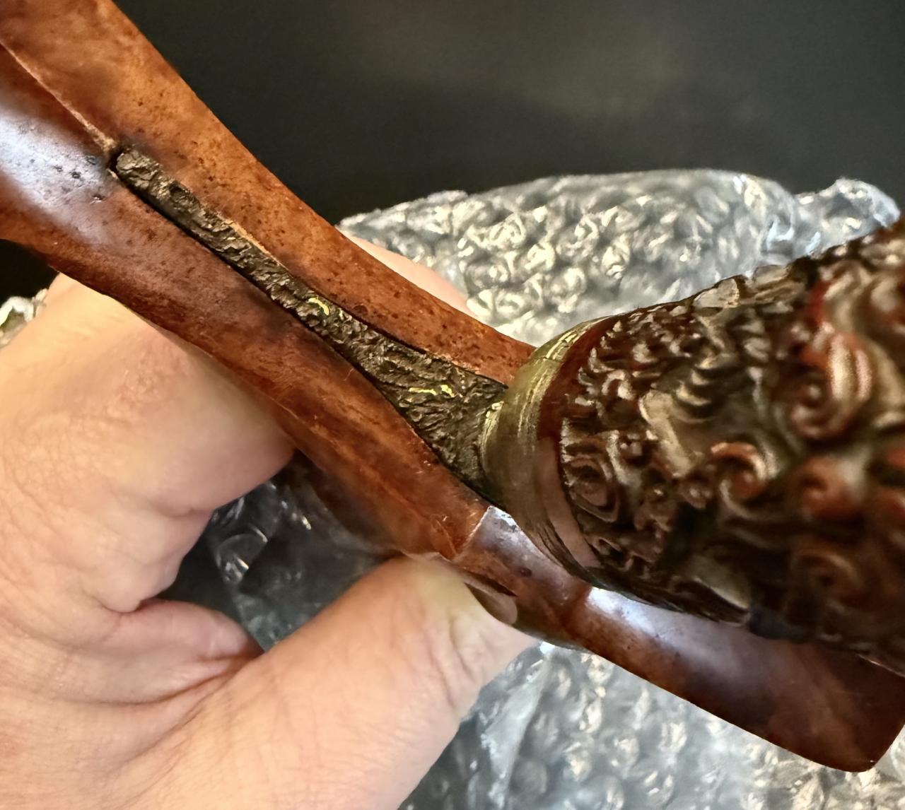

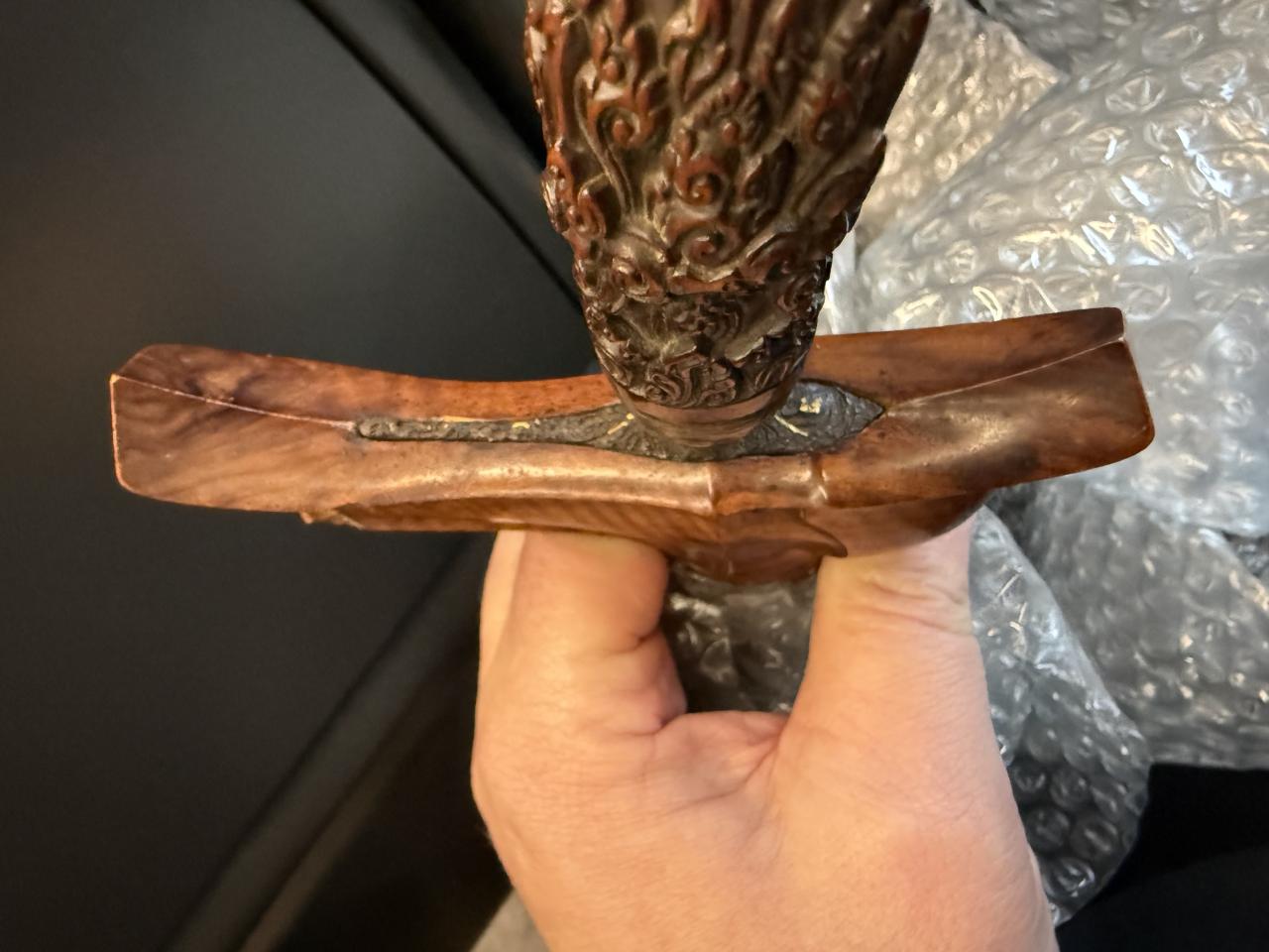

I like to share two pictures of the keris that i won tonight in an auction and will pick it up end of this week.
It was stated Indonesian Keris but the dress is Palembang, and the ukiran is imho Madura
So the blade is in need of a washing, is the blade Madura too? Or is this a mariage ?
Hope to hear from the experts.
Regards, Martin

Hi Martin,
Now I know who bid me out! The blade is Palembang too IMO. When you look close you will see that on top of the gonjo and the gandik area had once kinatah. The hilt is North-East coast of Java, not typically Madura.

Yes, I agree that the hilt is North coast Jawa, & tending towards the east, however, the selut is typically Palembang.
Historically there have been very close ties between Jawa & Palembang. Palembang Keris blade style follows Javanese style very closely, & frankly, I cannot tell from a photo the difference between a blade that might be Palembang, or that might be Jawa or Madura. I would need to handle it & even then I might not be certain.
This keris could be a marriage, but then we need to consider the historical ties and the fact that it is in a Palembang wrongko. Maybe it is not a marriage. If it were mine I'd leave as is. Lots of mix & match examples of keris exist that are true to the area from which they come, not put together somewhere else.
There is something else too. In recent years current era Indonesian collectors & dealers have been trying to promote the recognition of a "tangguh Palembang". In my opinion this is a total impossibility, for the very simple reason that there is no uniquely Palembang blade. A genuine keris Palembang, in the sense of a keris put together in Palembang for wear in Palembang can have a variety of different blades used, including Bugis, Javanese, Peninsula & still be the real deal. The old Javanese tangguh system does not recognise a tangguh Palembang.

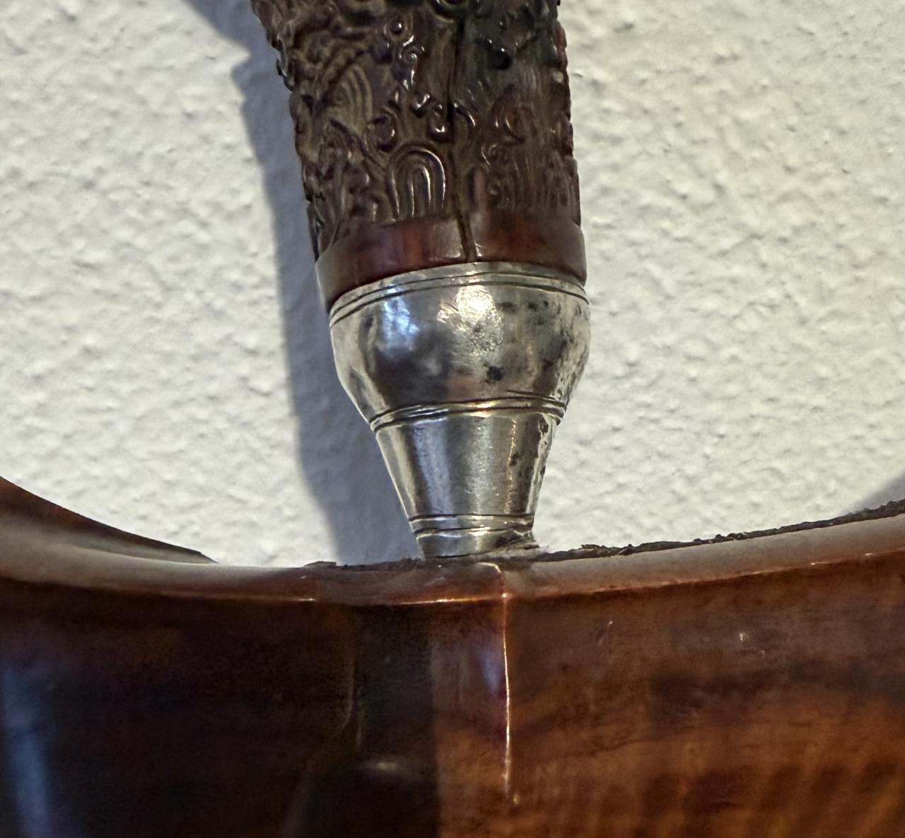

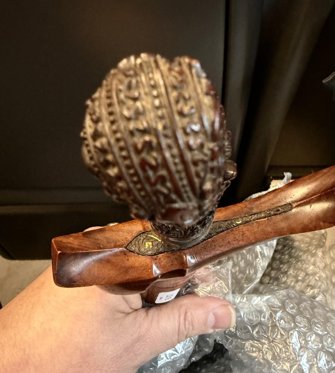

So I am in the train back home after picking up the Keris. And could not resist to share two pictures of the fitting of the Keris and the last remains of the Kinatah.
I think the fit is beautiful.

It seems very likely indeed that this Palembang style sheath was indeed made for this blade. As for the hilt, it could have been a later addition given it's North Coast origin, but since the selut is clearly a Sumatran style i would be inclined to think that this ensemble is a legitmate Sumatran one rather than a dealer marriage. Have you determined the material of the selut yet. Could be silver. Seems you got yourself a fairly nice Sumatran keris there with a nice Ganesha hilt. Shame the kinatah is gone, but not the worst thing. Congratulations!
