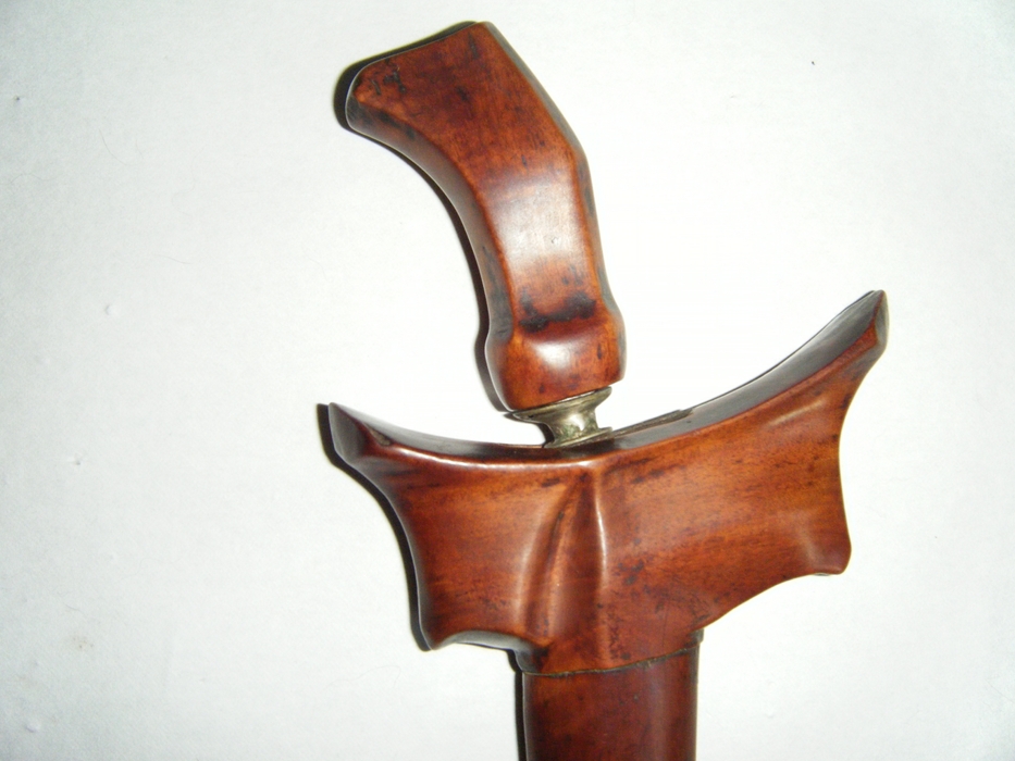

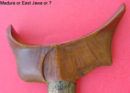

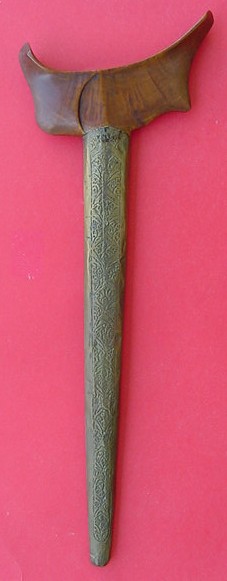

Hello Séverin,
The wrongko could be from East Java/Madura, a seldom seen form. Here are a few examples taken from this old thread: http://www.vikingsword.com/vb/showth...ghlight=madura
Old 19th October 2025, 08:31 PM   #5
Posts: 7,230
I'd be inclined to place the wrongko as Madura, the hilt I cannot say with any certainty, the blade as Madura/East Jawa.

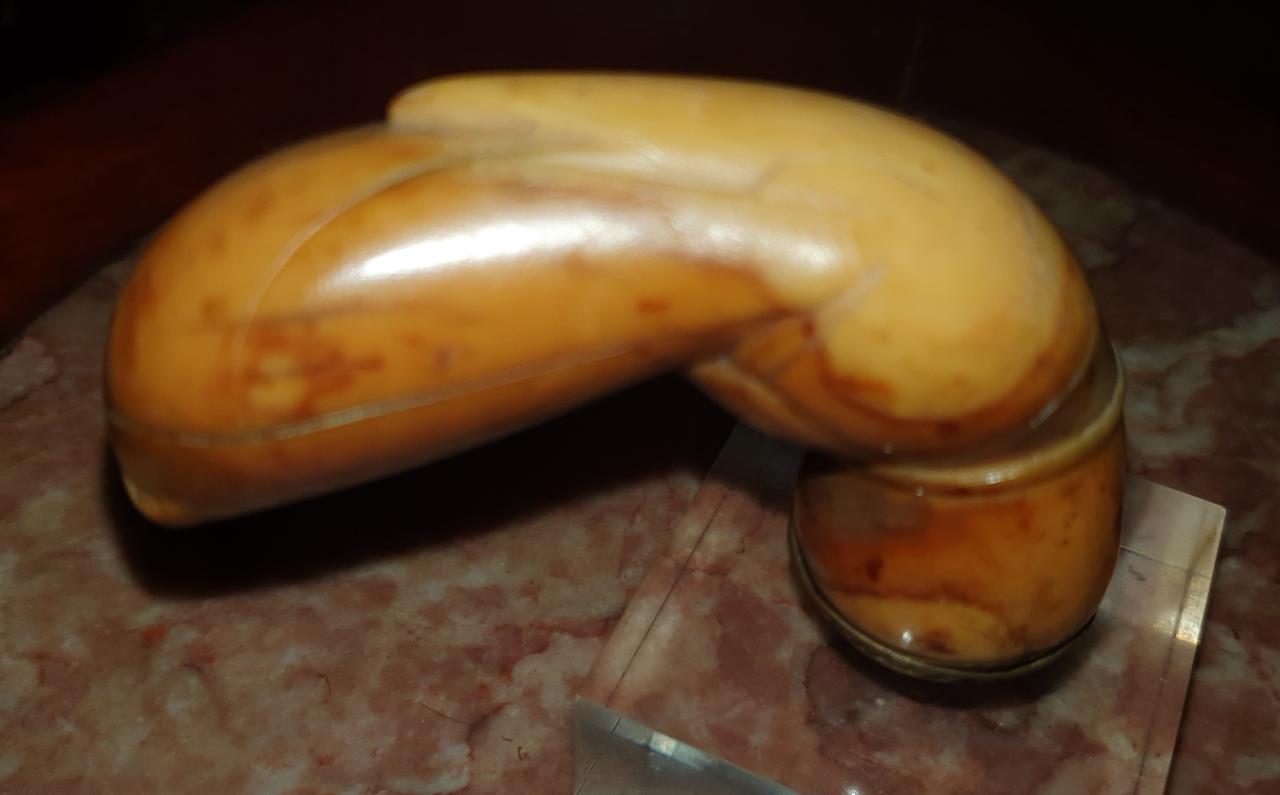

Yes, the blade shows a Bugis style but there are some unusual features, I agree.
The wrongko is as well somewhat unusual for Madura, the lata is straight by the example in question, by the examples shown from me not.

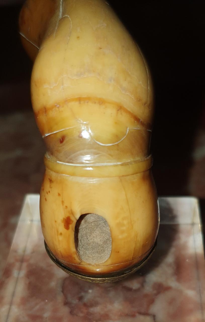

The hole in the pangulu handle isn't unusual, see the pics of one of my pangulu hilts.

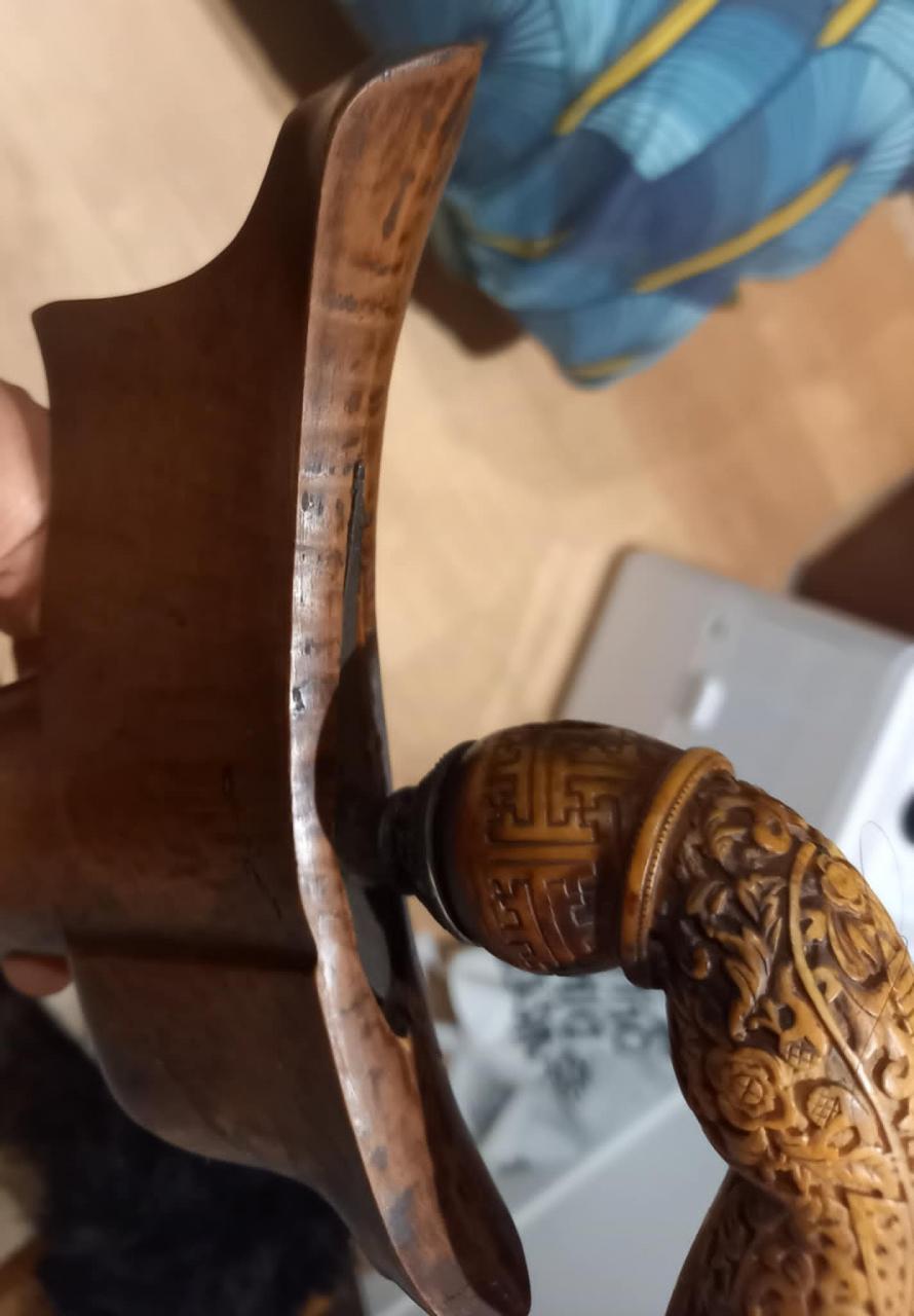

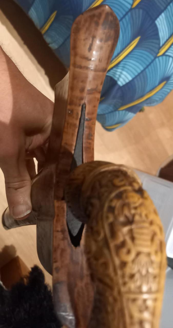

Old 21st October 2025, 10:30 PM   #11

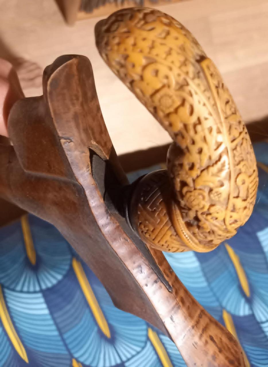

Athanase
Athanase's Avatar
Join Date: Mar 2016
Location: Paris (France)
Posts: 432
Thank you all for your responses.
I apologize for the delay in responding.
Here are photos of the blade in its sheath.
Old 21st October 2025, 10:49 PM   #12
Posts: 7,230
The form of the sirah cecak & the buntut urang is not typical of a keris that can be classified as Bugis, however, it is typical of a keris that can be classified as East Jawa or Madura.

Posts: 432
I checked, one side of the blade is very flat, the other is very slightly lenticular.
The blade seems a little thinner than more traditional Bugis blades with a hexagonal cross-section.
Old 23rd October 2025, 02:23 AM   #14
Posts: 7,230
That hex cross section is what I mean when I refer to "flat faces".
Does the blade have a hex cross section?
Old 24th October 2025, 12:11 AM   #15
Athanase
Athanase's Avatar
Join Date: Mar 2016
Posts: 432
I compared with Bugis keris and Javanese keris and... it's not so obvious, but it's closer to a hexagonal section, but the angle between the flat surface and the cutting edge seems to have been worn so it's not very sharp anymore (Too violent cleaning of the blade in the past?).
