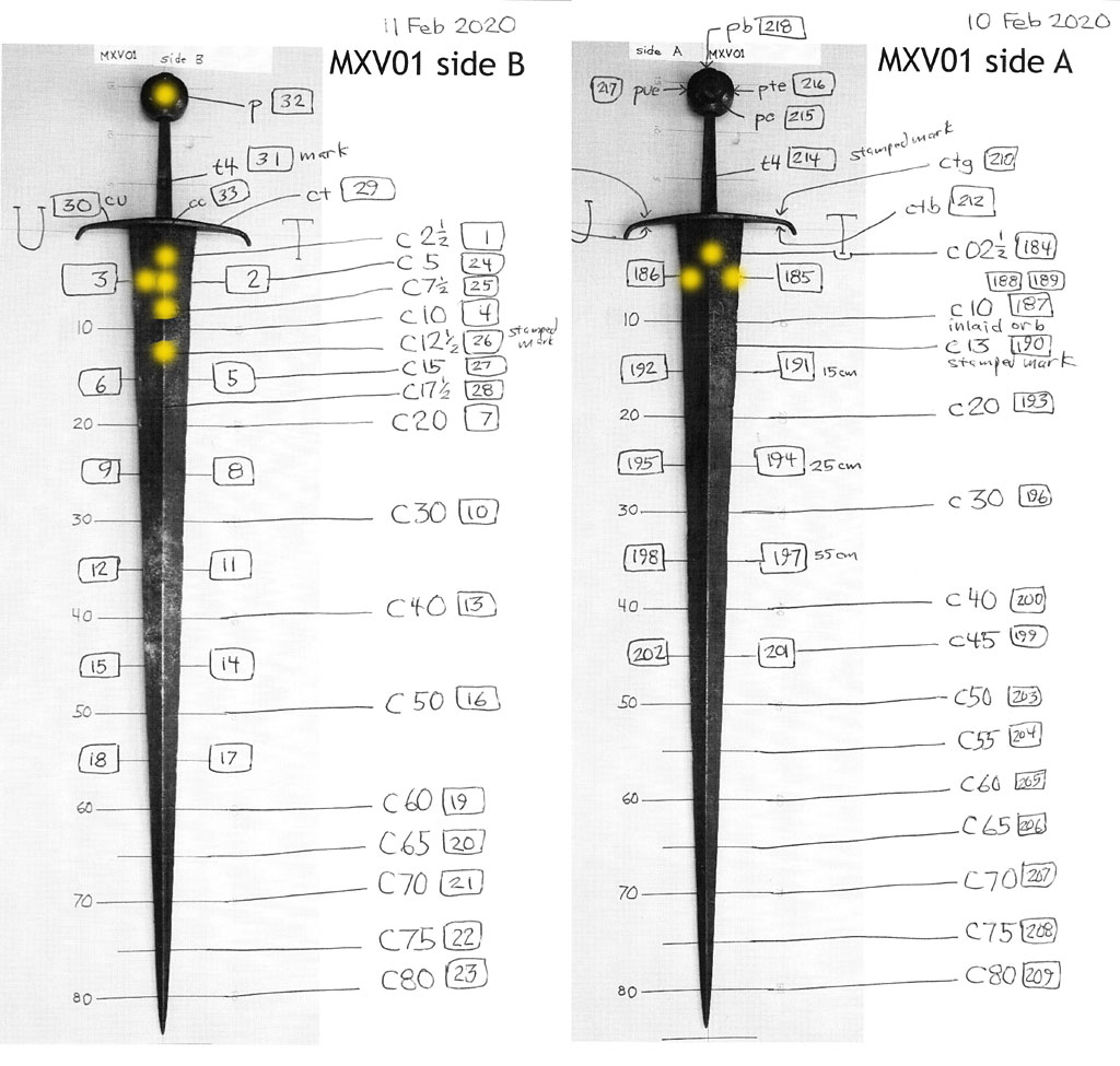

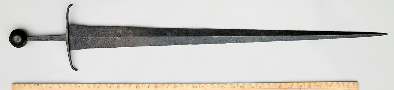

Default Oakeshott type XV - Fourteenth Century
Gilding over the forte and hilt elements is not unexpected in this timeframe. I have had concerns about the authenticity of this sword that I have had over a quarter of a century, so you can imagine how pleasing it was to find a feature invisible to the naked eye that a forger would have had no motive to put there.
The yellow-orange marks on the orientation sheet denote areas where gold was detected.

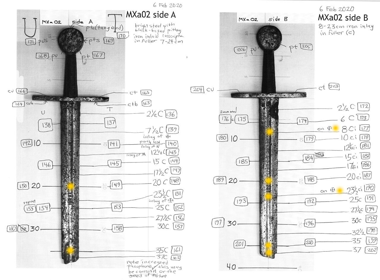

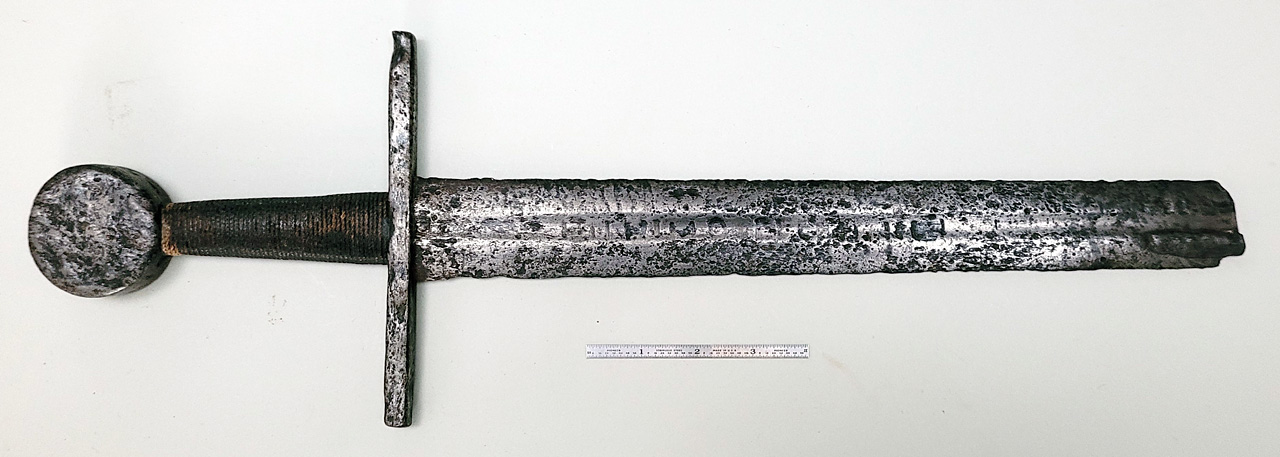

Default Oakeshott type Xa - Eleventh Century - +INNOMINEDOMINI+
Swords from this era are generally regarded to have been austere plain steel and are rarely encountered in other than excavated condition.

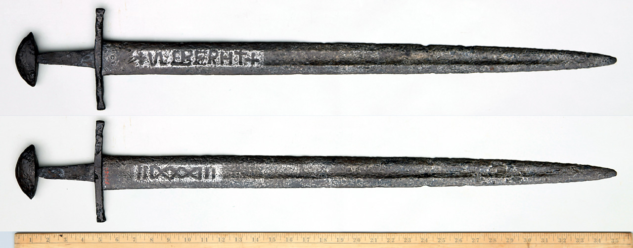

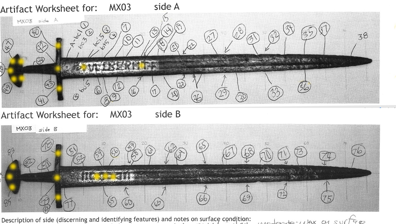

Default Oakeshott type X - Tenth to Eleventh Century - +ULFBERHT+
In this timeframe very attractive overlay work in silver, copper and rarely gold may be found on hilts particularly from Viking infested lands. The brazil nut pommel suggests a more southerly origin for this example and would not be expected to feature such decoration.

Thank you Gentlemen!
The numbers on the 'maps' are the points where a reading was taken. I was using an Olympus Vanta handheld XRF device, so the 'points' measured are of about a quarter of an inch in diameter or so. This instrument will download a file of the device's interpretation that may be imported into a spreadsheet for manipulation (as well as the raw spectra data, should one have the skill to interpret that) and I can then note functional location and features and sort the array of readings by that, as the numbers label the lines in the spreadsheet.
It gets overwhelming quickly and the interpretations presented in this thread are merely "was gold detected - yes (a gold dot on the spot) or no. As I prepared this reply I returned to the spreadsheet to get the composition of the latten (medieval brass) of the inlay and then I noted that lead accompanied the gold where it was found. (Fortunately, the Internet led me to an academic paper explaining how this could improve adhesion of the gilding.) By the way, should you be curious, the latten was 65% copper, 34% zinc and 1% lead, rounding to the nearest percent. I will explain more about my methodology when I present my upcoming thread on elements associated with iron inlays and pattern-welding.
My concerns for authenticity arose from 1) I bought this sword in the late 1980s at a gun show in the US admittedly from a British dealer that I had dealt with previously and 2) a few bladesmiths of my acquaintance had expressed concern about what they felt was a lack of robustness of the tang.

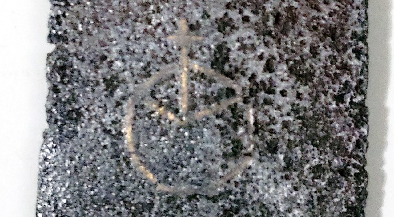

That crowned orb is very similar to those found on German export blades, but I don't know by how much this predates the C16th and C17th.
Triarii is offline   Reply With Quote
