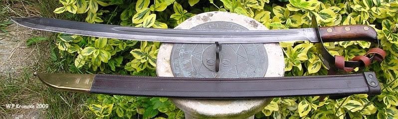

mY Favourite 'cutlass' is the Dutch klewang, used originally to arm native police in Dutch East Indies for jungle use where European swords/sabres were too long.
It was used extensively in WW2 as a 'Naval Cutlass' by the Germans, and the Americans, copied directly and exactly from the original Dutch Hembrug made ones. Mine has a Solingen blade and was supposedly liberated from a German S-Boot by a Brit in an E-Boat. They have clip point too!
Even the Japanese used captured ones, guards cut down and blades shortened, known now as Hei-ho.
The last recorded use of the US Naval boarding cutlass was during the Altmark Incident on February 16, 1940

Yes! There's the clip point so popular on these cutlass types. Indeed, the Dutch klewang, modeled after it's Indonesian namesake, is a perfect example of how both Eastern and Asian patterns had an effect on European/American edged weapons. Nice sword, my friend!
