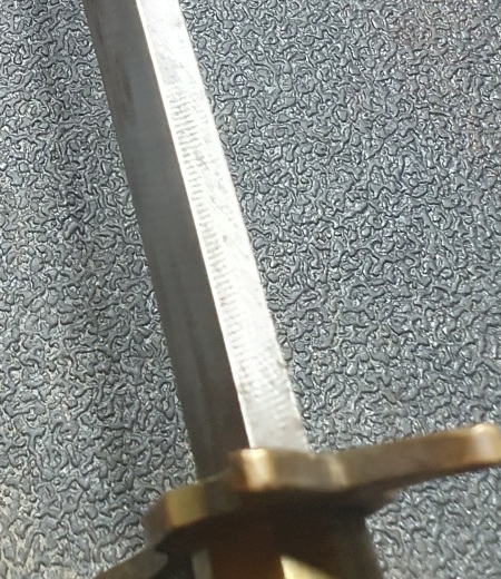

Nice Luzon knife from late 19th C would be my guess. It is what I would call a "double-clipped" blade. If you look at the spine of this knife, there is an angle to the tip preceded by a concave area along the spine, then straight to the guard. this feature is seen on some Ilokano knives and also on some from Pampanga. The quality of finish on this one leads me towards Ilokano manufacture of the late 19th C. The scabbard looks more Pampangan, however, and the tassel on the tip of the scabbard is a known feature on some sheaths from that province.

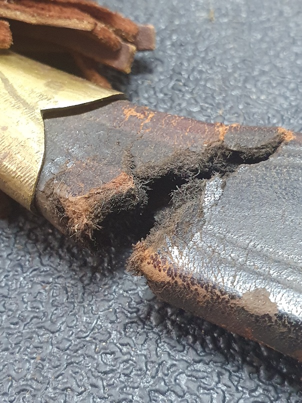

Thank you, very helpful. Noted on terminology. I think the spine pattern may indicate this was made from a rather large file. Any suggestions on how to go about repairing the torn scabbard toe?

That scabbard looks pretty far gone at the toe. Apart from a larger metal chape, I'm not sure what else you can do. I did, however, find a picture of San Bartolome de Malabon wielding his big knife (called a tabak by some locals).

I guess you can glue inside where the gap is, an sleeve from leather that you glue with wheat starch, you need to make the new leather a bit thinner and slide it inside, it might be handy to have a piece of wood modelled after the sheath inside so you can use a folding bone to press the old and the new leather together against the wood and then let it dry. After gluing i would use a special leather reviver, from a restorationmaterials supplier for book restoration.
Good luck with it.
