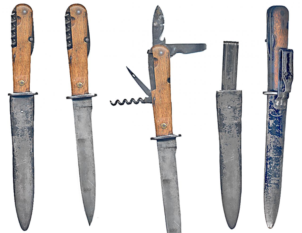

On a similar note, I recently sold a WW2 German SAK handled trench knife (see pic) that featured a canvas and leather stitching tool which I found curious as I've not seen examples of soldiers repairing such materials, but then I've led a sheltered life.
The other feature was a cork screw: convivial imbibing round the night fire perhaps.

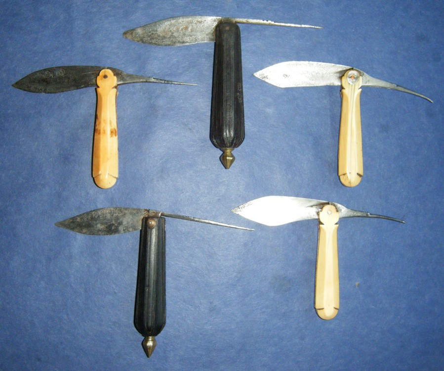

Old 8th May 2024, 08:42 PM   #23
Attached is the 'pre Civil war' sailors knife from Walt Hallstein collection that was auctioned some time ago. It was noted as having blacksmith forged iron parts.
Hi Jim,
The knife you showed is also a lontar scribe's knife.
Attached a pic of my small collection of these knives.
Never believe descriptions auction houses provide!
Old 8th May 2024, 10:37 PM   #24
Posts: 10,870
well spoken Detlef!
Thank you for showing these. What exactly is a lontar scribe? I know that scribes using these stylus' were widely spread throughout SE Asia, but am not familiar with the many ethnic groups.
The one shown in the OP, with fluted grip, can you say more on the style. While it reminds me of neoclassic European style, you would be more familiar with the period and perhaps regional classification of this particular style.
Do you think it is feasible that sailors might have obtained these as earlier suggested and used them as awls?
The OP example seems c. 1790s by the pitted blades IMO, and the general feel of it when handled.
Old 9th May 2024, 12:06 AM   #25
well spoken Detlef!
Hi Jim,
Lontar is a palm. The lontar palm leaves are used to write on them, the scribes write or better scribe the text with the needle and rub a plant ash inside.The term I used was "lontar scribe's knife". But hit me, I can't tell from my memories of how the knife was used but when my old brain works well to cut the leaves. All the knives here shown (not only mine) come from India, maybe Sri Lanka, so far I know.
When you look close, you will see that my black wood ones are fluted as well. I guess for better grip!?
And yes, I guess that they can be fairly old. I know not too much about them, I assembled them when I saw them and when they were not too expensive.
