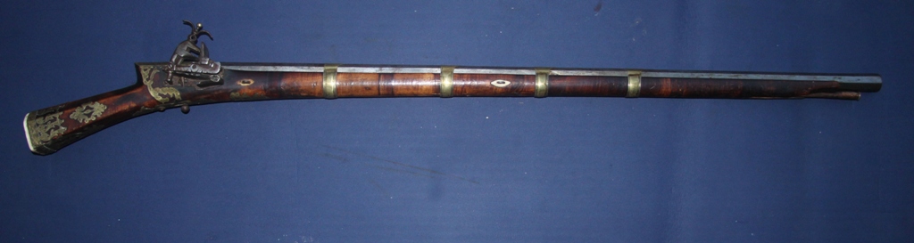

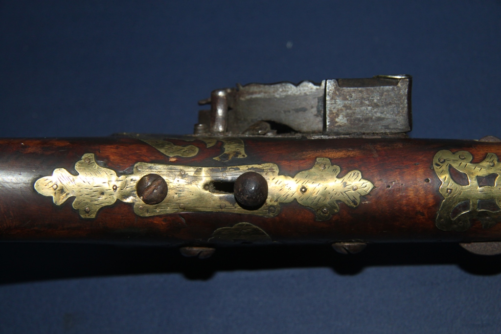

Hi everybody
Who can tell me more about this miquelet gun from my collection
Any comment and information about this miquelet gun will be welcome.
Cerjak

now this is a wonderful preserved shishana tufek(or "tufenk") made for the ottoman market , (according to Robert Elgood made in Boka Kotorska) , a janissary weapon that surely saw action during the 18 th century austro ottoman wars (or elsewhere) The small stock reveals older age- surely 18 th century.As I said about your other rifle, (the percussion jezail, in the oriental forum) we have in our museum in Timisoara a number of oriental and balkan muskets,and the shishana longguns have all kind of barrels.Some bosnian, copies after brescian originals, some oriental like your jazail and other brescian originals. I hope yours to be a Lazarino Cominazzo.
The word shishana indicates a long gun with a hexagonal wooden butt and a heavy barrel, a stock form used by the janissary and the seymeni. In my region of the balkans this musket remained in use by the haidouks till mid-19 th century. Shishanas are also referred as tokmakli sisana-(tokmak-"large piece of wood").Your gun seem made from the wood named "sarma agagdzi"in ottoman turkish, a timber from moldavia -a fine stripped wood.
as i said, my opinion is that you have a great military "cakmakli tufek " the beloved weapon of an unknown janissary of Deli Orman.

Thank you ,I was not expect so much informations about this gun and realy happy to discover that this militaryTufek was from the 18 th, so much older that what I was thinking.
There is few books in French langage about Otoman gun and not so much people interested in this type of weapon in France so very nice to have your help.
