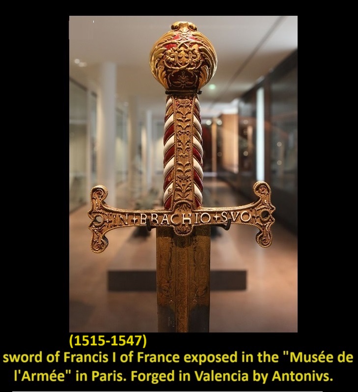

Rather than non Toledan sword smiths from the period you are looking for, i would indicate Valencian masters who were active prior to that date. Perhaps not useful for your present project but maybe for your future works.
"c.1541. Sword of Francisco Pizarro, made in Valencia by the armourer Mateo Duarte"
"sword of Francis I of France exposed in the "Musée de l'Armée" in Paris. Forged in Valencia by Antonivs ".

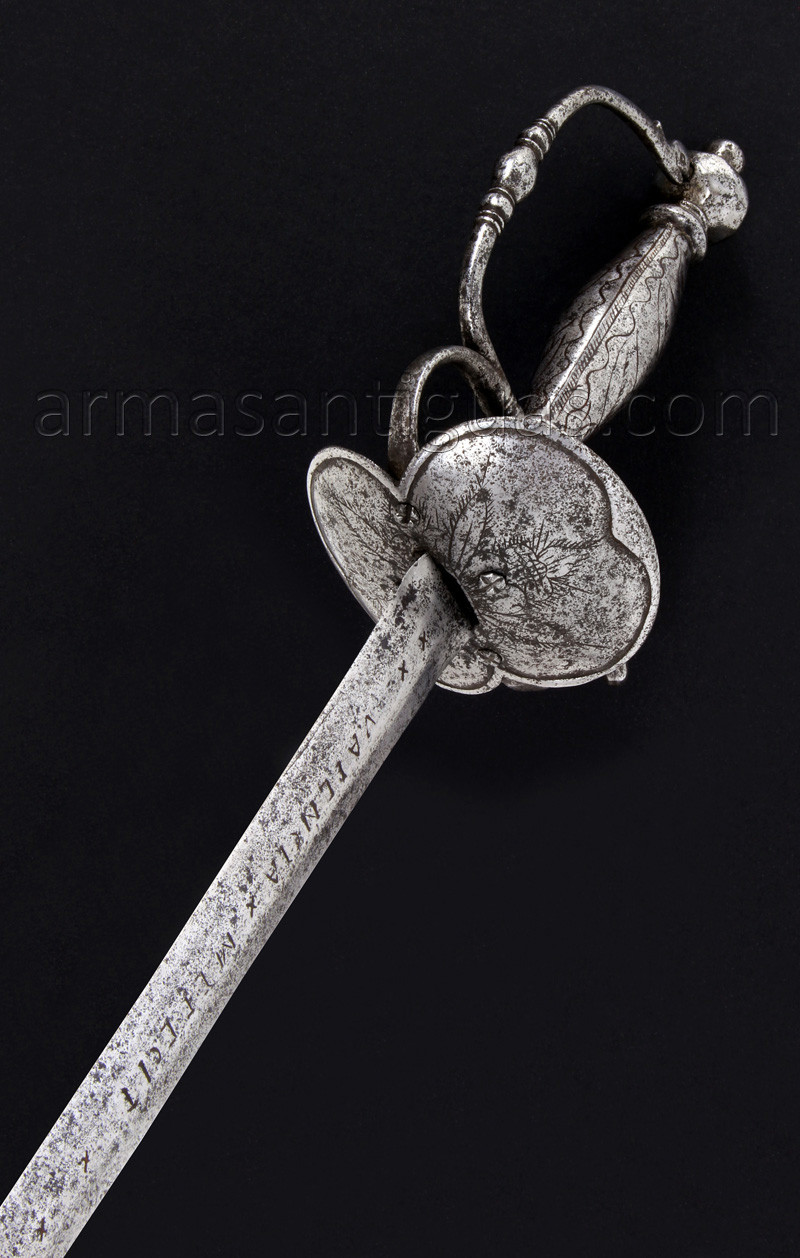

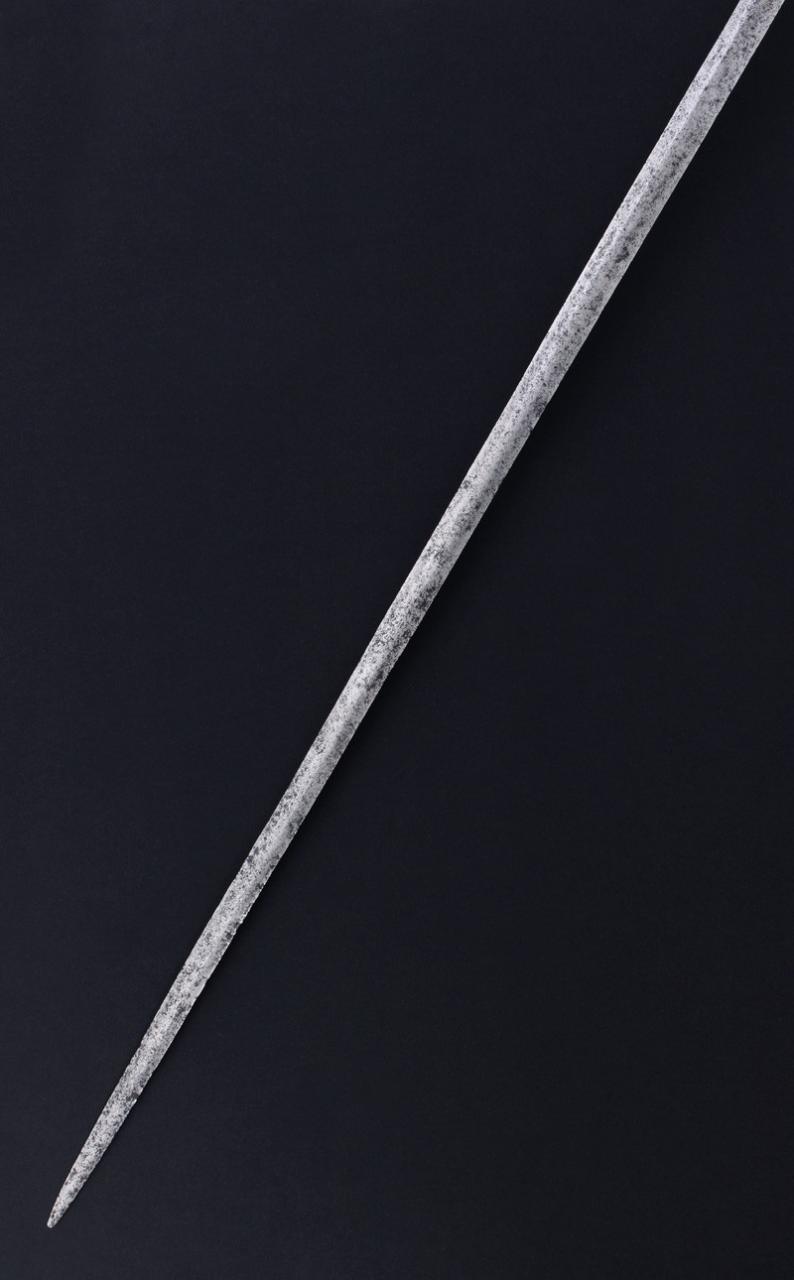

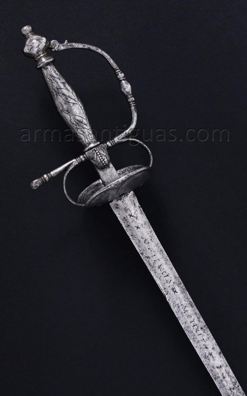

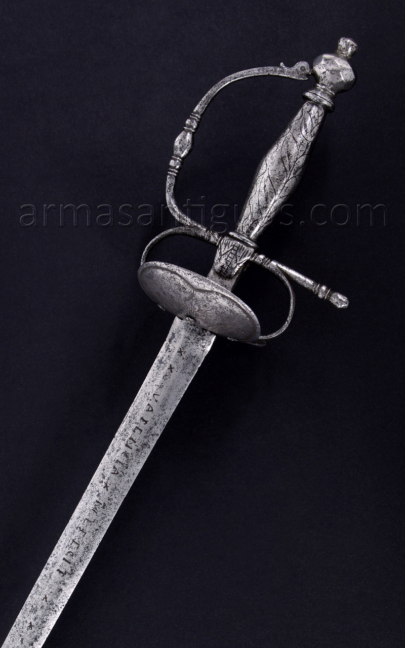

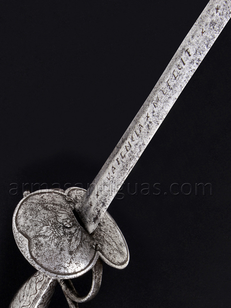

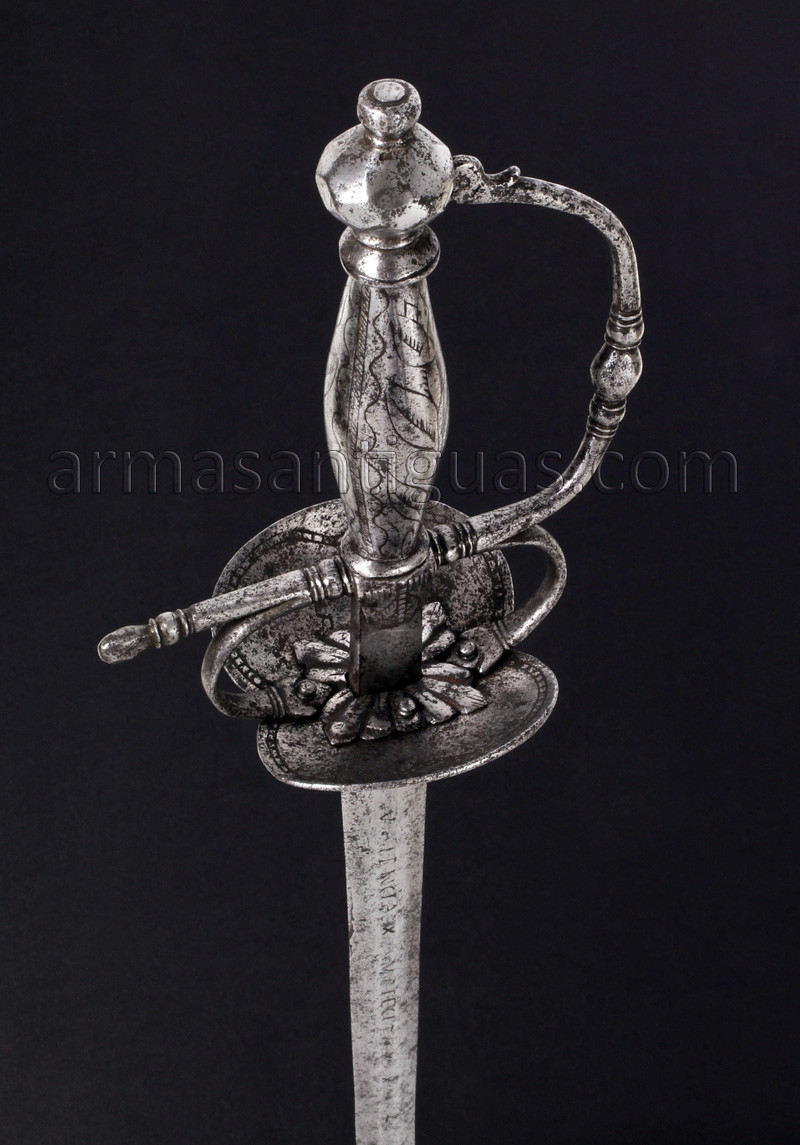

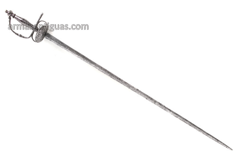

This is a smallsword from Valencia.
Dish attachment through 4 screws in a lozenge, as some 1728 cavalry swords.
