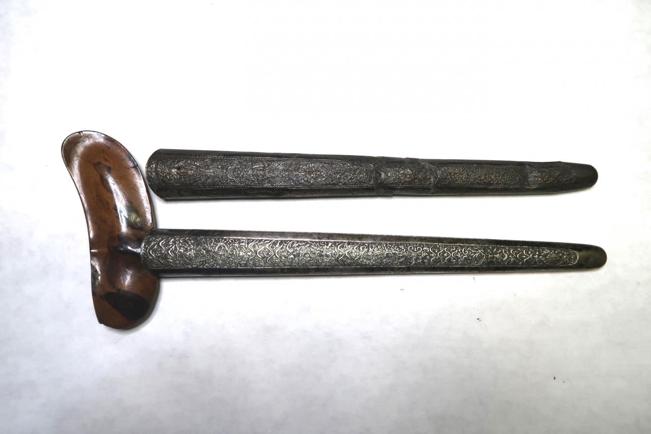

I post some pics of the Javanese Keris. I think underneath the varnish is a nice pamor as you can see in the picture.

The foot of the atasan is the part of the atasan that projects below the body and accepts the tongues of the gandar, not all wrongkos have this foot.
The damage to the gandar is not at all unusual in Javanese wrongkos, a normal fix is as you described, just some newspaper or a couple of pieces of light cardboard fixed in place. Yes, a new gandar would be a distinct improvement, we use a tool called a segrek to hollow out the inside of the gandar. If we make it without a joint, the easy way to make one is from two pieces of wood, it should be a soft wood.
This appears to be a pretty fair sort of a blade, it will restore well, in my opinion it is definitely pre-WWII, probably second half 19th century.
This entire keris has the potential to be restored into a very nice keris.

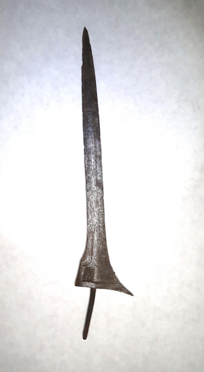

Default Cleaned
Hi all,

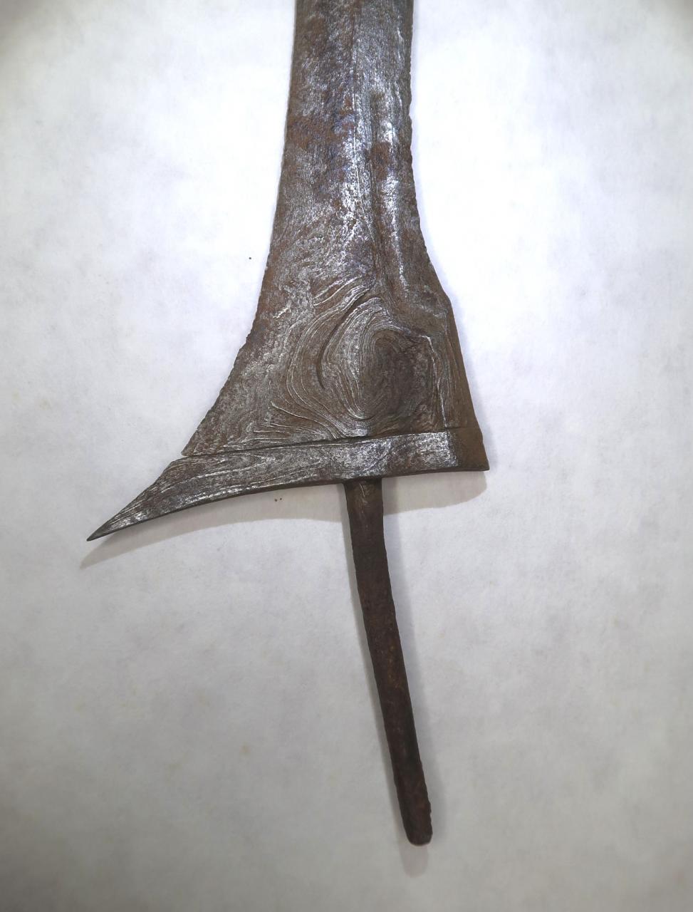

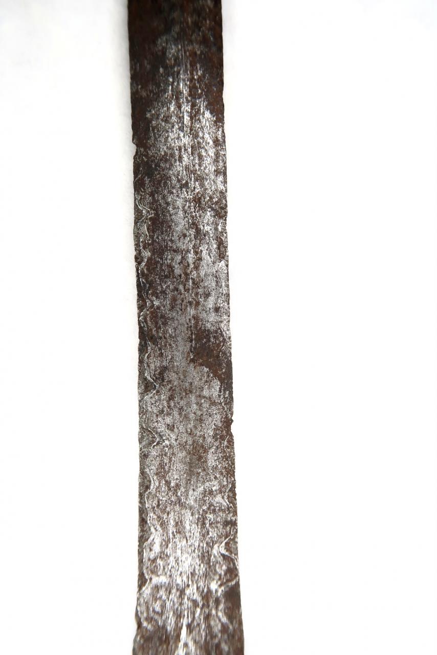

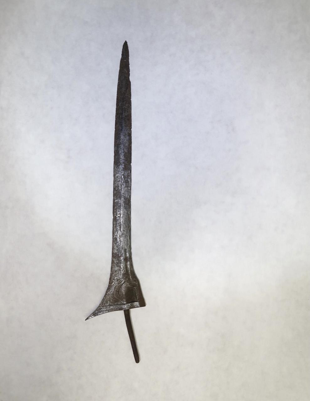

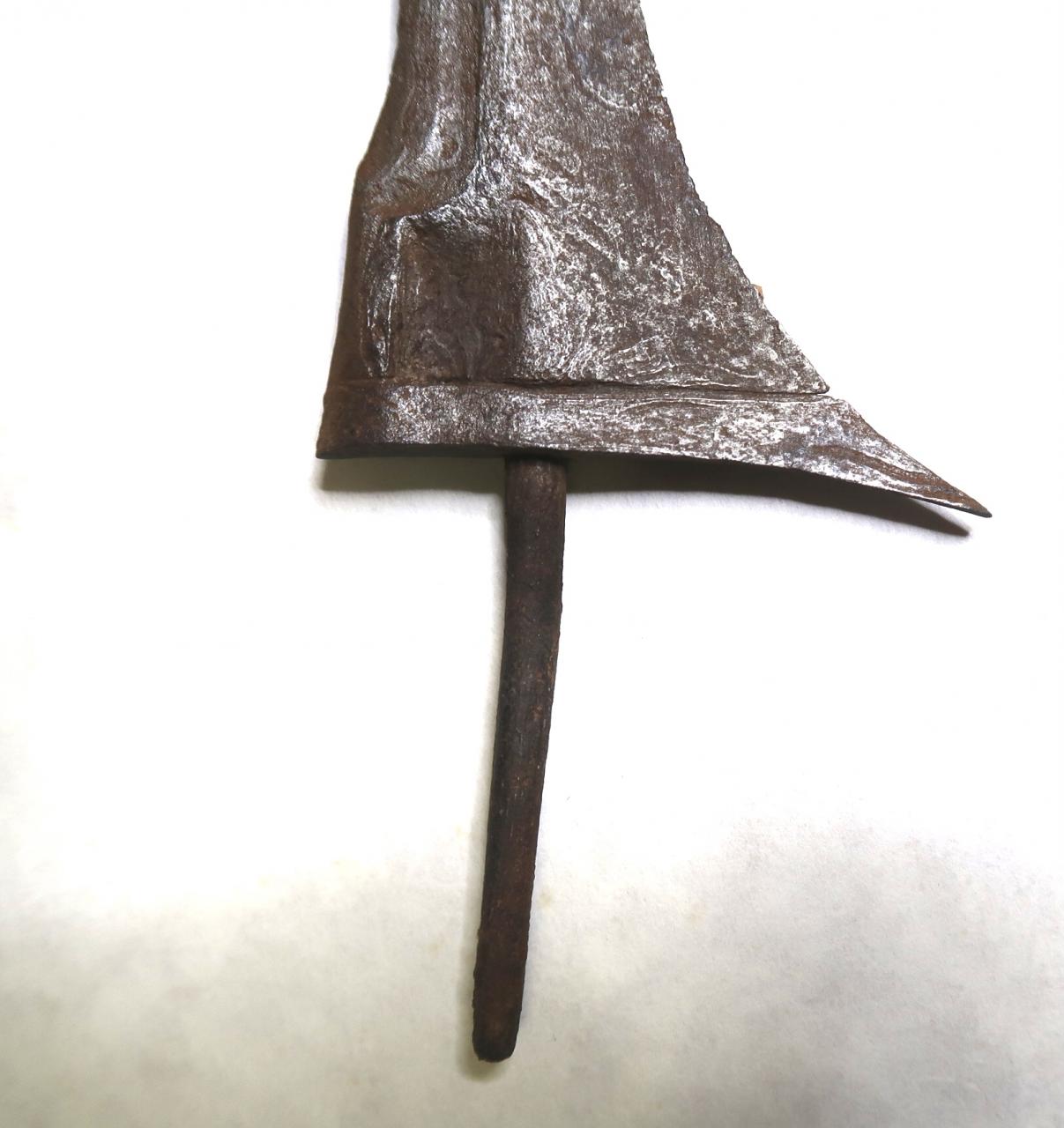

I cleaned my Keris from the dammar varnish today and this is how it looks now I took some images from the wilah. I also had in my spare parts a nice old silvered pendok for it.
The pamor is it Batu lupak or is it pamor kul buntet? I am trying to identify it but it’s difficult for me.
Hope some of the experts can tell me more.
Regards, Martin.
Pendita65 is offline   Reply With Quote

I believe most people would classify the pamor in the sorsoran as Kul Buntet.

Question
It doesn't look inserted to me, Alan.
To me, this motif at the base seems to be a part of the overall pamor (with much of it now lost to erosion).

The photo’s after taking off the dammar varnish

I tend to disagree Kai, erosion and the necessary coldwork has taken a part of the swirl, I feel that this swirl might be continued into the pesi, & and if that is so, then that pesi will have been attached to the blade after the body of the blade had been forged, however, this is just a possibility being floated, because we cannot know that without seeing the pesi, especially under the gonjo.
In any case, whether the kul buntet was inserted as a swirl, or whether the maker was sufficiently skilled to create a swirl in one part of a larger motif, the end result is still the same:- kul buntet.
If it is a part of a larger motif, is that larger motif mlumah or miring?
Incidentally, on the subject of "insertion" of a pamor feature, in some cases we can form a hole, or even an impression in the material, & then lay the swirl or whatever into it, but it is also sufficient just to lay the additional piece of pamor onto the already forged material, then cover it with another piece of material that gets removed during the cold work.

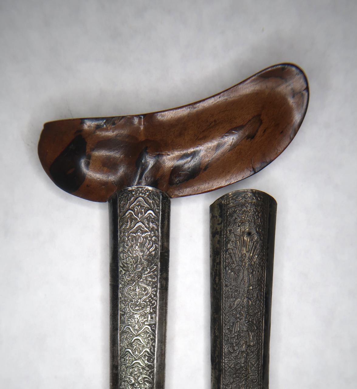

Detail of the pendok as replacement.

The replacement pendok looks good Martin, though i do believe with just a little bit of effort you could restore the original one to a fairly decent condition.

Thanks David, and yes i will see if i can get the old one in a more acceptable state. The blade is cleaned from rust and i think it's ready for a warangan treatment. This hobby is also addictive, could not resist to buy some Keris today and a nice rencong in need of some tlc.
