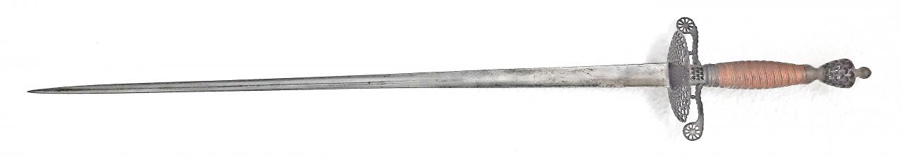

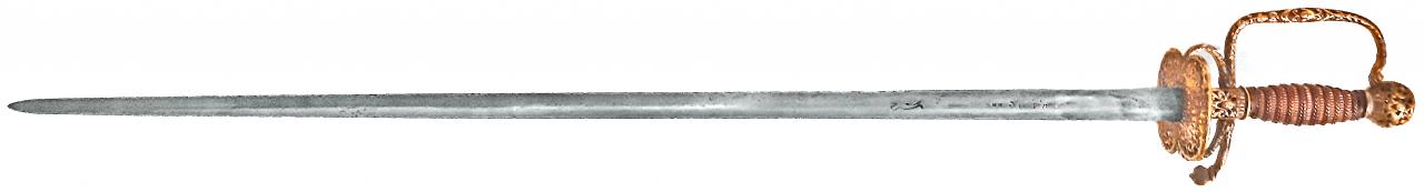

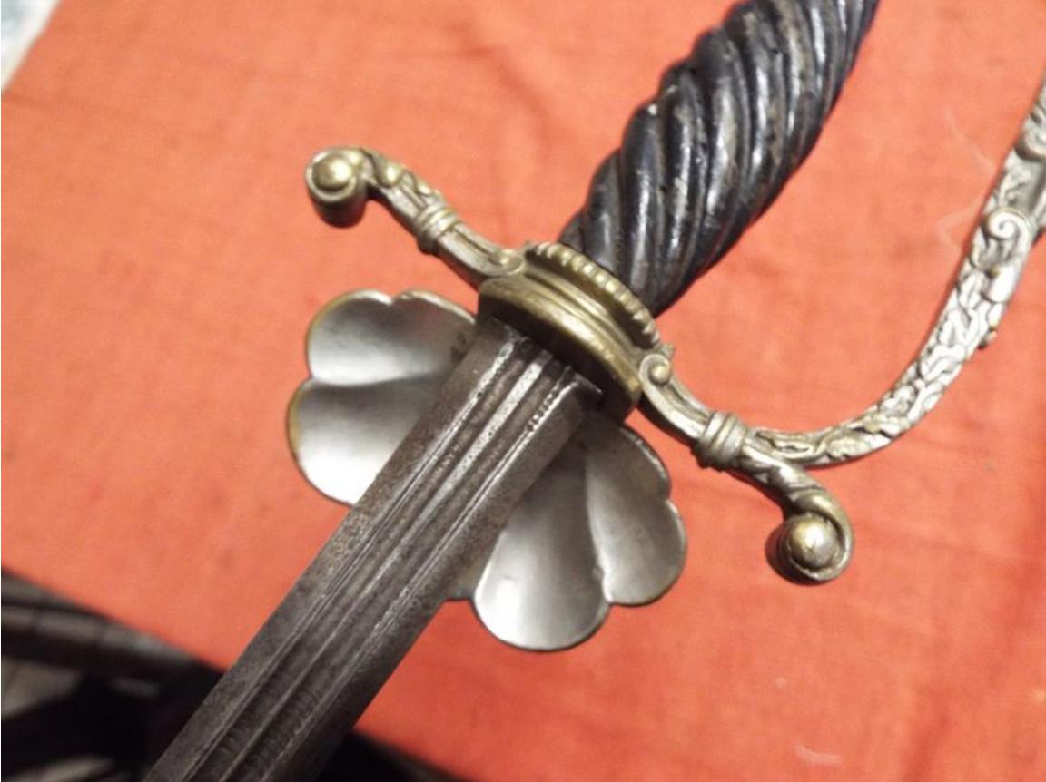

Hi Folks.
Without wishing to put up fences, I suspect Fernando will be able to advise me on this issue, but of course I welcome all input.

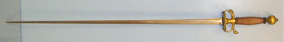

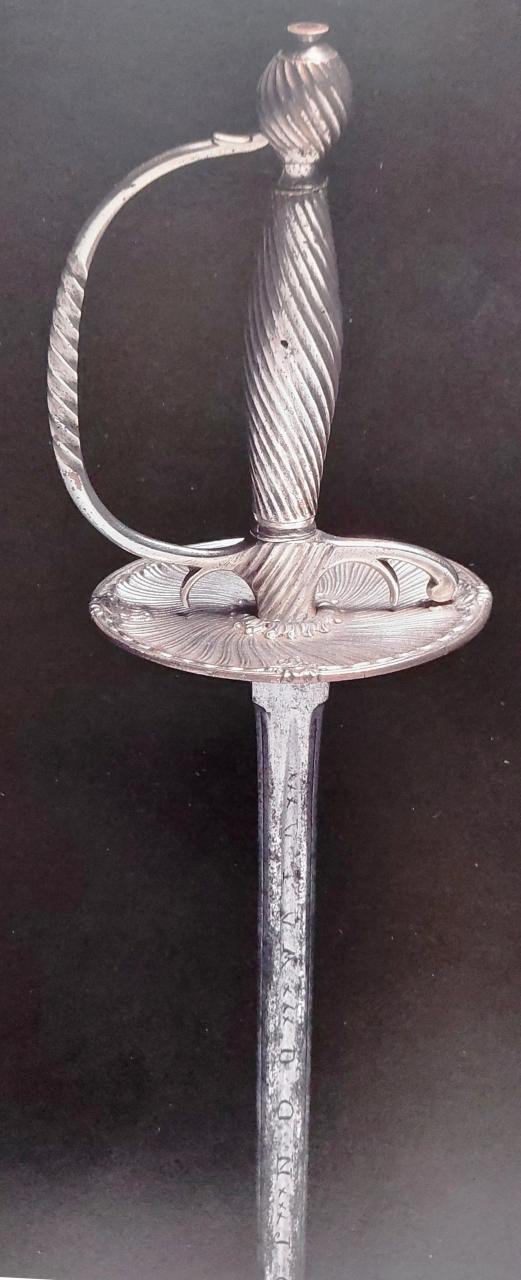

I have two Court swords with rapier blades that are certainly re-hilts.
The blades are very thin... delicate almost; great stabbing tools.
I've posted images of the silver hilted one before - but for other reasons.
My question is this:
what is the history of these very fine, slender blades and what sort of hilts would they have had originally?

What makes you suspect that these are re-hilted rapier blades?
Your first one retains the shoulders of the blade, so if it was originally a rapier it would have need to have lost a good portion of it’s tip. Is the blade unusually thick at the tip? If not, it will be a purpose built smallsword blade since the effort in re-profiling a blade from the base will be more work than making a new one.
As an aside, I’m always cautious when mixing Rapier and Smallsword (like so called transitional rapiers). Because rapiers command a premium over smallswords, I find some dealers are quick to find links between the two to add value.
I appreciate that transitional rapiers are a thing, they’re just not as common as some make out to be in my view.

Thank-you Gentleman.
This may well explain why I am puzzled.

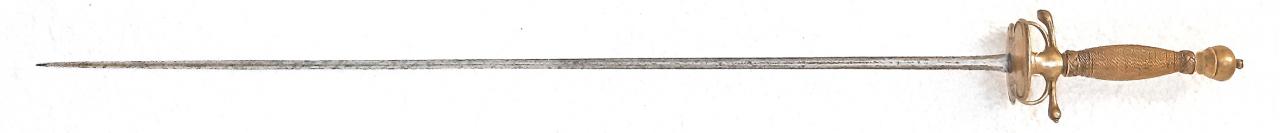

The reason I considered re-hilts was because of the length of the brass hilted version which has a 40" blade; obviously well beyond the common smallsword parameters.
The silver hilt, however, is 31" and as such is within said parameters but has an identical blade profile to the 40" one, so I assumed there was a category of sword of which I was unfamiliar.
Again, however... that brass hilt is actually very, very big, so it may well have been commissioned for a big fellow wanting a proportionate length to his weapon.
The other reason was the dating issue:
they are very late 1700s hilts are they not? If so, I was puzzled as to why they were fitted to blade styles I thought (and here you must pardon my inexperience and ignorance) had long since gone out of fashion after the arrival of the 'hollow' blades.
I look forward to corrections and augments.

Going by their style, I would agree that both these hilts are very late 18th Cent. or early 19th Cent. The brass one with the turned over guard especially, since by this stage the sword was worn almost entirely for dress or ceremonial reasons. That the blade is 40” is an outlier and I agree that it makes it much more likely to be a re-hilt with an earlier blade. Especially on a sword only worn for dress.
You’d need to examine the blade profile and taper to determine if it was cut down though.
Something to keep in mind, the style of smallsword fighting in the Iberian and Mediterranean region was different from that taught in France. This style retained some cuts and they used longer blades meaning they still ‘fingered the guard’ to retain point control. But 40” is long; by comparison, my largest smallsword is Spanish, and it has a 88cm blade with another 3cm between the guard and and the quillons.
To your other comment, while the trefoil blade was the most popular form for smallswords in Northern Europe and the UK, other profiles persisted and didn’t completely disappear.

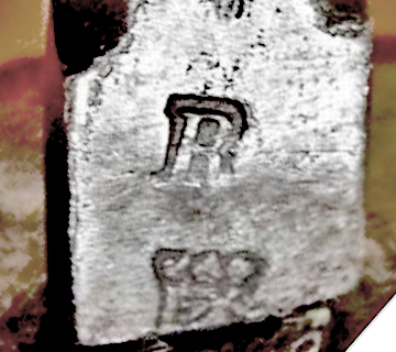

The ricasso on the silver hilt sword shows the maker mark in the squared ricasso cut in half (see attached).
The 40" one doesn't and the blade disappears into the hilt (again, see attached).
I find it hard to imagine that either sword has not been modified or chopped down at their ricassos.
There is definitely no indication of blade thinning on either sword.

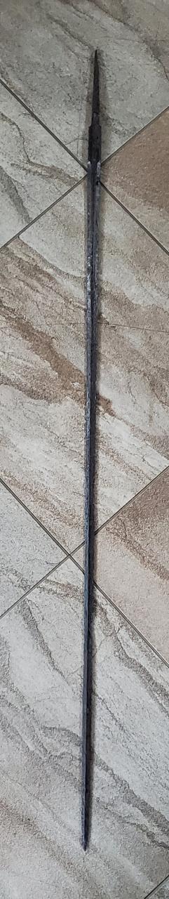

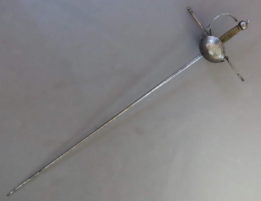

These thin rapier blades were of course prevalent through the 17th century into the 18th. While they seem to have been contemporary to heavier arming blades through the 17th, the rapier and dueling swords were apparently maintained in the court and gentlemans swords. The so called transitional rapiers (a most nebulous area) seem to have been with these slender rapier blades in the small sword and court sword hilts in the 18th.
Attached is a Spanish rapier blade (though probably German made) which is believed from the Spanish nao Encarnacion which sank in storms off Panama Dec.3,1681. It had left Cartagena enroute to Porto Bello Panama, and among cargo had crates of sword blades.
This type of blade was of course known earlier in 17th c. As Toledo was in dire straits in the 17th century, Germany stepped in and produced blades as they were long well established as the key blade producers and continued as such well through the 19th c.

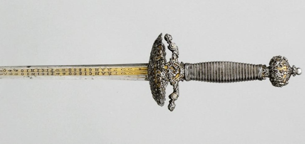

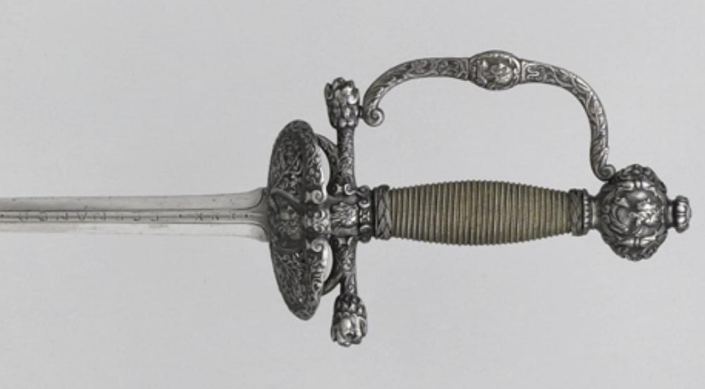

So: I am reminded Jim, of that Dutch duelling rapier/smallsword of the late 1600s... the one you have your eye on (see attached.
I don't know why I didn't hop over to that conclusion.
Here is a virtually identical blade inasmuch as it is thing and sharp and reasonably long.
This must have been before the 'First Blood' rules appeared.
But, I am convinced that brass hilted sword of mine with the 40" blade was longer before it was hilted thusly so my obvious next question is "What sort of hilts did these blades have back closer to the end of the 1600s".
Has anybody seen a long narrow rapier blade hilted as per the end of the 17thC?
It is beginning to appear that the transition to smaller swords began earlier than I had imagined if the English civil war Cavalier rapiers are anything to go by.
Am I missing something here?

It is difficult to take a pragmatic approach in assessing the two sword examples posted as there are so many variables as far as the intent in their present state. It seems pretty clear these are remounted with vintage rapier blades, which was why I posted the rapier blade from a Spanish shipwreck off Panama (1681) illustrating these blade forms, which were in use into 18th c. in some degree.
The Spaniards used a distinct style of fencing known as destreza, which by the 18th century was falling out of favor as the French school began to take over. With this, the style involved both cut and thrust and shorter (faster) blades.
English fencing followed primarily French (and Italian of course which often paralleled).
* the Tim Roth sword in "Rob Roy" was a dish type rapier (c.1640s) as known in England, and would have been quite dated by the period of 'Rob Roy' in the early 18thc. The contest between these dramatically different sword types would be as interesting as portrayed in the film, and the Scots, while relying on brute strength and cutting power were well versed in some fencing skills. There are numerous volumes on Scottish swordsmanship (Hope, McBane, Angelo, Sinclair et al).
The choice of the rapier of the English gentry vs. the Highlander with broadsword was obviously highly symbolic.
It must be remembered that dueling was much contended with concerns over blade lengths and long blades were often deemed illegal in many cases.
The use of the civilian rapier remained in many cases somewhat outdated in observance of tradition and heritage with the exception of course was the small sword and dueling. The Spaniards maintained use of their long outdated cup hilt rapiers for well over a century later and while often derided by other nationality swordsmen, they remained indeed most formidable opponents. As far as later use or contrary to popular present fashion as with Spain,it does not seem unusual that similar situations would follow in the courts and gentry of other nations, including England of course .
The silver hilt rapier (the term is of course loosely used for small swords and any light thrusting blade sword) is of a fashion of c. 1790s (as highly embellished diamente work) with tall urn pommel. The use of a vintage or heirloom rapier blade would be understandable in the status oriented context. It would be interesting to trace the makers mark at ricasso.
The brass hilt with the extraordinarily long 40" blade may have similar circumstance, and is more aligned with the court sword styles popular in Georgian period but recalling the down turned guard on earlier swords such as hirshfangers or cuttoes. Again, it is a matter of personal preference, but for dueling as well as for court wear, such a long blade would be detrimental as awkward.
In all, these are 'rapier' blades of notable vintage mounted in later hilts, as often the case, and reflect the personal preference of those who owned them. They do not reflect any particular classification or period type as personal preferences in blades and hilts dictated many variations in these sword forms which indeed existed contemporarily over long periods. The famed 'colichemarde' blade which focused on dueling remained in favor in the military long after falling out of favor in the civilian sector. Military heritage and tradition often is a factor which brings these kinds of anomalies into being it would seem.

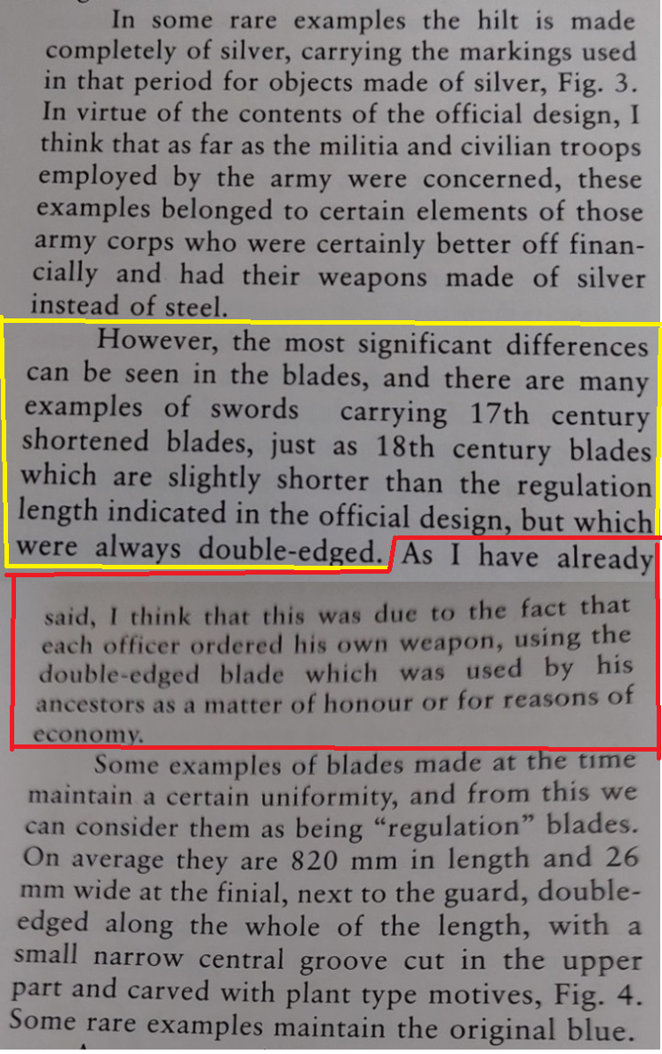

Gentlemen... thank-you, this has been a most enlightening endeavour.
I found my final answer on a dealer's website and I enclose it below.
These slim blade rapiers had the same hilts as 'Military' rapiers. Almost certainly as equally varied.
Have a fine weekend. I'm off to play with latest acquisition (a huge early Sterling on an equally huge Shotley Bridge broadsword blade).

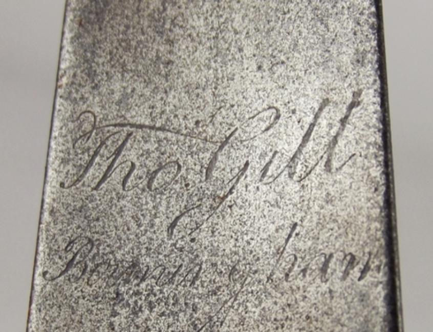

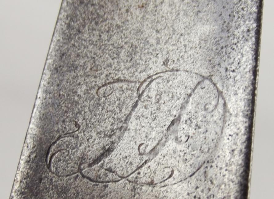

I have a Gill-made 'short' smallsword, custom made for a naval officer that has been unique in my experience so far. Now I have sight of another. My blade is only 27" long yet the hilt is enormous. I had always presumed the short blade was a naval preference and now I have additional support for my presumption.
I also have sight of the use of an heirloom rapier blade in a smallsword.
Thanks again.

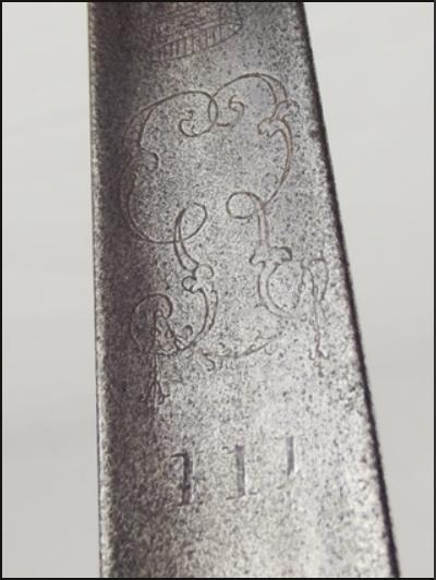

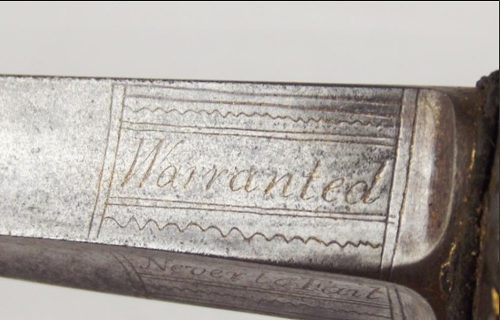

Old 21st September 2023, 10:44 AM   #19

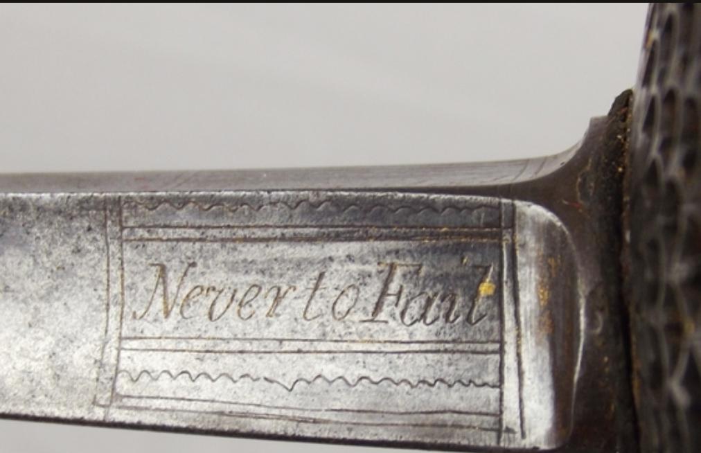

Say Keith, what do you think (or know) is the word/s in the blade spine, after "warranted"; not the usual "never to fail" ...
Old 21st September 2023, 10:57 AM   #20
urbanspaceman
Join Date: Sep 2017
Posts: 736

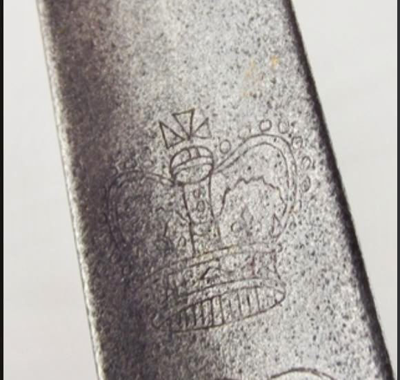

Default Gill
Hello Fernando.
It is a very unusual sword in more ways than one - to coin a saying from our vernacular.
I am enclosing a variety of pics of the sword.
The hilt is almost certainly from Matthew Boulton and is a work of art but much too fancy to suit active combat,
It also features a groove in the lower face of the blade which tells of a tale too lengthy for this thread.

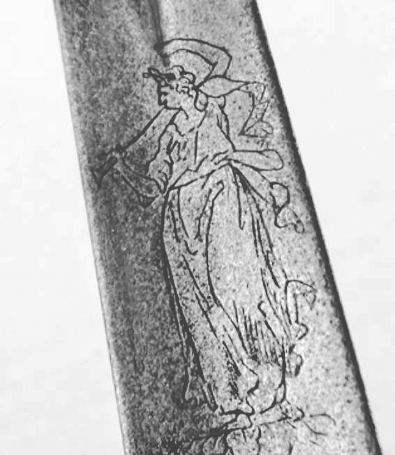

Old 21st September 2023, 08:18 PM   #21
urbanspaceman
Join Date: Sep 2017
Posts: 736
Default ps

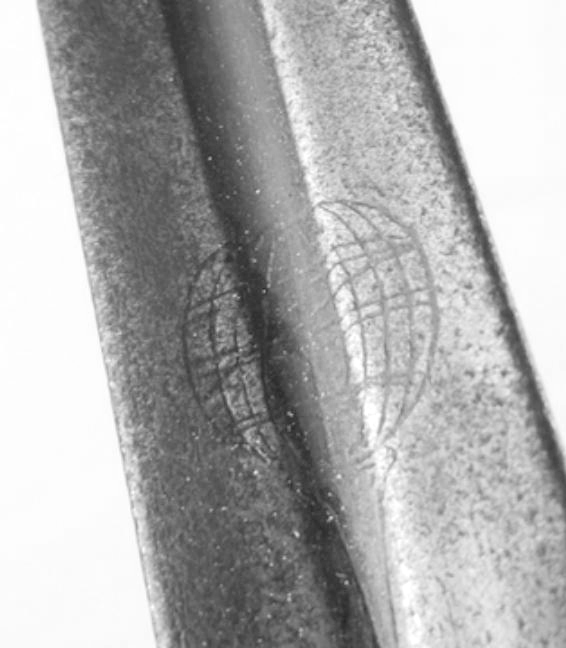

here's the last picture: this globe is at the top of a trumpet? in the figure's left hand;
apparently this figure is of some significance; anyone know what it represents? It's too early for Britannia Rules the Waves (1745).
Old 21st September 2023, 09:53 PM   #22
Radboud
Join Date: Sep 2021
Location: New Zealand
Posts: 303
Why do you say it's too early if 'Rule Britannia' is from 1740? Thomas Gill Snr was born around 1743 and died in 1801. He is first listed as a file cutter and maker of watchmaker tools in 1767. It isn't until 1788 that we have a listing of him as a sword maker (along with other things).
On the balance of the evidence it's reasonable to believe that Thomas Gill didn't start making swords until the mid-1780s, meaning the figure could well be an early representation of Britannia.

We have strayed from the original topic somewhat, but I'm still learning as we go.
ps
There were at least three Thomas Gills, the first died soon after arriving from Lancashire and setting up a file shop for watchmakers.
