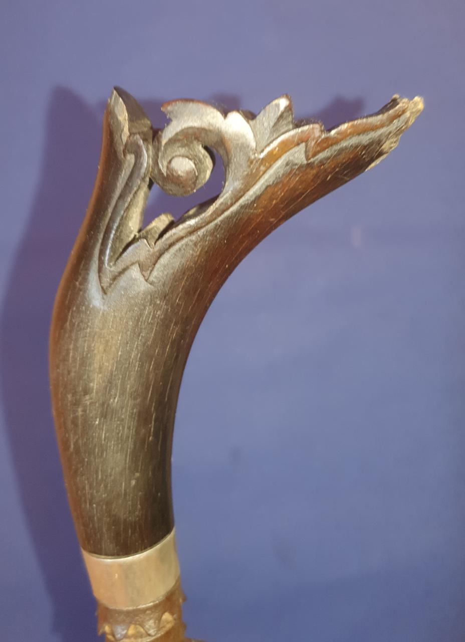

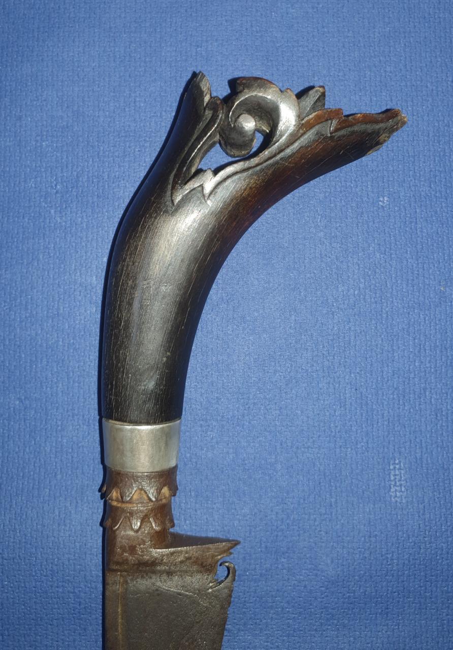

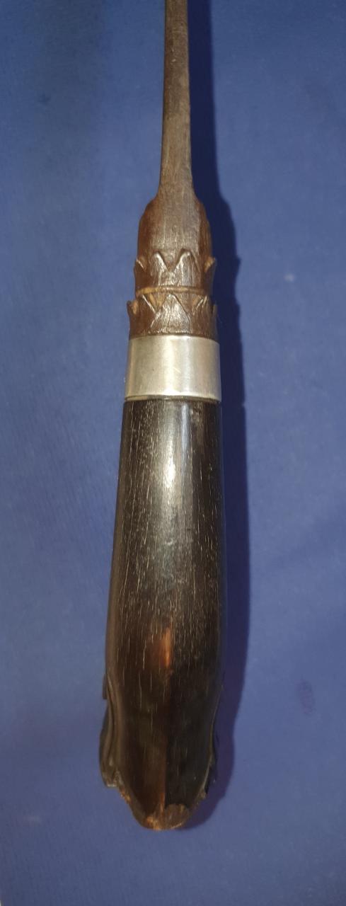

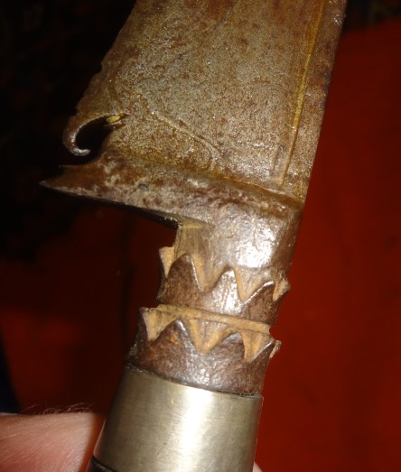

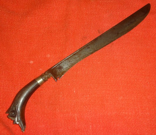

I've won a German online auction for this very unusual knife. For the moment I can only post two poor pictures from the seller. Kembang kacang, double crown at the bolster, laminated blade. Handle is from horn and shows maybe the mystical swan hongsa/hamsa. Any comments and ideas? The knife is 48 cm long.

Interesting piece!
I believe it is from Mid or West-Sumatra, probably the Aceh area due to the decoration on the bolster and steep angle similar seen on rencong and other swords and daggers from that region.
The hilt carving seems to show some Batak influence perhaps?
Best! Peter

Hi Peter,
Thanks for your comment. I doubt the Sumatra origin a bit. I don't recall ever seeing a kembang kacang on a Sumatran knife, nor does the thick spine of the blade. Also, I have never seen such a handle on a Sumatra knife. I suspect an origin from the area of ​​today's border region between Malaysia and Thailand. But of course I could be completely wrong. As I said, the handle reminds me of the mythical hongsa swan, see picture.

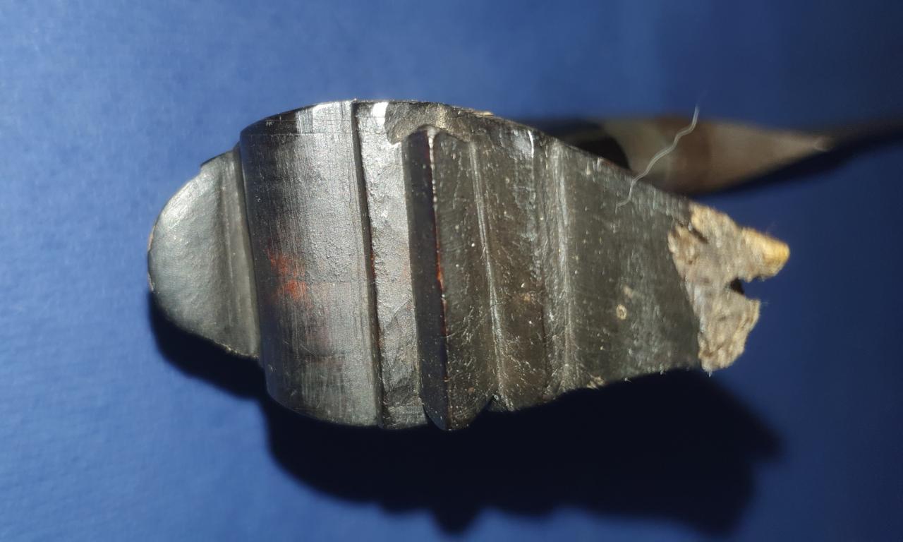

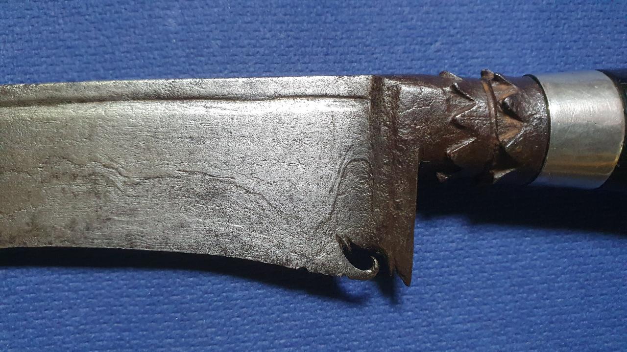

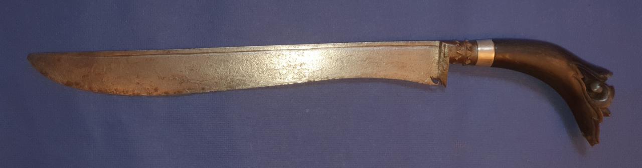

Finally I have received it and maybe I have to revise my mind of the origin and have to agree with Peter.
Have cleaned the blade on one side, here are some first pictures. There are some chips at the handle the seller don't mentioned, on the other hand, it was not apparent from the seller's pictures that the handle is open worked.

I am afraid i have the same questions as Alan, Detlef. Neither of the two other knives with a similar hilt resemble this blade. I am afraid i would need to see some further evidence of a Thai knife with provenance that displays these same features before i would be able to accept it as originating in that area. I still think the blade has more in common with Aceh blades than anywhere else.
