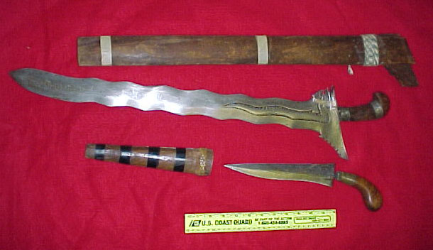

Blu, I'm posting here not to hijack but as a question related to the pix of your kris posted in this thread. I notice that the blade of yours, shown in your excellent picture gallery, appears to be all one-piece.
A comment Nechesh(?) made about mine had to do with one-piece vs. having a separage "gangya" which term I did not understand. Another post seemed to clear it up with a pic of a kris blade with a separate "top piece" close to the handle which appears to be welded or sweated on. I guess this is the gangya?
Anyway, your captured kris, which appears to be pretty well documented (at least I have no doubts about it) seems to have an all-one-piece blade as well, and yours was captured in 1908.
Can I get a clarification from someone on the significance of the separate vs. one-piece blade issue? Where the issue seems to have been left, as I recall, on the other thread, was that a one-piece blade indicates post-1930 manufacture. But your pre-1909 one-piece blade seems inconsistent with that demarcation, so what's the real answer here?
Sorry for my ignorance of Southeast Asian edged-weapon terminology.

Well, this really may be a point of contention. The 1930 line is one drawn by Cato in his book Moro Sword, for bettter or for worse the only specific book on the subject to date. I believe we have seen exceptions to this rule and i believe we even had a recent thread on it showing some documented examples. I took a close look at Blu's kris and really can't tell from his photo whether or not a seperate gangya exists (this is the same piece that is usually called the gonjo or ganja in Indonesian keris). I have an example that is so well fitted that i didn't see the seperation line for years until i gave the blade a cleaning and etching. Even so you need to magnify the area to see it. It can be like that on really well made blades. So, it hard to tell if Blu's is seperate and that is why i asked about yours. Another method used to determine age is the shape of the luks (blade curves) which tend to get pointier as the blades get more modern. Yours appear a bit pointy (not very) in the photos you presented (compare with Blu's) so i would imagine that yours is a later variety. Others who make the Moro kris their main point of study may know better as to when and to what degree of pointiness the luks are in different periods. I have seen very pointy luks on very modern versions. Also materials can be a clue to age. That is why i asked you in the other thread if the bands on the sheath were aluminium. That generally points to around or post WW2. Of course they could also have been added at a later date. Hope that helps.

I believe your kris to be fairly recent ; say less than 80 tears old ; that's just my opinion though . There is a lot of good workmanship in your blade and I wonder if it wasn't meant for local use rather than for sale to foreigners .
One thing I find interesting is the top of the gangya area on your blade ; it looks like a relatively straight line whereas most of the pieces I have seen have a sweep or curve to them .
Check out that separate gangya pic I posted in the other thread and you'll see the difference .
Does anyone want to suggest a tribal attribution for Cannonmn's kris ?
Do you think you'd consider etching it to bring out any pattern that might be there ?

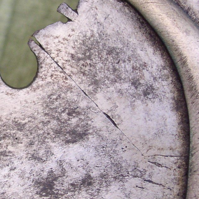

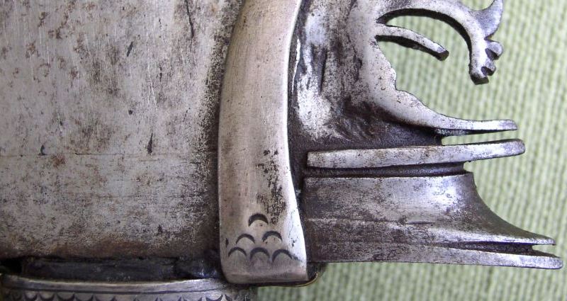

Its an interesting question about whether my kris is a separate-ganja piece or not. Initially, I thought a line on the metal itself would suggest a separate ganja, however, recently I learned that sometimes, such a line was chiselled into the blade to give an illusion of a separate ganja. So I'm not so sure anymore. My piece has a line, and a slight wedge-shaped gap at the aring end. Not sure if that is proof of a separate ganja.
Old 27th June 2006, 02:57 AM   #22
BluErf
BluErf's Avatar
Location: Singapore
Posts: 1,180
The gandik side. Hope the picture fits.
Old 27th June 2006, 05:45 AM   #23
Andrew
Andrew's Avatar
Location: USA
Posts: 1,725
Great macro shots. It sure looks like the grain of the metal at the base of the blade (where a separate ganja would be) runs perpendicular to the length of the blade.
Old 27th June 2006, 06:52 AM   #24
Yup, I'd also bet on separate gangya, Kai Wee. This seam shows the usual irregularities from forging as well as from minor corrosion (which wouldn't be restricted to one side of an engraved line but would rather go "through" it, usually) and the grain of the metal pretty much nails it. A reetching (I'd try mere vinegar) would make the latter much more obvious and most certainly bring out a nice pattern for this great blade!
