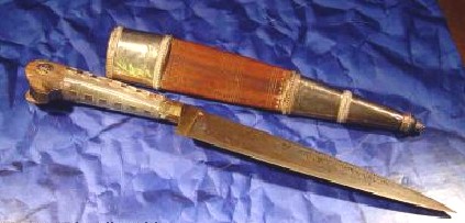

Default Comments, please on Turkish Knife, made from a file
I have posted this knife before, to ask if it had a specific name.
Now that I've received it, I've more questions than answers
I will assume that the blade is a reworked file, sharp and has a brass and silver (?) detailing. I know there have been a few 'file knives' posted, is this very common? Is it a better grade of steel compared to locally available steel.
Basically, any info on origin, function, age or general comments, gratefully received, thankyou.

Thanks for your comments Ariel. I foolishly forgot the dimensions
Blade to bolster is 17.5cm (7'')
Blade width (at bolster) is 3cms (1 3/8 '')
overall length is approx. 29cm ( 11 1/2 '')
Blade is 4.5mm thick (spine just after bolster) and has distal taper, balance point is at mid point of the bolster. Looks as if the silver banding (on the scabbard) may have had some Arabic type script which is all but polished out

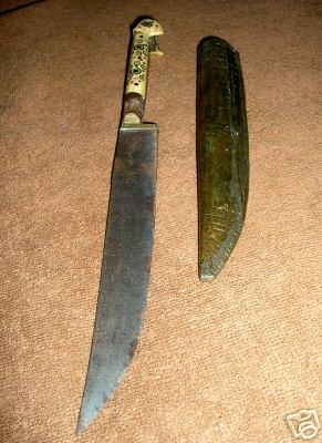

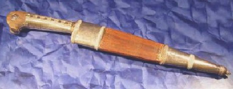

Here are pictures of the overall piece. These pictures give the impression that the scabbard is material covered, however it is lightly carved wood, which appears to be some sort of mahogany (close grained). The metal is silver (when tarnished parts wiped with clean white tissue, dark (almost black)
residue is left on it.

I am with Ariel on this one as far as there is obvious North African influence on this dagger. Look at the zig-zag motif on the scabbard for example.

When I first saw this knife I was thinking 'Flysa, North Africa with Arabic influences (silver work).
Now I've got the knife I'm not so sure it is North African at all. I can see why Tim saw P.I. as a possible source, I thought the silver work had similar designs to some of the Dha's I've seen on this forum. But the file blade !!! have knives from Africa been found to made from files. Obviously the Africans are very adept to using what they have available, but, I mean, for the better quality weapons would they have used a file?
If the knife is North African, can I assume that the silver work would only be found with a 'quality' knife?

Look at the end of the scabbard. This is Yemen silver work. The dome with the pyramid of balls. I could show some examples of jewelery .

By reading and rereading Homer's Iliad over a period of years, a German entrepreneur named Heinrich Schliemann found and excavated the ruins of Troy at Hissarlik in the latter 19th century. Both self-educated and self-financed, he performed a genuinely remarkable archeological feat-- yet in his eagerness, Schliemann dug right through Homeric Troy, to reveal several earlier levels of the ancient city.
When considering an artifact, it is wise not to proceed with an end result in mind-- let the piece reveal itself.
Considering the various elements of this dagger, it becomes clear that it is not a cohesive work. Rather, it is an agglomeration of alterations and additions. The fact that the blade is ground from a file is the least important matter in ascertaining its origin-- Britain exported good Birmingham files to Africa, the Middle East and all of Asia throughout the second half of the 19th century-- such items were traded and retraded to even farther geographical locations.
Consider: form of grips-- generally Ottoman, yes. The faceted bolsters are brass, the grips are wooden-- since both appear intrinsic to the piece they are the place where one ought to begin. This was a humble piece to begin with, though reasonably well constructed. Blade is also modest though well-ground, and of Ottoman, not North African, form.
All the rest is elaboration. The silver boss on the pommel is not Ottoman, rather it is Indian, probably Rajput as it is matrix-hammered. The wire wrap certainly is similar to work done by the Moros (Muslim Filipino indigenes-specialists kindly forgive the lack of specificity) but not necessarily exclusive to them. It can also be Arab.The sheath of wood has incised designs, typical of Algerian flyssa sheathes, yet the silver mounts are unusual in combination with it. They may well be Arab as has been observed above, but this again is not exclusive. Very similar work was produced in various parts of Indonesia. Is the sheath original to the dagger or is it a near fit which was associated with it? Finally, were these alterations made in the knife's working life or afterwards-- more recently? If the dagger and sheath and all the embellishments display a consistent patina, the dagger probably came from Anatolia and was then embellished and fitted with its silver-mounted sheath on the Arabian peninsula.
With a piece like this, it is much easier to ascertain what it is not, than what it is. By ruling out possibilities, we are left with likelihoods. Observation, followed by deductive reasoning, take us where direct assumptions cannot.
Ham

The connection between the blade and the hilt reminds me of the bosnian knives often labeled as "Bosnian Fighting Knife" from the late 1800's - see Tirri page 168, fig 118 (top) - not the best pic though. Specifically the way the brass wraps the base of the edge. I'll try to post a pic - I'm an FNG so no promises this will work..... Anyways, my two cents is possibly Balkans or similar.

Posts: 189
Katana forgive me but I hijacked your picture and did some editing of it. The edits are now on my picture site and the bandwidth is mine.
My point in doing this is offer a less educated and less articulate point of view.
Why do you think this is a file knife?
Surely not from these marks?
If those were old file teeth they would taper and disappear from spine to cutting edge. They just appear to be tool or polishing marks to me.
Now these marks...
The heavy dark ones might be old teeth from some old crudely made rasp. The do appear to taper and fade...the cutting edge is on the right isn't it? But are we sure?
The cross hatching on the spine doesn't make it a file.
And if it is an old file, does that eliminate it's worthiness or does it point to a specific maker's technique and style who doesn't have access to a local steel supply house. Does it indicate a culture who lives where supply is limited and old tools are not discarded and replaced by a visit to Home Depot, but are instead used and reused however possible. Indeed a very worthy piece for any collection
My a less educated and less articulate point of view.
Now these marks...
Hi DD, thankyou for your input...the spine of the knife is effectively the thickest, and therefore the 'teeth' of the file are more obvious. The blade is ground,which tapers to the edge, this would remove the 'teeth' as the file is made thinner to form the cutting edge. The cross hatching on the spine is not the 'remains' of the file showing, it has been incised, probably with a fine chisel, as decoration. It can be difficult to analyse a blade from a photo...its easier for me.....its in my hand
I always welcome ideas, no matter how bizarre, strange or 'commonsense-icle', this is how things are learnt, not by repeating the same ideas but by challenging them. If the ideas are right they remain unchanged but if a new idea or thought upsets the 'apple cart'. The established idea has to be reviewed, altered or thrown away....... a sort of 'evolution of knowledge'
......... oops......just fallen off me soapbox
