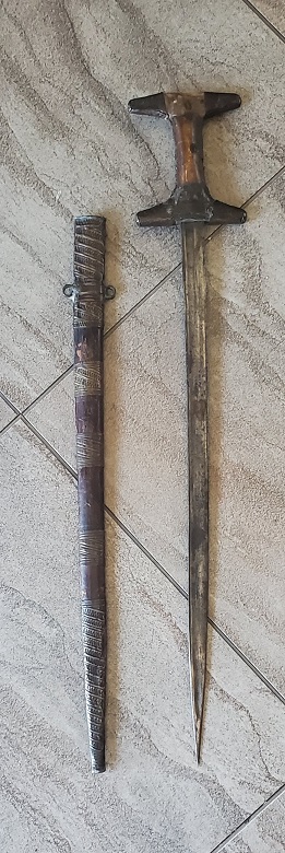

The dagger with red cord is a Moroccan genoui with what is believed to be a Mannlicher-Berthier 1892 (as seen to left next)
The next two are the yataghan blade Chassepot or the straight blade Gras

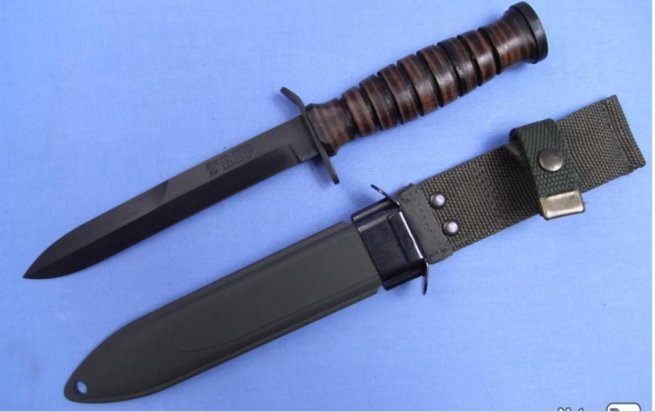

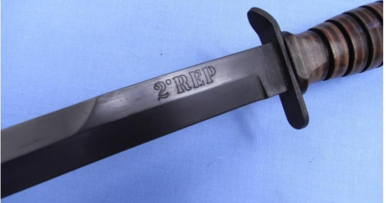

Evidence of marks on blades was just found out there, although in a late period, yet within the period of the Legion in Alger. A bayonet used by the 2nd Foreign Parachute _(2e Régiment Étranger de Parachutistes, 2e REP). The only airborne regiment of the French Foreign Legion.The regiment was constituted in Algeria in late 1955. There, the 2e REP would actively participate in the Algerian War (1954-62). In 1967, the regiment left Algeria as the last French airborne unit and was stationed on the island of Corsica.
Still leaving doubts if weapons distributed in an earlier period were also marked.
Old 25th August 2022, 07:04 PM   #6
Posts: 10,867
Excellent evidence that the convention of marking the Legion's weapons did indeed exist, as per this obviously far later example than the period we are considering. Thank you for continuing the search!!

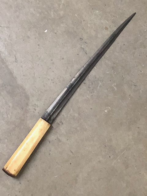

Not sure if this item fits the topic, but I've always assumed it was a European bayonet re-hilted for local use. I think it's camel bone, or at least the same bone as on a Sudanese Haladie in my collection. Not a great picture unfortunately as it's just an archive photo, so no stats to post. The pommel cap is brass if I remember correctly, and the underside of the blade is flat rather than concave.
Jerseyman is offline   Reply With Quote
Old 28th August 2022, 07:30 PM   #8
Posts: 10,867
Thank you so much for responding! This is it appears a bit of a difficult topic,
as most often the blades used on these Saharan weapons from the military sources I am considering are repurposed and altered. The section on this does seem to resemble certain bayonet blades, so plausibly indeed from one of these, actually it seems perhaps even an earlier socket type.
While with the volume of trade blades circulating in the Sahara was as previously noted, considerable, in these kinds of remote circumstances virtually nothing was disregarded as unusable.
As bayonets are not a field I am particularly familiar with, it will take some searching but I feel it is possible of a French type, though the section of the blade sounds British.
