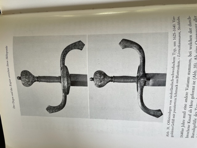

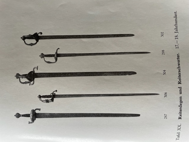

herewith my "alternative" view
it is not a sinclair sabre but a cavalry fighting sword ( reitersabel) of the Dutch-Swedish type. 1630-1660
cf the visser collection part 3 JP Puype Cat 547, schwerter und Dolche / Wegeli nr 287, SeitzII p40

re: Oakeshott
I think Oakeshoot meant the same, a Dutch Swedish broadsword from around 1650 but probably by some similarity in the form of the quillons , naming the type sinclair 2.0
