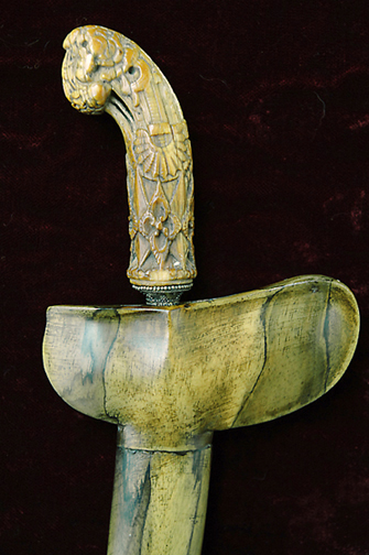

It has been a while since I last had something to share with you, but I would appreciate your opinions. I very recently acquired this keris, and I am curious if the holes drilled into the Hulu indicate places where glass or stones would have been mounted?
As always, any additional feedback is greatly appreciated. These pictures were taken immediately after receiving. I have not changed anything, removed the hulu, or messed around with it at all. One thing I will note is the ganja is a little loose.
Thank you greatly for any insights you can share.

There were no gems IMO, but just decorative holes. This is an old Madurese hilt in kojuk mrenges style and made from ivory?

I agree with Jean about the holes. But there are aspects of this material that make me wonder if it isn't bone rather than ivory.

Yes David, you are probably correct as there seems to be a repair (cap) on the top part.
Shayde, if you can free the hilt, please show us the pesi hole for checking its condition (pitting or not).

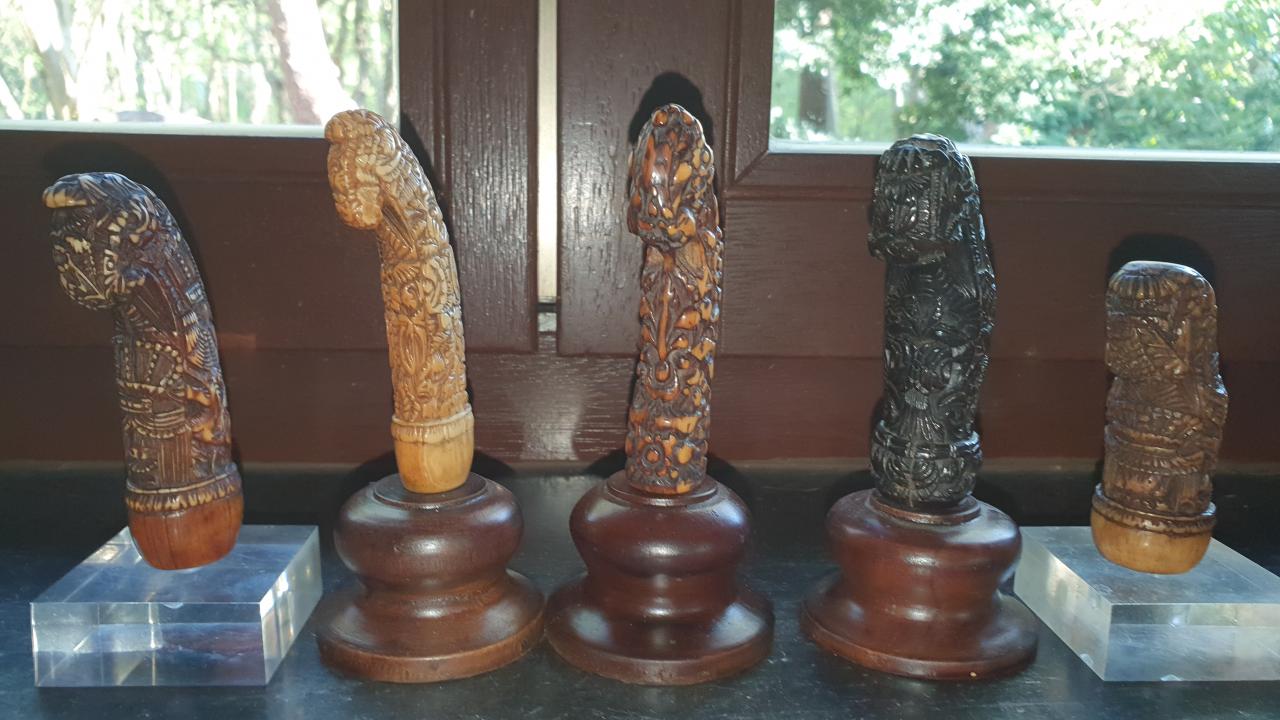

Hello Rob,
The handle is from bone or deer antler. And I agree with Jean and David the holes are pure decorative.
Attached are a few Kojuk Mrenges hilts, the three on the left are ivory, the dark one is wood and the right bone or antler.

Thank you Jean, David, and Detlef!
Makes sense that a wood insert would be necessary if the marrow cavity of the bone was larger than the pesi. Thank you for teaching me this detail as it seems it would be a sure sign of bone being the material.

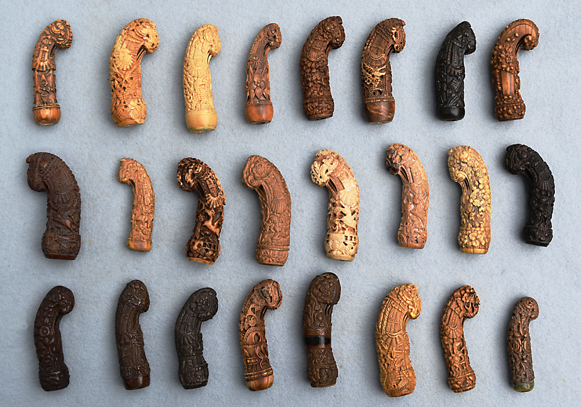

Here are a few more Khojuk Marenges hilts. I'm not sure that all would qualify as this hilt style, I think they all do, but I'm not certain because I have not checked against references, maybe there are a few that do not make the basket.
From memory, I think the name means something like a particular type of bird (a kujhuk) quivering in fear because it has been trapped.

The specimen on the far right of the top row is in tumenggunan (regent) style IMO because it has 2 flat and parallel faces on the top part.

Yes, it could be Jean, and if you look carefully you might find a few more that could be classified as something else.
I like to use the Aswin Wirjadi collection as a reference when possible, but I did not have time to do that. I've got around 100 or so Madura hilts, they're kept in a drawer --- apart from the ones on keris & a dozen or so on a display stand --- so I just sorted through the drawer and pulled out the ones that I thought might qualify, I was using overall form & epaulets or their substitution as the classifiers.
It was just a very quick pick & foto.

David, I've posted a pic 20 odd hilts.
Some have the full bulbous base (bungkul), some do not, these "do not" ones have that base similar to yours.
I don't know why, but my feeling is that it is stylistic variation, possibly dictated by available material, possibly because of a need to match proportion to a wrongko.
Or it could be because of damage to the base, but I don't think so. There are too many of these truncated base hilts floating around.
Yes, a lot of the truncated base ones have a fairly indistinct bungkul & it has been carved, also I have a few smaller ones that are on keris that do not have the bungkul.
I lean to stylistic variation.
