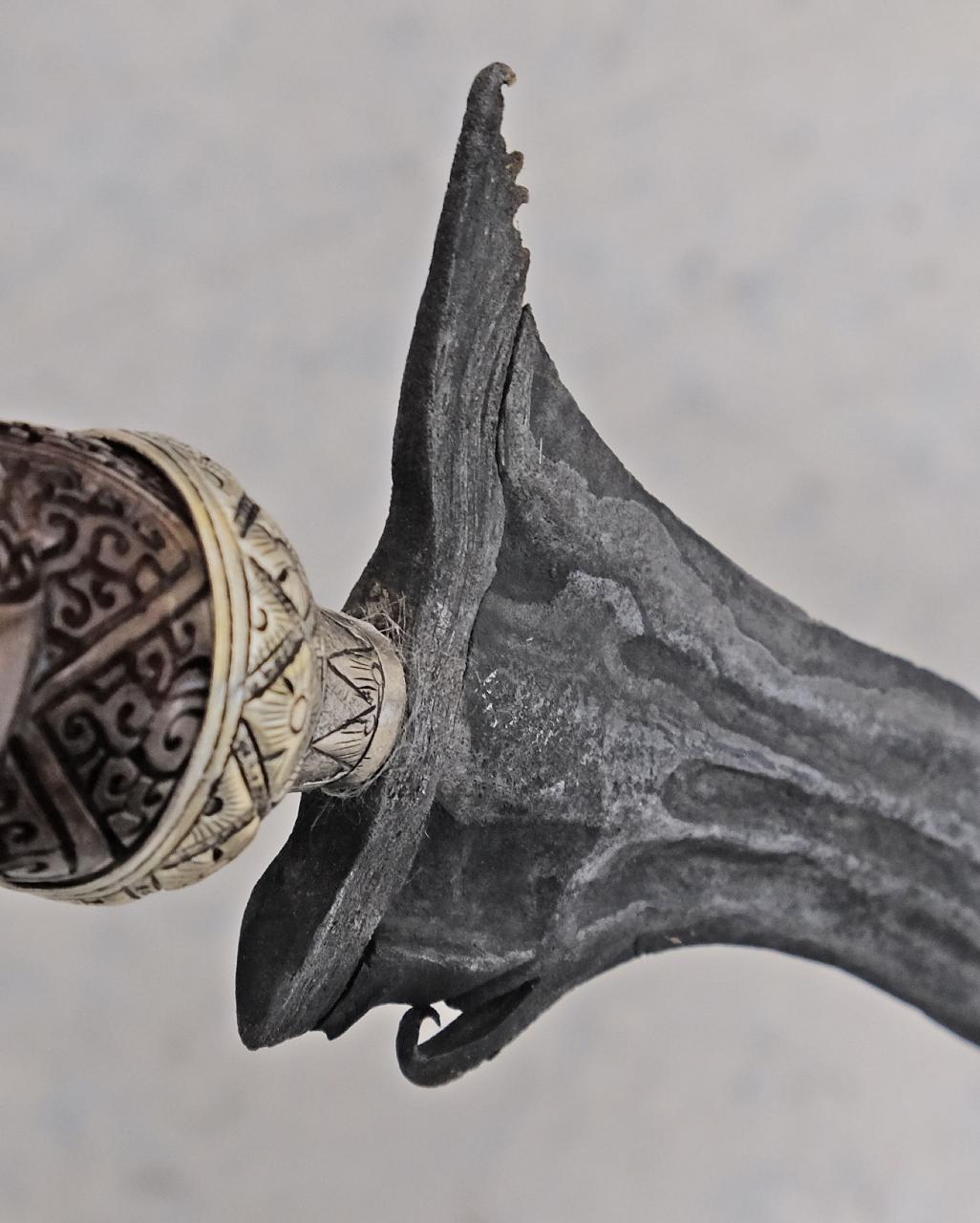

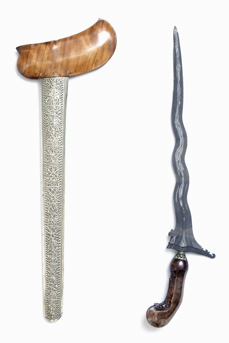

I have bought a blade with only the hilt ( Sumatran Solo hilt) quite a nice one methinks.
Anyway I will provide the blade with a new sarong or adapt an old one if I can find a suitable fitting but I am , in my ignorance, unsure of how you could class this “ wilah” , is it a Javanese wilah?
Initially I thought it was a keleng but I am not sure it will be, this is a shot at the cleaning stage
Somebody locally called it an “ High Keris” and said it was probably from before 1800 and called the Ganja kelab lintah. Another person fasked a friend in Indonesia and he said that this was a sempono panjul dapur. They all seemed to find it an interesting blade.
Again I am a beginner at all this.

This looks an old blade but not a masterpiece nor a "high kris" IMO, the dapur is not a Javanese standard and the carving & pamor pattern look of common quality.
Regarding the geographic origin, my best guess is Madura or East Java but I am not sure.

There certainly is a difference between blades deemed low end but genuine/traditional vs "interesting" vs quality vs high-end though! (Real high-end blades are hardly ever seen in public and may cost more than a new Ferrari...)
This blade I'd place in the interesting category: It exhibits some unusual features like 3 fullers (if I interpret the pics correctly), some effort put into it (like the wavy gonjo and greneng), and also subpar features like the flat "ridges" and other base features. Some of the latter may be due to being worn down or possibly even overzealous cleaning attempts with abrasives. I see laminations which will most likely show up after warangan (the contrast might be low but I'd give it a try).
This blade does not seem to originate from Java - it seems to have a Malay feel and could well be from Sumatra.

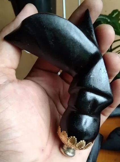

Please share the hilt, too!

I think I'm on the same page as Jean with this keris.
If I had it in my hand, and if it was in stain, I might be able to put a reasonably accurate age on it, but it deviates quite a bit from the norm and I cannot read the material when it is out of stain & in a photo.
Best I could offer would be probably pre-1850.

You’ve asked pictures of the hilt, I took them. It seems a nice Solo hilt. It wil be cleaned a bit better.

@Kai, You saw the hilt ( sorry the length will have to wait because I didn’t measure it before sending to wash and now it is not in my possession but it is rather shorter than all the Javanese krisses I own).
Despite my obvious ignorance of many things concerning the krisses, I too have the impression this was a Malay influenced blade. You are right yes 3 fullers , I am not sure there are flat ridges but that may be due to the rather poor photography (it was a cut out from a telephone shot) nowhere near the quality of a camera shot.
It would be nice to determine whether this is indeed a Malay blade so that , comes the time to find a sarong, I’d be able to work in that direction.
I have a bugis gandar ( no warangka I am afraid) and maybe I could find a warangka in that style but it is very difficult to find parts in general but even more Malay parts in the NL.

I agree with what Alan said about trying to judge this keris before it is properly cleaned and stained. I suggest you post more photos once you get the blade back after Warangan treatment.
The hilt that you show is very nice, made of select wood. But I am also having trouble placing this as definitely being a Javanese blade. Hopefully we can tell more after warangan.

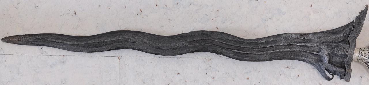

Well the blade has been washed and although it is not Keleng doesn’t display a great deal op pamor, according to the expert washer this is rather typical of old baldes and perhaps even of Malay blades.

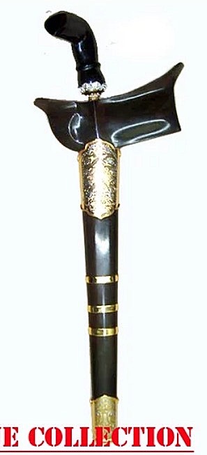

Meanwhile, since this balde came with the wrong hilt and no sarong , I bought the most correct ones that I could find through a Javanese agent , he told me that they are not easy to find there at all and I know it is next to impossible where I live in the NL.
I will get back to you with more images , first of the blade and then, of the finished Keris once all the parts will arrive

Well the blade has been washed and although it is not Keleng doesn’t display a great deal of pamor, according to the expert washer this is rather typical of old blades and perhaps even of Malay blades.
Meanwhile, since this blade came with the wrong hilt and no sarong , I bought the most correct ones that I could find through a Javanese agent , he told me that they are not easy to find there at all and I know it is next to impossible where I live in the NL.
Hello Milandro,
I am not too surprised by the cleaning results, is the ganja looking similar to the blade? Which "more correct" sarong & hilt did you find?

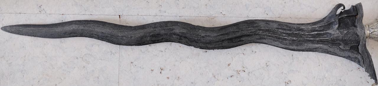

Yes the Ganja is similar to the blade (I will add a picture but it is a rather low res image, ik will make better ones next week when the baldes I have commissioned to be washed will finally get back to me).
I bought the most correct (not more but most, probably there are more correct ones but I couldn’t find them so I didn't buy them) that I could find, I was offered a choice of two, one very similar to my Palembang keris and this other more Flashy one , this one was “correct” for this blade, at least according to the advise of the seller and of a friend who advises me in these kind of things.
We shall see what happens, the proces of ordering stuff like this at a distance without seeing the end product is rather unnerving, also the fitting of the balde will relay on some uncertainty even if I will take pictures and add measurements

Thank you Milandro, the blade does not look bad even if the pamor pattern is not much contrasted.
So you have selected a new Sumatrese style dress, it may be a bit difficult to match the curved ganja with the sarong but hopefully it will look OK.

In the end I did go for another sarong ( and also a different hilt ) since the one that was shown about was too short for the balde.
I may put it in another Sarong bu this is not the object of my returning here to this thread.
Would someone care to comment about the Dapur? Could this be a form megantoro ?

This is not a Megantara dapur (see pic) which is a Javanese dapur by the way.

I am not convinced that it is a Melayu dapur. Anyway you were lucky that your proposed sarong did not fit as it was not a good match IMO

What is the blade length? The peculiar features of your blade are the kruwingan (the 3 long grooves), the curved ganja, the deep pejetan, the odd kembang kacang, and the indistinct pamor pattern.
The proposed sarong is in East Sumatra/ Malaysian style which is more suitable for a Bugis style blade.

29,5cm

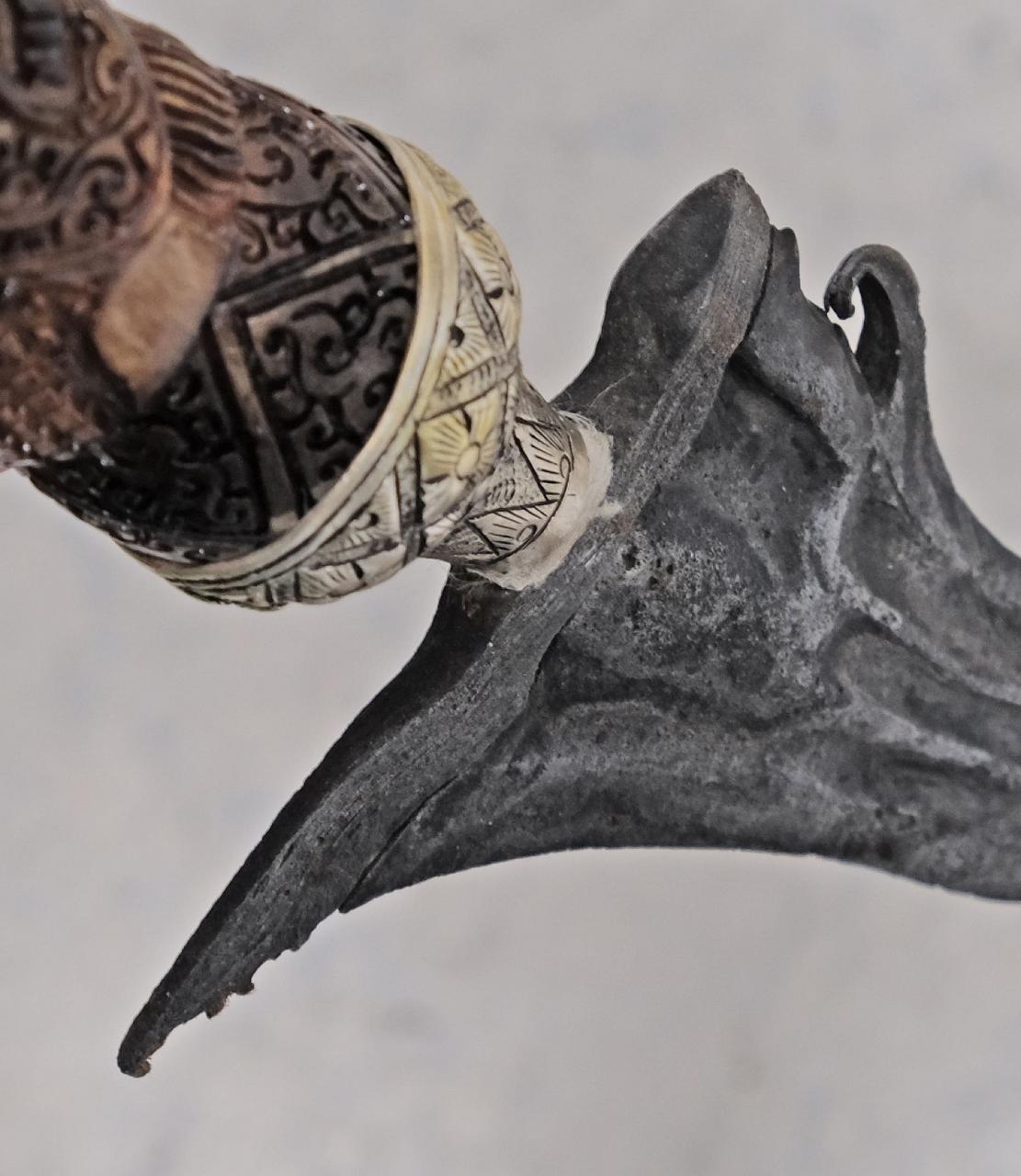

Close-ups of the base of the blade would be great, too!

this blade, unlike the other one, is mounted with a hilt en selut , so if you don’t mind, I won’t take them apart to avoid the fuss.
I shot two pictures which, I hope will give sufficient food for thought anyway
I have made the color lighter for the purpose of observation, but this is not the regular appearance , although it shows some differences in colors of the metal which I wouldn’t necessarily call pamor
