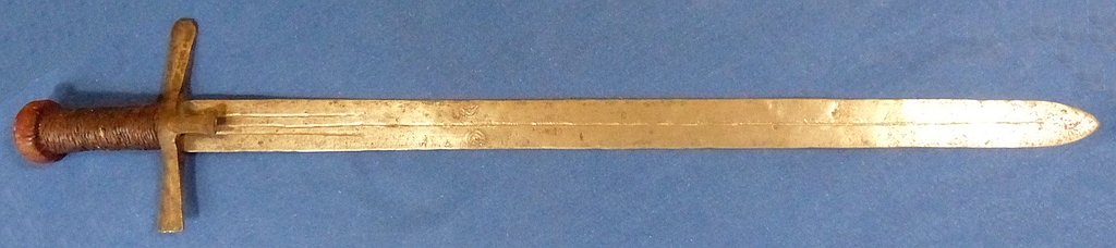

Default Sudanese ceremonial type kaskara
Good Afternoon All
My next offering to the group.
This example has a brass cast cross guard, crocodile skin handle with part of the claw still present thats stitched on and a 24inch blade. The blade although faded is etched either ornate Islamic writing or patterning on both sides of the blade. Its made from a flexible metal and so is definitely an ornamental/ symbolic type kaskara.
Again im unsure of the age or even if its a tourist piece but i do like it.
All comments welcome

Bling Short sword (infantry?) version. Possibly used by an elite Mahdist 'Officer' or 'Noble' who would wave it and extort his cannon fodder to charge the Brits in their quest for Paradise, while he stayed well back in order to have a chance of fleeing. Does yours stay bent after flexing?
'Springy' metal is a good thing. Really stiff usually means fracture if it snaps, Bendy, as in not returning to straight after flex, is not quite as bad, as you can field straighten it. Many European trade blades meant for combat are springy. Local made blades can be less so. 'Islamic' writings on blades in Arabic can be unintelligible gobbldy-gook, many were done by illiterate workers. Better ones have Koranic verses. Is yours sharp?

This type kaskara with the Thuluth etching on the blade and the cast copper alloy crossguard is a fairly common thread on the Forum. Jim is the resident expert on the subject. Search on Thuluth Kaskara for excellent discussions. The first thread plus one from 2010 have much information if little conclusions re Sudan.
http://www.vikingsword.com/vb/showthread.php?t=26896
http://www.vikingsword.com/vb/showthread.php?t=12225
Sometimes I think these swords were made in Omdurman at the close of the Mahdiya and at others made in Egypt and exported to Sudan again toward the end. No real objective reason to believe that either is correct.
Ed

Personally, when I see these I tend to lean to the Victorian times souvenir hypothesis. The victory of Omdurman was well publicized at the time, and the abundance of trophies brought back soon created a market for souvenirs from the the defeated Mahdists. The locals were more than willing to meet this demand and I suspect that a souvenir industry appeared as a result, with some of the fancy 3-dagger sets with antelope horn hilts and scabbards made of juvenile crocodiles that we see every once in a while as part of the production.
When one examines the sword, which looks like it has a short blade made of sheet steel with no distal taper, it would appear that more effort went into etching the script on the blade than the blade's actual forging (if it was actually forged and not just cut out). The rough cast brass hilt is also something that was mass produced, and the crocodile skin (in other examples monitor lizard skin is used) is there to make the whole thing more exotic and aesthetically appealing to a Western audience.
While not actual militaria from the time of the Mahdists, these swords are antiques in their own right and an interesting example of the impact the Mahdists had on Western imagination, even after their destruction.

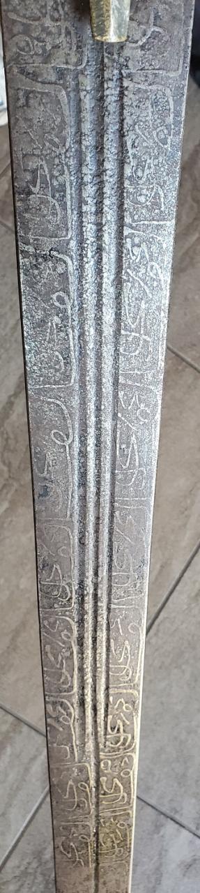

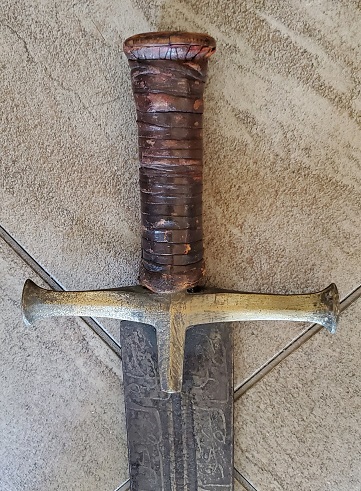

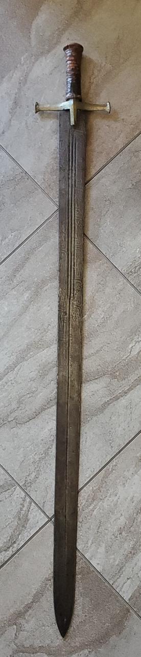

Jim and Ed its interesting you mentioned the 2 different types of these sorts of kaskaras as it brings me nicely onto my other one that falls more into a functional fighting sword rather than just a symbolic item.
This one has a 33inch blade that appears to be well constructed but has engraved rather than stamped ornate crescent moons. Not sure how practical the handle would have been though with all the ridges from the croc skin.
I've attached photos for your viewing.

Your last sword has a righteous imported 19th C. blade with nicely done fullers and half moon etchings. To me the croc skins were incorporated to appeal to Victorian travelers post-reconguest. The grip is too rough for a legitimate hand hold and the scabbard appears not to have attachments for a baldric to carry it over the shoulder. While there are mentions of "crocodile cults", I haven't run across any reports in Sudanese Notes & Records that has lots of ethnographic papers dating from 1918 to 1974; and I've browsed most of the them. Also, over use of croc imagery doesn't seem "Islamic". The above is based on belief rather than facts so take it as you will.
Ed

Really appreciate the answer on the other kaskara and I would definitely agree with you that the grip definitely isn't practical and neither is the scabbard. I would definitely be with the train of thought that the original handle has either been removed or come off and has been replaced with croc skin and fitted with a macabre croc scabbard.
But as victorian tourist must have done there is something about it I love and had to have one like this
