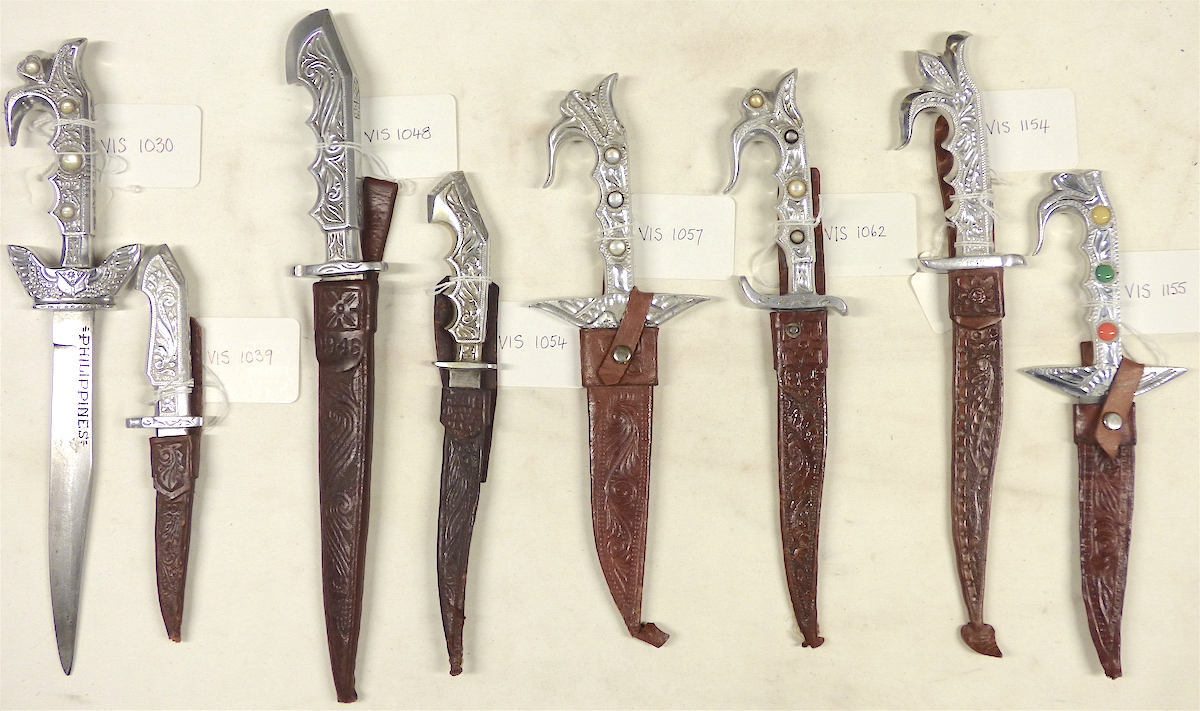

P.S. Here are some of those aluminum-hilted knives. They often have stamped inscriptions, such as "Philippines" or a year (the earliest I have seen is 1945, and most are shortly after WWII). One of mine has "CEBU" imprinted. The imbedded "dots" are MOP, natural stones or plastic. Note the small ricasso on the blade without a sheath.
