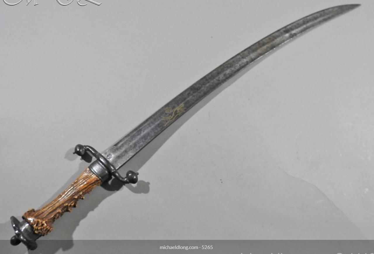

Default sword image
Yes, it is a Hounslow Hangar; see attached:
