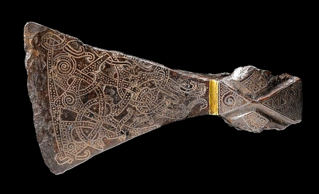

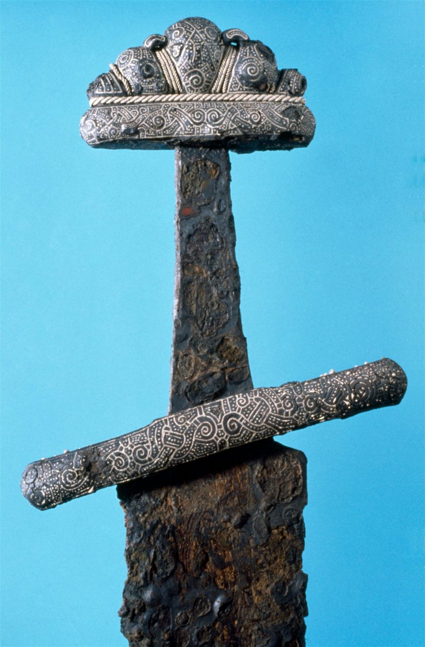

The hilt ornamentation we see here is instead a poor imitation of designs that do appear particularly on hilts of Petersen's types O and R, and can be associated with the 10th century Mammen style of Scandinavian artwork. The intricacy and quality of the designs on every genuine weapon decorated in this manner far surpass what can be seen on this sword and others that have appeared at auction in recent years. For comparison, I attach an example excavated in Norway, and the namesake axe from Mammen in Denmark.
