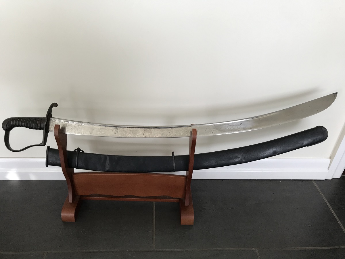

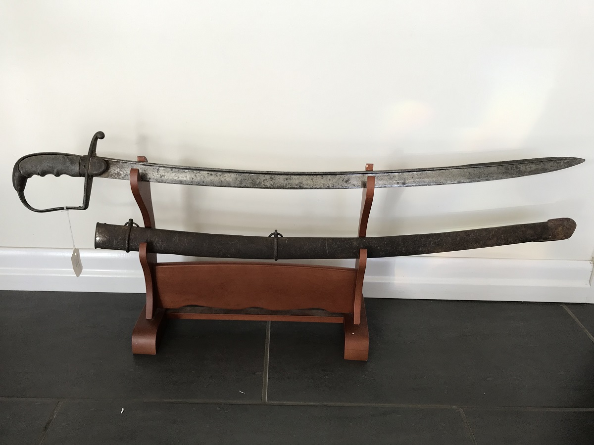

This saber is what I believe is British, and possibly one of the many variations of the M1796 stirrup hilt sabers for light cavalry of this period, and most likely for an officer.
It was featured in an article on M1796 sabers in Denmark around 20 years ago which concerned the numbers of variations in these swords.
In the 1790s, Henry Osborn of Birmingham teamed with a British cavalry officer named LeMarchant to develop the first regulation patterns for the British cavalry known as M1796.
While the blades seem to have had a number of variations, some with 'pipe back' (many of these had the stepped back yelman point), and even cases of 'yataghan' type blades, this is the only version I personally have ever seen of a 'shamshir' type blade with this pipe back . Typically the M1796 had what s known as a 'hatchet point' which was a radiused point rather than sharp tip .
Also unusual is the deeply canted hilt which is a characteristic I have only seen on certain type of shashka from the Caucusus regarded as 'Mingrelian' if memory serves.
What is known of this period of sword development in England is that numerous variations observing other sword forms from various nations were considered. Possibly the Caucasian types might have been noted?
I would be curious to know if others here have seen similar examples and thoughts on this anomaly.

Hi Jim,
I would have designated this a Flank Officers sword of the Napoleonic era rather than a cavalry sword. The curvature of the blade and the canted hilt would suggest to me that this is the more probable attribution.

Hi Norman,
Thank you, and that has always been a consideration given the dramatic curve of several, I think of one 1803 lionhead with such a blade. I wonder what the purpose ? might be? The Napoleonic era was such a fashion parade, especially with the 'hussar' phenomenon, and any dramatic effect seems to have been almost a contest.
'Mines curvier' ! etc.
The huge drags on the scabbard chape were for the low slung sabers to make noise as the hussar swaggered, the tall shako's for addition of height to look more formidable etc.
I cannot imagine a pragmatic reason for such curve unless perhaps more cutting surface in closer quarters?

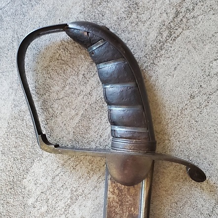

G'day Jim,
That is a very interesting sword. I haven't come across that combination of canted hilt and pipe-back blade before. Normally these canted hilts are associated with flat, unfullered blades. I have two of these, one maker marked to a tailor Maullin and Co and owned by an artillery officer and the other brass hilted example by Osborn and Gunby. Both of mine have 69cm blades. How long is your blade?
I have done a bit of research on the earliest British pipe-back swords and the earliest dateable ones I have found are circa 1798-1800. By 1815 they were very common for officer's swords. The earlier ones tend to have very fine cutting edges. Looking at your photos, your example appears to have a very pronounced secondary bevel on the cutting edge, indicating a heavier blade.? To me this probably dates it closer to 1820 than 1810.
I think this style of sword could have been carried by an officer of just about any branch of the army ie infantry, cavalry or artillery.

Thank you guys for these great entries and observations! I apologize for not providing dimensions in this, I dont have the sword at the moment but will get those details asap.
As noted, it does appear the 'pipeback' did become more popularly known in 1820s and notably present on many of the 1820s period officers swords.
I think, as Norman has just noted, the 'officer' denominator illustrates the key factor that officers tended to traverse various branches of service and units.
Many officers might be in cavalry unit at one time, then transfer into infantry or artillery with trading of commissions.
In most references I have seen, it does seem that officers were not expected to participate in regular combat activity, but primarily to direct forces. Obviously, this seems unlikely to be a standard as combat circumstances could render it necessary to defend oneself as required.
I am not sure the interference of the ramrod back preventing a through cut is a deterrent for its viability as a blade feature. The typical cut with these curved blades is more 'draw cut' I would think rather than the chopping action of the heavier and hatchet point blades of the more common 1796 blades.
I personally agree with the observation this is likely an early example of a saber among 'test' patterns c. 1800, and quite possibly even a prototype using the ramrod back. As I had mentioned, Osborn was using various types of swords, including tulwars and shamshirs as test models, among others.

These are great examples Bryce. It seems the hilts look slightly canted, and again, something to 'flank' company favor it seems. I am unclear on exactly what the 'flank' company designation entails, but it seems that on the M1803 examples there is a horn device which is used to identify them as such.
Perhaps this might explain the purpose of these units?

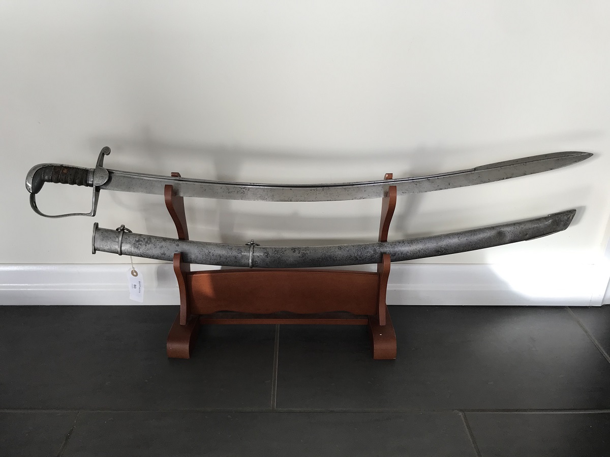

Here is a British pipe-back sabre circa 1816. It has a heavier blade like Jim's although much straighter. It was made by GS Reddell and is marked to the 7th Hussars, with the initials CJH for Charles John Hill who joined in 1816.
Cheers,

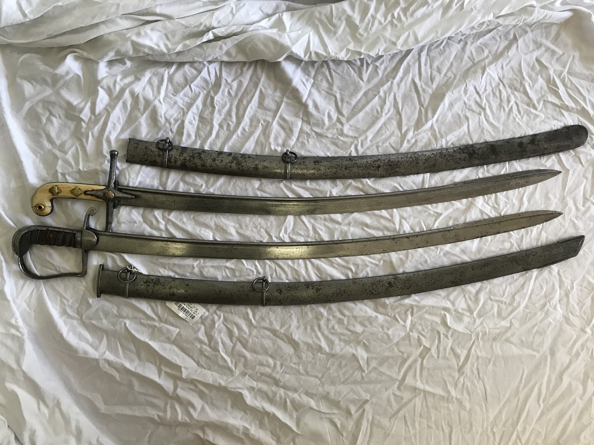

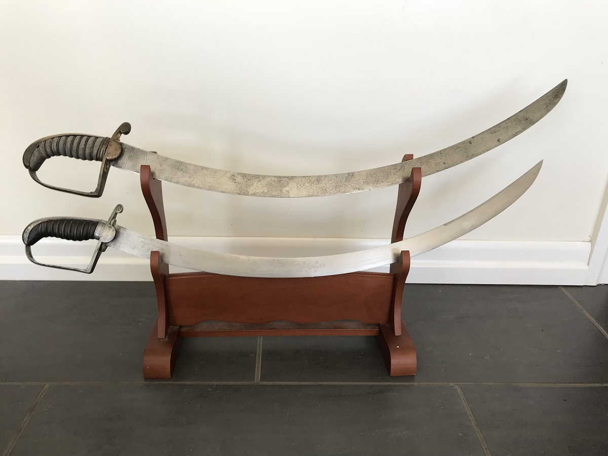

To show what I mean by a heavier blade compared to one with a fine edge, here is the sword of Richard Beauchamp of the 16th LD circa 1811. Compare the fineness of the blade edge to the 7th Hussars sword below.
Cheers,
Bryce

Here is a pipe-back sword which can be positively attributed to a flank company officer during the Napoleonic period. It was made by Prosser and marked to the grenadier company of the 45th Regiment of foot. It is the mameluke hilted one above Beauchamp's sword for comparison.

Here is one of the earliest British pipe-back swords I have seen. Made by James Wilkes around 1800. The intent was to make a better cutting sword by giving it a very fine cutting edge, with the pipe-back there to maintain the rigidity of the blade. Note how the "pipe" doesn't continue thru to the point unlike later versions. It also has the same curve as a standard 1796 sabre. Most later versions tended to become straighter, with the obvious exception of Jim's!

The wide bladed Prosser (and Wilkes) versions allow for a decent cutting geometry - a finer, sharper edge angle. The narrower the blade, the steeper the angle you need to sharpen it to keep the spine from getting in the way of the stone. You can have a 'razor' sharp edge but if the edge angle is too great, it will not cut well.
The Prosser style blade width allows a deeper slice before the added friction of the spine lessens the cut effectiveness.
The Wilkes version further improves the cut by removing the 'pipe' in the most effective cutting are near the point. Many swords are only sharpened in the first third to half of the blade from the tip, which is where you would normally cut - the rest unsharpened to improve notching resistance during a parry - and the Wilkes tip would allow that part to make a deeper cut after the further section initiated it during a draw cut, or a deeper push cut with the tip initiating.
Bryce, those two swords, Mameluke/1796lc style pipes, are gorgeous. I shall put purchasing similar ones on my bucket list.

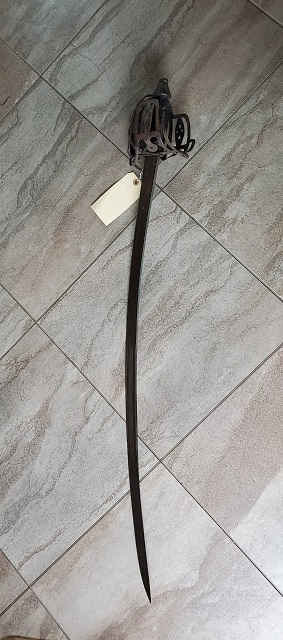

I wanted to add here another example of an 'out of character' saber which may fall into this unusual 'flank company' denominator.
It is a garrison type basket hilt of c. 1740s (typically by Jeffries, Drury in London), but here it is found with a M1788 cavalry blade. When I acquired this many years ago, it was suggested it may have been for a flank unit using the old basket hilt, obviously likely in one of the Scottish regiments.
In the 1780s the use of the basket hilt was ceased by infantry (i.e. Black Watch ) and perhaps an officer chose to use this remounted hilt as a fighting sword with curved blade.
It would seem that the flank companies, by their very nature (skirmishing is described as 'irregular' fighting or combat outside normal battle regularities) had a degree of carte blanche in weaponry, particularly the officers.

Bryce again thank you for the great examples, and I WILL get the rest of the measurements on this blade asap
Old 12th December 2020, 03:36 AM   #22
Posts: 10,867
Finally!
The blade is 32"straight line hilt base to point.
It is 1 1/4 " for 23"
Then drops to 1" @6" from point as it radiuses out to sharp point.
The raised (thickened) 'step' begins 9" from point.
It is almost as if it was intended for armor piercing with respect to the bolstered blade points on Indian weapons such as tulwars.
We can only wonder if there was some imagined intent to piercing mail or thick padding of textile.

This type munitions grade basket was produced by London cutlers Jeffries as well as Drury and perhaps others in about 1740s. During the American revolution and after, the infantry other ranks ceased carrying swords, and relied on the bayonet. These basket hilts apparently ended up largely in stores and it is unclear what further use they mght have had.
However, with my example, it was mounted with a M1788 light cavalry blade and when I acquired it about 40 years ago, it was suggested to have been for a flank company officer. For some time that seemed somewhat plausible and it was some time before I saw another also mounted with 1788 blade in the same way.
Could this have indeed been for a flank company officer's use as a fighting weapon? or perhaps for cavalry officers in similar manner? or....further, a naval weapon? (naval officers also often favored cavalry weapons, and not all combative situations with naval contingents were at sea). It is known that in numerous cases, the basket hilt was found in maritime context.
These are questions which typically will remain held secret to the weapons themselves, and we can only speculate. Still certain forensic and other types of evidence can sometimes offer compelling direction to these theories.
