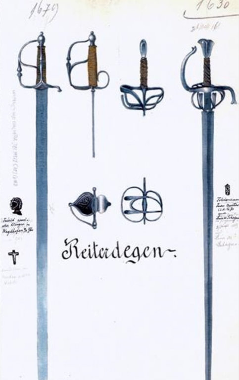

Staffan Kinman’s ”European Makers of Edged Weapons, Their Marks” (2015) shows the following with crucifix marks:
Hannes Cleles, Solingen c. 1580-1640
Pedro Hernandez, Toledo @ 1610-1630
Johannes Kohl the Elder, Solingen 1580-1620
The Reiterdegen with crucifix mark is illustrated in Anton Dolloczek’s ”Monographie der k.u.k. österr. ung. blanken und Handfeuerwaffen” (1896).

Originally Posted by AHorsa
Great! Thank you very much Victrix!
Is there written on the illustratoin if the blade is contributed to one of the named makers (and that the blade is earlier zthan 1679)?
Best regards
Andreas
I can’t read the writing unfortunately; it’s too faint. Seems this crucifix appears with a Moor’s head? I think the year is fairly definite with the earlier version of Reiterdegen in the book having a fishtail pommel.

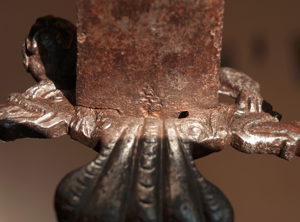

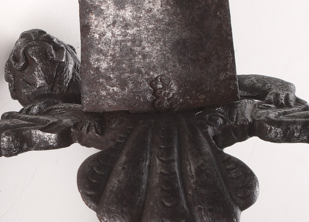

Posts: 386
Thank you Victrix!
You cited from Staffan Kinman’s book. Is there a flower pot mark described in that book by any chance? The mark was discussed years ago but couldn´t be assigned to a specific maker.
Thanks
Andreas
AHorsa is offline   Reply With Quote
Old 15th June 2020, 08:29 PM   #6
Victrix
Victrix's Avatar
Join Date: Apr 2017
Location: Sweden
Posts: 783
Thank you Victrix!
Thanks
Andreas
I’m currently out on an island in the archipelago without access to the book. Will check in few days time.
In the meantime might we see more of your interesting sword?

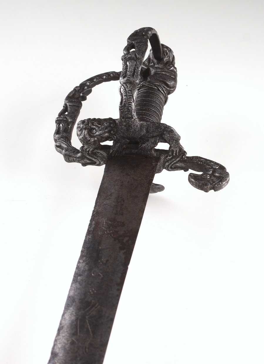

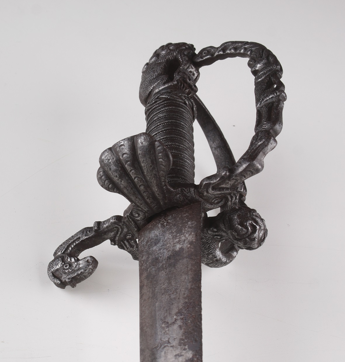

Old 16th June 2020, 11:39 AM   #7
Originally Posted by Victrix
... In the meantime might we see more of your interesting sword?
Yes, Andreas; please do it !
Old 16th June 2020, 02:39 PM   #8
AHorsa
AHorsa's Avatar
Join Date: May 2014
Location: Rhineland
Posts: 386
Would be great if you could have a look, Victrix.
The sword was discussed years ago in this thread:
http://www.vikingsword.com/vb/showthread.php?t=18464
Old 18th June 2020, 03:50 PM   #9
Victrix
Victrix's Avatar
Join Date: Apr 2017
Location: Sweden
Posts: 783
Yes I remember this stunning sword. You cleaned it so well.

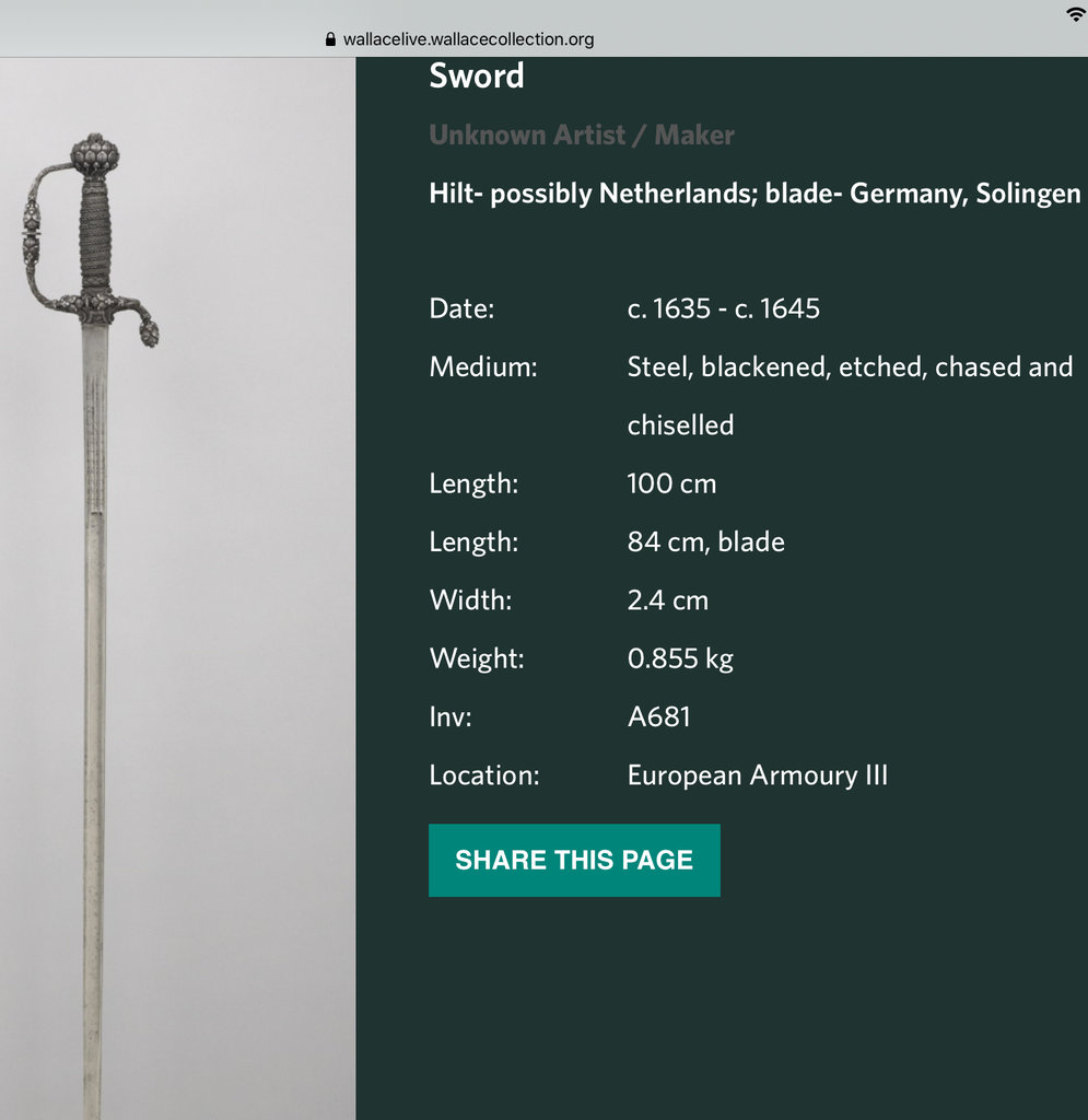

The nearest mark I can find in Kinman’s book has a reference to the Wallace collection which looks about right, although it doesn’t show the mark nor mention ”Viennese.” It doesn’t give any name of the maker/smith but states Solingen which corresponds with the running wolf mark on your blade. Could the number 1518 be the Bible’s John 15:18? https://www.kingjamesbibleonline.org/John-15-18/

This mark is also described in the Wallace collection catalogue and it says that it also exists on a rapier in the Metropolitan Museum and on a sword in musee lármee Paris. But sadly also no name.

Yes I missed the Description bit: ”Swords with hilts of this kind are often described as Viennese. Compare the mark of a pot of flowers on a Solingen sword in the Musée de l' Armée, Paris (Weyersberg, Solinger Schwertschmiede, p. 75) and a rapier in the Metropolitan Museum, New York (no. 1056). Another was at one time in the de Cosson Collection.”
