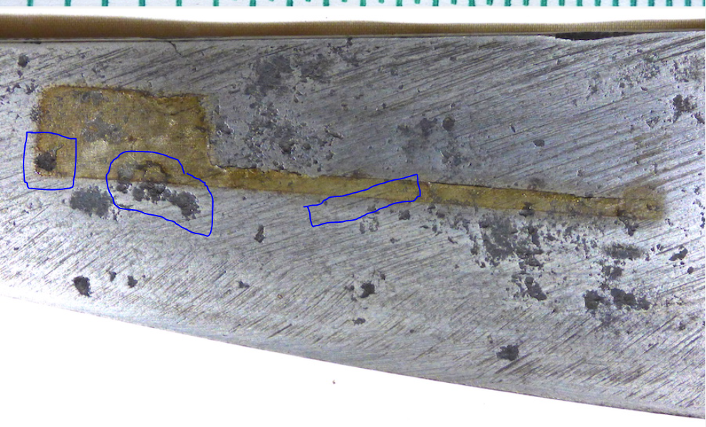

I'm having trouble placing where this one may be from. I think it is from the Philippines, and at first sight I thought it may be from Bicol. However, the raised carved area on the front of the scabbard does not have a hole drilled through for a belt. My next thought was Mandayan, from Mindanao just north of Davao City, who have a fat bellied bolo with a scabbard that has an upturned toe, However, the blade does not have the characteristic small lower protrusion near the hilt that is present on their blades.
The blade is V-ground (not chisel ground) and has an unusual brass insert that looks like an axe. There is also an old collection tag on the scabbard that states it is Filipino. Provenance is unknown.

Hello Ian,
The corrosion / pitting seems to be present in the iron and the brass. Even on the edge of these 2 metals you see the same pitting.
This really strange, Is it brass ? Is it not a layer of old varnish or glue giving the metal a different colour ?

Willem,
I see what you mean. This is definitely an insert into the blade as I can feel an edge to it that goes into the blade. The corrosion/oxidation does look a bit odd and I shall give it gentle clean in that area and let you know what I find.

Could the "inlay" be a piece of torn tape varnished over? Looks like a "shadow" on the blade where the removed tape may have been? Or is it just my old eyes?
Ed,
You may be right. When I run a finger over the area it is slightly raised and smooth. Scratching the surface with a finger nail does not remove anything, but the blade appears to have been finished with a hard wax, probably silicone-based, which has hardened the surface and may be obscuring what is happening underneath.

asomotif
asomotif's Avatar
Join Date: Nov 2006
Posts: 2,238
I still have my doubts about the inlay.
Look at the parts that I have marked.
There is pitting in the brass ? there is pitting on the edge of the iron/steel and the brass. Where have you ever seen that iron and brass are showing the exact sort of corrosion.
Also the file marks, they go smoothly from the iron into the brass.
Alao the shape of the inlay does not make sense.
I still go for varnish or glue remains.
Willem

Thanks Willem. All good points, which are particularly apparent on the blown up picture. As noted previously, the blade has been treated with a hard substance and I can't get to the underlying surface without destroying that coating. Organic solvents have not helped. I think you are correct that it is likely something on the blade rather than an inlay.

Now let me play detective as well. I believe what you see are the remains of scotch tape that covered a descriptive label about the item; over the years the tape yellowed. The tag was removed with the tape and thus you have the brass colored perimeter where the tape was left; the tag may even be the one now on the scabbard. Measure it and see if it fits.

As I look at it again, I now think it is old tape instead of brass inlay. I can see corrosion or forging flaw underneath the tape.
