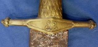

A recent find and so far and now know it is Spanish 1843p but I do not know what the markings signify on the crossguard. From what I've read it could be artillery, pioneers or infantry, possibly something else?

Posts: 1,268
This item - Machete Modelo 1843 - is used by the Spanish "GASTADORES DE INFANTERIA". Unfortunately my knowledge of the Spanish language is very weak so I cannot translate this expression. But I'm sure that there will be help by others.

Old 20th October 2019, 12:23 PM   #5
Originally Posted by Will M
... but I do not know what the markings signify on the crossguard...
It should be the regiment's number; 11 ?

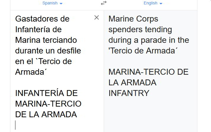

Old 21st October 2019, 11:33 AM   #7
Precisely as i approached in my previous post. Translating gastador in a machine will give you (money) spender, thus showing us a funny result.
We should consider the other acceptation of the term and follow that path. Gastador = Latin vastator, from the verb vastare, devastare, and in this archaic form it indicated the one that would hack, ravage, destroy or devastate a region. In the seventeenth century it meant men who had the task of clearing paths, building and repairing bridges, digging ditches, digging trenches, and generally doing all the manual work of preparing the ground for progression, defense, or development. Army assault on an enemy fortified position. They were the predecessors of the sappers.
