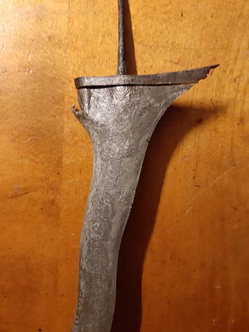

Would it be possible to identify the origin of this kris ? It has a rather disproportionate base part and an ULER LULUT pamor which made me suppose a Balinese origin. On the other hand overall size (35 cm or 14 inch) leads me towards Java. Sorry for the bad pic. I am trying to etch the blade.
Thanks in advance for your help

Photo follows

Here it is

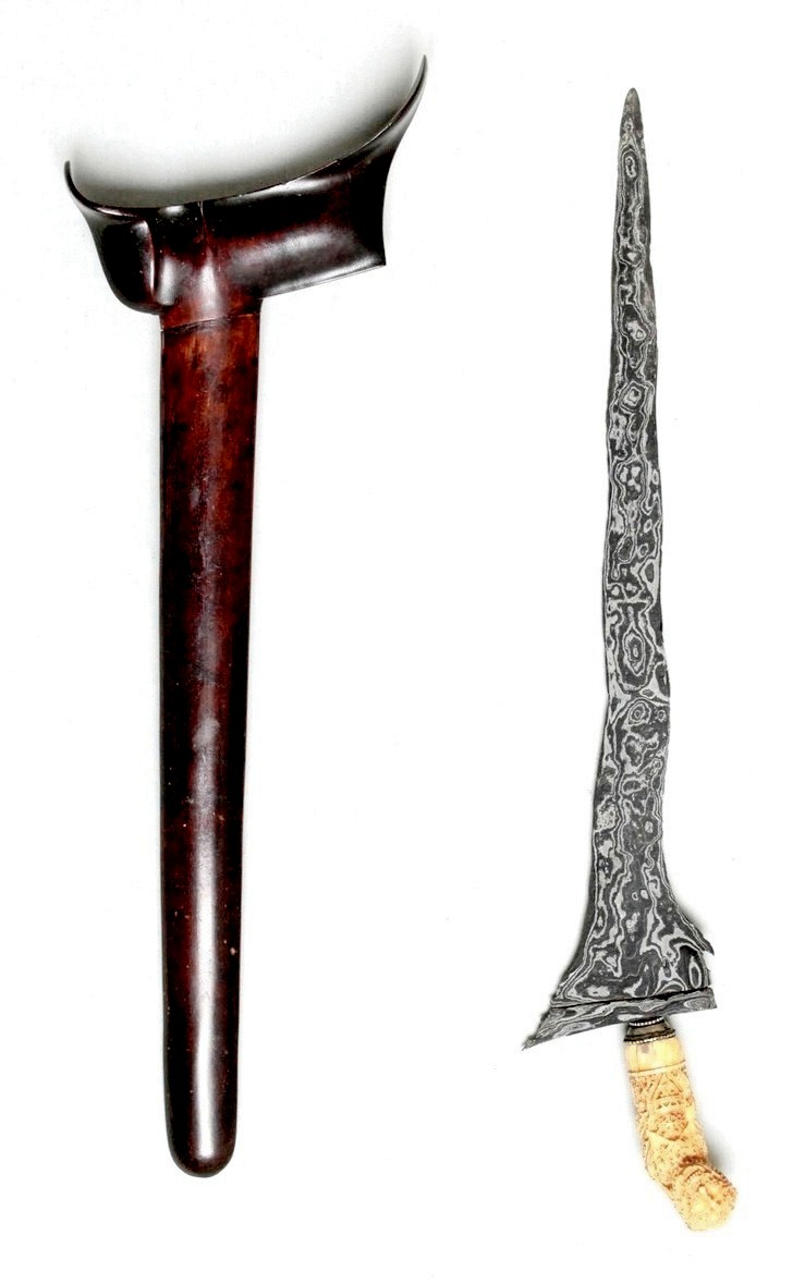

Not Balinese IMO but rather S... The shape with the protruding ganja and 7 or 9 very shallow waves is typical.
Old 26th September 2019, 09:19 AM   #5
Posts: 7,230
It might be the camera angle Jean, but from what I can see I doubt that this keris is classifiable as Segaluh, the blumbangan does not appear to be wide enough, the pesi is insufficiently central. But I would tend to agree with Sunda/West Jawa.

Jean
Join Date: Jun 2009
Posts: 1,740
Thank you Alan and I agree with Sunda/ West Java (the land of origin of Segaluh), but do you refer to my blade or the one from Gio?
Old 26th September 2019, 09:52 PM   #7
Posts: 7,230
GIO's keris Jean, your's is definitely Segaluh.
Thank you Alan. I feel amazed that this type of blade with such a complex pamor could be attributed to a tangguh linked to a 12th century period, but we know that it is irrelevant.

Many thanks, Jean and Alan, for the kind and complete explanation. And yes, I find my keris very similar to Jean's for what dapur is concerned. I suppose, as said in my opening post, that such pamor is not so common on West-Javanese blades. Once the etching is complete - and successful !- shall post pics.

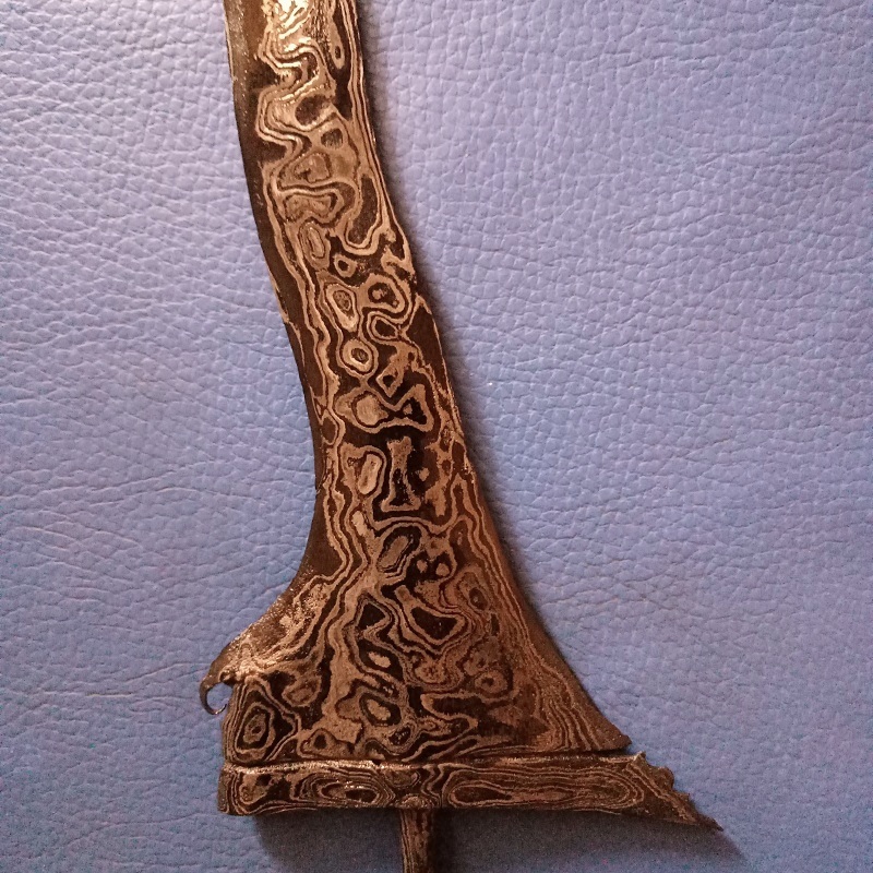

Hello Gio,
I also got this one in my collection with a dapur more similar to yours but which is more recent I think.

Hi Jean
here a better pic of my keris, if it may help
