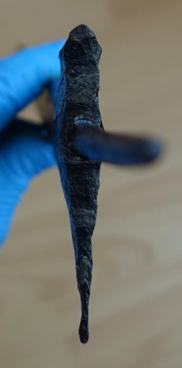

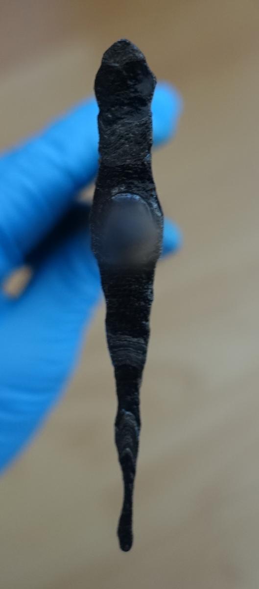

Nice keris Marius, however, with these plain, straight forms, it is often impossible to give much info about origin from profile photos. It is Javanese, and as a guess, I'd say possibly North Coast, Tuban classification.
To confirm or deny this we need a photo taken looking down onto the top of the gonjo. The gonjo form will give a good indication of classification (tangguh). If it is not Tuban it is possibly East Jawa.

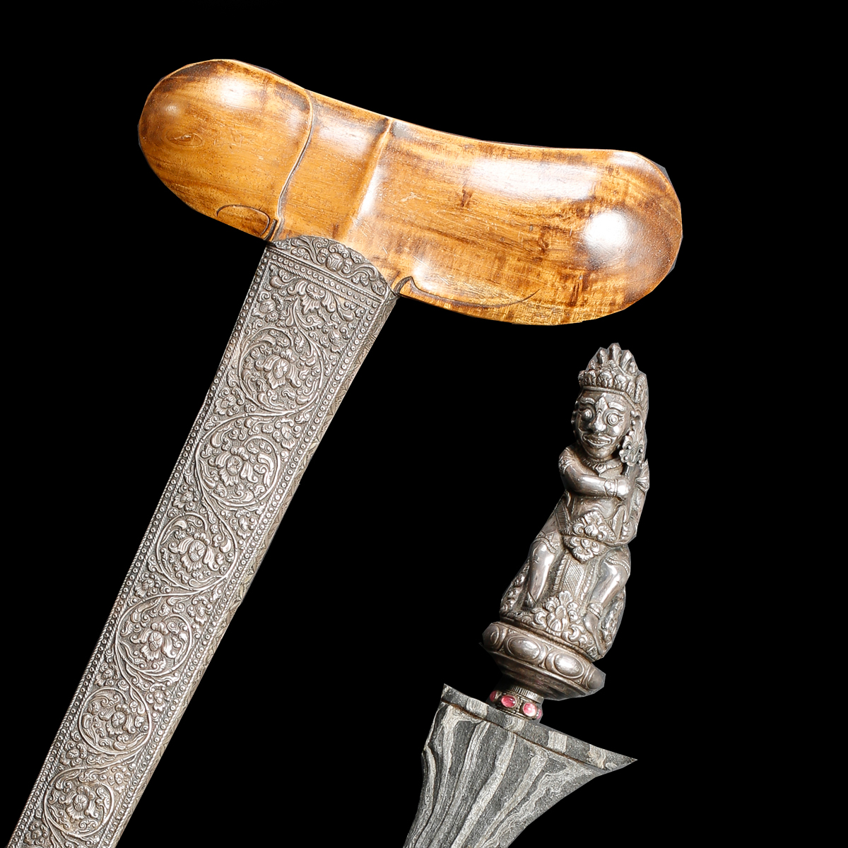

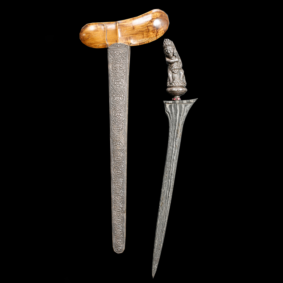

It came with a Balinese dress.
I believe the dress was specifically made for this blade as it is a perfect fit.

Not Tuban, I'd say East Jawa.
