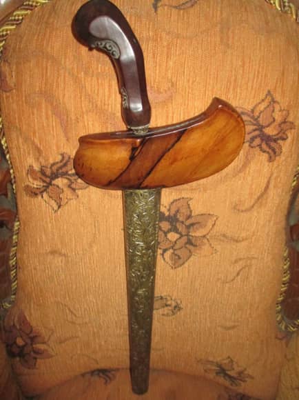

As the title said this is my first post and I would like to have your comments/feedbacks on my first Keris.
I’ve acquired this Keris recently, and these are the description from the seller:
Dhapur: Jalak Dinding

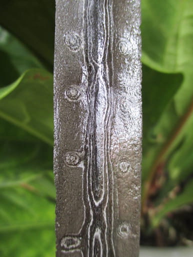

Pamor: Bonang Sarenteng = a string of bonang (musical instrument used in Gamelan)
Tangguh: Mataram Amangkurat (I believe it means 16-17th Century?)

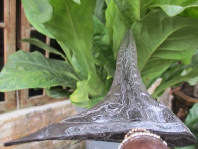

Hi YS and welcome to the forum.
It's a bit difficult to full assess you keris from these photos. Firstly photos are not the best way to assess any keris and in hand a different opinion might be formed. But you have not provided a good over all photos shot from directly above so it is possible to make some mistakes regarding dhapur. But what you were told might well be correct.
As far as tangguh is concerned, the first thing to know is that it is an estimated that you keris fits into a specific style that was known to be in fashion in a particular time period, but tangguh should never be taken as an indication of actual age. Old styles are sometimes copied at later dates to to place a blade on a timeline based upon a determined tangguh can be problematic. Unfortunately many of the indicators for judging tangguh cannot be drawn from a photograph alone and the blade really needs to be held and examined in person for a better assessment. My own thoughts here is that this blade is not nearly as old as you have been lead to believe.
This seems like a nice blade and the pamor seems fairly well executed. If it were mine the one thing i would do is to swap out that old mendak that is missing its stones with a nice quality new one. This blade deserves that.

A very nice keris YS.
Amangkurat covers the period from approximately death of Sultan Agung through to establishment of Kartosuro, so in very broad terms 1645 to 1680, and running forward in time, not back. However, as David has pointed out, although a keris may be stylistically of some particular tangguh (classification), that does not necessarily mean that it can with any certainty be attributed to the time period referenced by that tangguh. It is usually not possible to be too definite about tangguh when using photos to judge.
Dhapur might be able to be given as Jalak Dinding, but again from a photo quite difficult to be certain, particularly with an older blade.
In any case, this is a really superior keris for a "first keris", really nice.
Apart from the missing stones, this mendak looks pretty good, probably silver I'd guess. I would not replace it, but repair it. If you are in Indonesia this should be easy for you to arrange, if not, well, we'll go another way.

While i appreciate good sunggingan dress i would like to suggest that you take a second look at the wrongko you currently have for this keris. Personally i find this wide diagonal kendit on this wrongko quite attractive. If it were mine i believe i would restore the mendak and leave the rest along.
Since you seem more interested in antique sunggingan why not seek out a keris already wearing such dress? I think you might be more likely to find antique sunggingan dress that is still with its keris than a good quality wrongko without a blade that you can refit well to your present keris blade.
