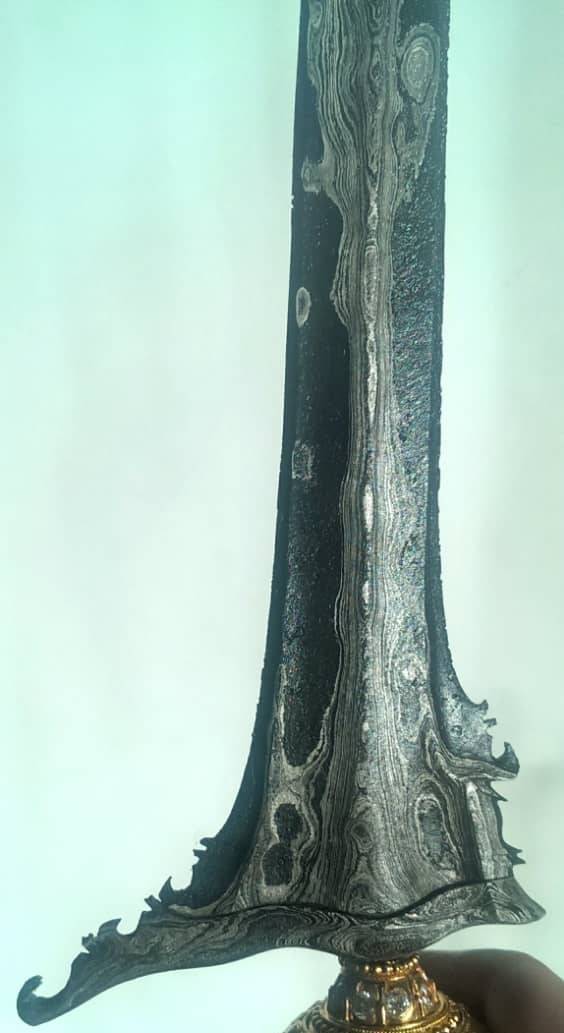

Btw, I got this keris where some friends said it is made from meteorite iron, but I doubt so. It is a new age keris made in the 1980s. I was told by others either it is made from Luwu iron instead.
