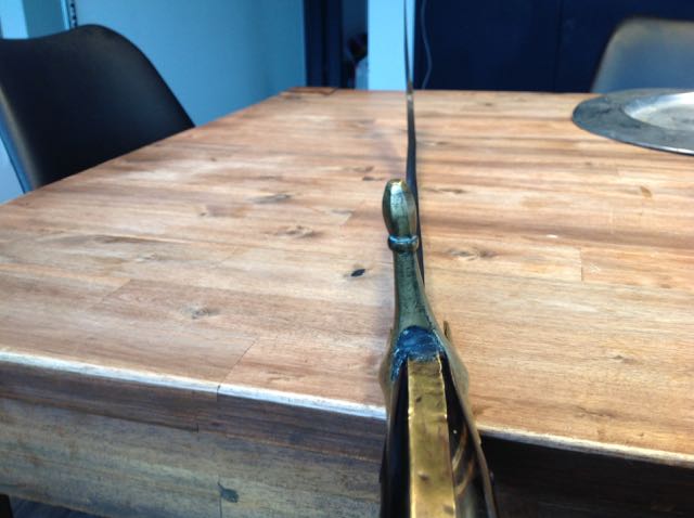

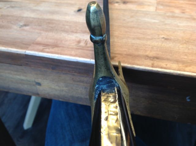

Hello everybody,
what do you think of this turkish sword ?
( pala sword) 18th century ??,
the blade seems nice and authentic ( no stamps or mark)
but the crossguard seems not so old and the repairs on the hilt made without care and maybe a recent work.
composite makeshift job ? ...
Any comment ?

The welding-sticking between the handle and the guard

Francotolin,
I'm not qualified to comment on your sword, but the repair looks dodgy to me. I'm really interested in the mechanics of how your blade, cross-guard and hilt are joined. This type of sword has been considered as a prototype to the Sudanese Kaskara, but I've never had an opportunity to explore the mechanics of it's joining. Also, the date of your sword type could inform when the Kaskara's mechanics could have been adopted.
I assume the cross-guard is cast copper alloy, but its internal shape is basically the same as the Kaskara's 4-piece forge-welded iron construction.Is the bottom of the handle wedged into the top of the guard to hold the blade in place and secure all three parts together? Also, it looks like there is a pin in the handle that would attach the handle to the blades tang.

I do not think it is welding: one cannot weld anything to the cowhorn.
Modern adhesives ? Epoxy?
Old 7th November 2018, 12:43 AM   #5
Posts: 7,422
From what I can tell I agree with Ariel - epoxy and the cross guard is made of bronze.

Hello and thank you all for your really precious comments !
I was thinking of welding because this stuff is dropped too on the brass side of the hilt maybe to seal everything together...
but it must be epoxy.
Bad work ...
Thank you and Kind regards !!!

Specifically, that appears to be JB Weld. I HATE JB Weld for reasons like this. Whoever did the repair meant well, but used the worst stuff possible.
You can see some here where someone attempted to repair worm damage to a percussion rifle.
It's very difficult to remove.

The only way to remove epoxy is to use Dremel. From time to time I see silver Ottoman crossguards on eBay. But yours has langets that fit the slots on the handle, and a new one will likely not. Stay with what you have.
For a complete restoration you will also need to find or fashion new tear-drop eyelets on the pommel. Much more difficult to accomplish than buying a Dremel tool .
Or just make peace with kisses of time.

This sword is perfect, just remove the bad epoxy repair.
The cross guard is original to me, many Turkish swords have brass cross guards.
Good catch

Heat will break the epoxy down, if you can first dismount the hilt by driving the pin. I'm not suggesting you should, just that's how it can be done.

Well, sure, and after that face reassembly of the hilt, fashioning contemporaneous mastique, reattaching the tang band, and then go back to square one: how to re-attach the crossguard. Looks to me like scratching your right ear with your left big toe.
Get yourself a Dremel and spend 15 minutes freeing the crossguard and removing all traces of epoxy. Buy this:
https://www.mscdirect.com/browse/tnpla/00260042?cid=ppc-google-New+-+Tapes+%26+Adhesives+-+PLA_sBsWHaKq7___164110845012_c_S&mkwid=sBsWHaKq7| dc&pcrid=164110845012&rd=k&product_id=00260042&gcl id=EAIaIQobChMIyNu9rPXD3gIVxMDACh25AQj2EAQYBSABEgJ GS_D_BwE
Devcon steel epoxy. Apply thin layer of the mixture to the sites of metal-to metal contact You will have to use literally microscopic amounts of it, with no oozing outside the borders and the strongest bond available: it is used industrially and , when hardened, can even be machined. If you overfill the bonding surfaces and the epoxy becomes visible, then, when it is still soft, just wipe the undesireable traces off with cotton wool wetted gently with alcohol. Hold together tight for 15 minutes, then let it cure for 24 hours.
Overall, piece of cake.

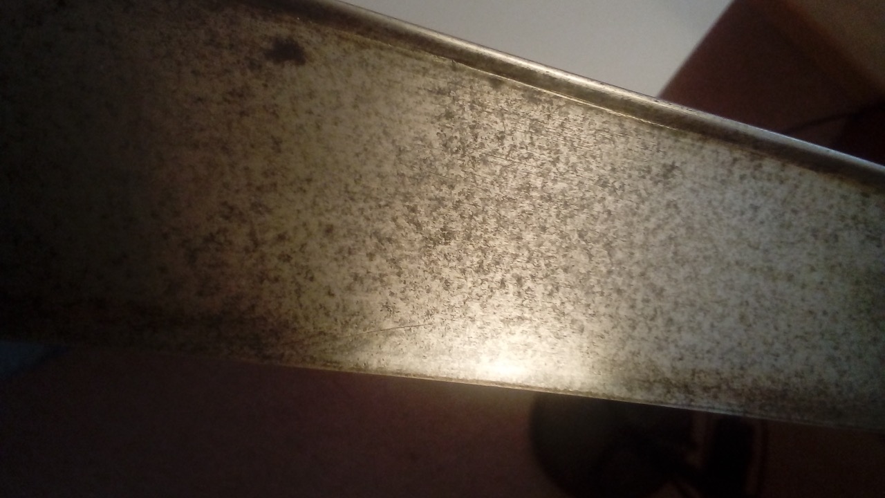

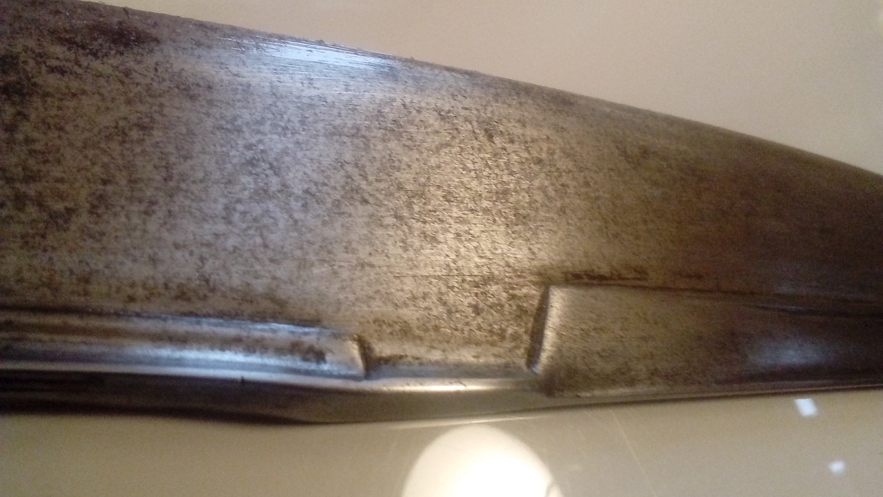

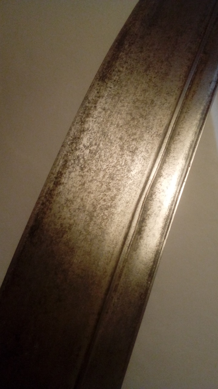

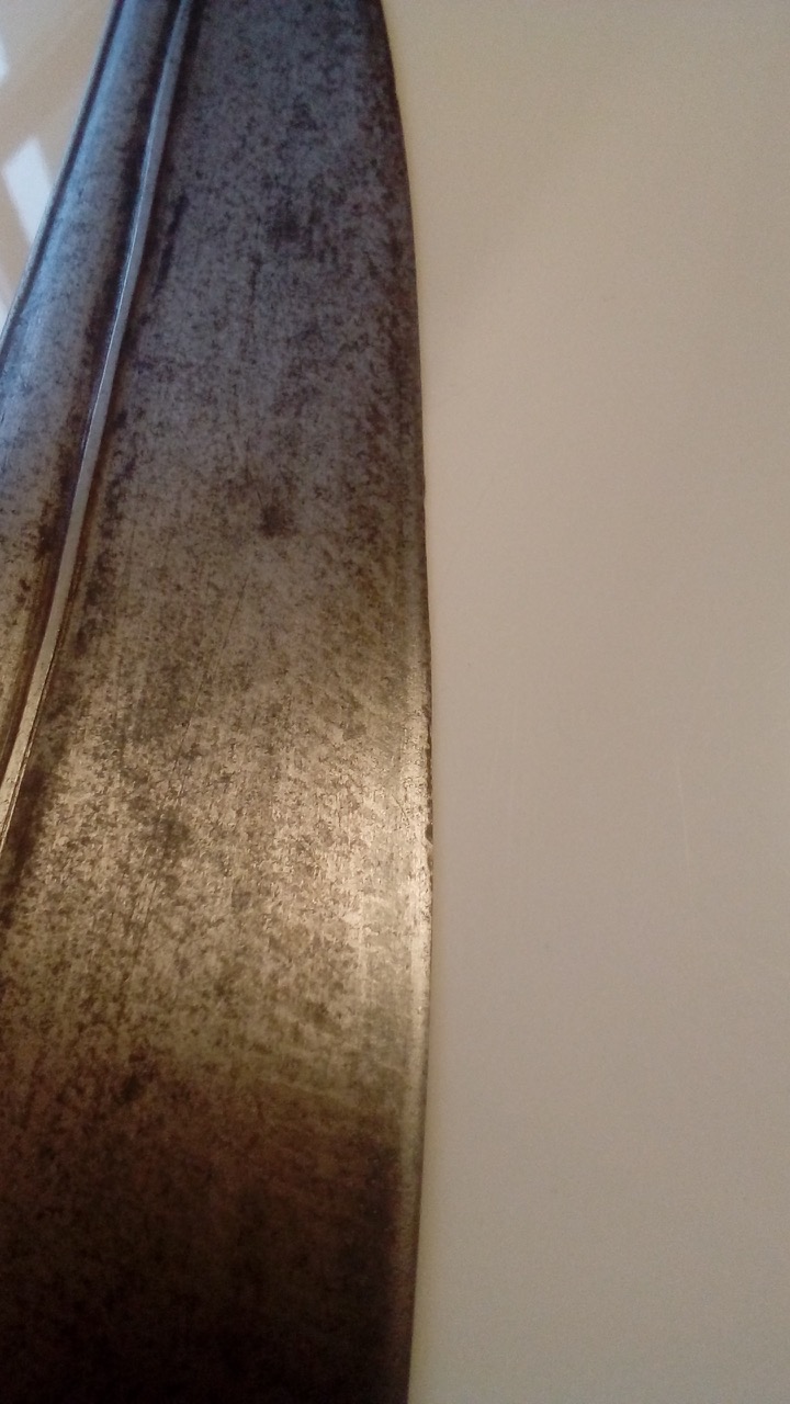

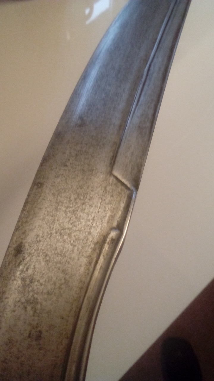

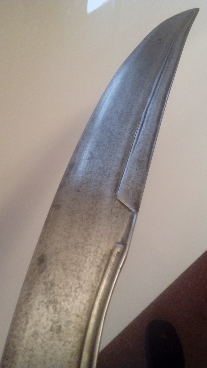

Hello everybody,
I cleaned the blade with bicarbonate first
( remove some rust ) and then with white vinegar ( gently etched. !?!.. )
it turned deeper and has a lot of contrasts,
but no pattern ..
Do you think it's wootz steel ?
( I read about dendritic wootz but ?...)
Old 30th May 2023, 01:52 PM   #20
serdar
serdar's Avatar
Join Date: Feb 2023
Posts: 254
It may be some kind of crucible steel.
Ottoman guards were secured using resins, in higher and lower concentrations of powdered substances adeto resin.
But one thing many people take wrong, pala is a straighter sword with upswept hilt and bird like nandle like karabela.
19 century kilij is not pala, kilij has evolved over time 16 ct example is more staighter and longer, 19 ct is shorter and more curved and suited for foot use.
But pala is a shorter, broader blade almost straight just slightli curved.
