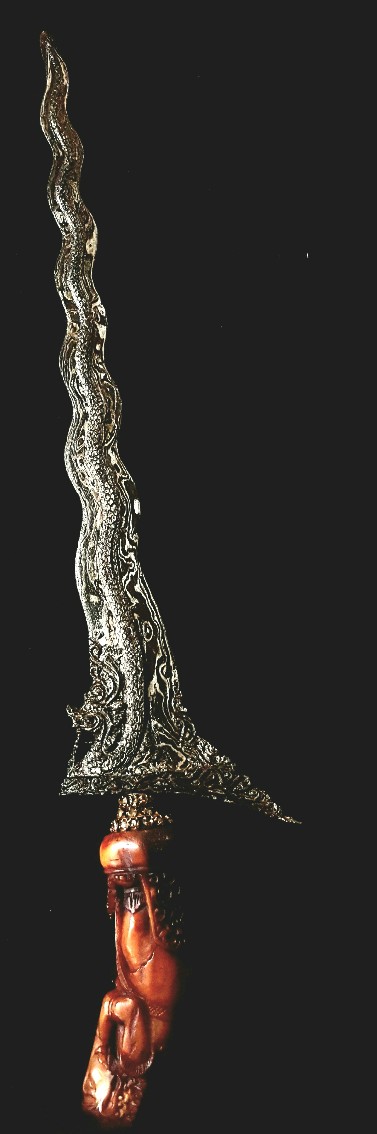

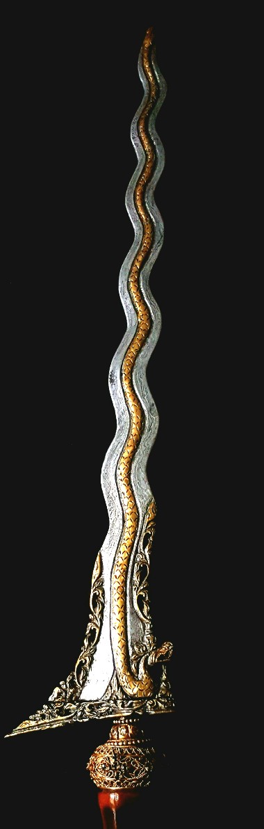

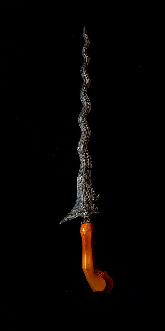

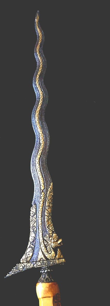

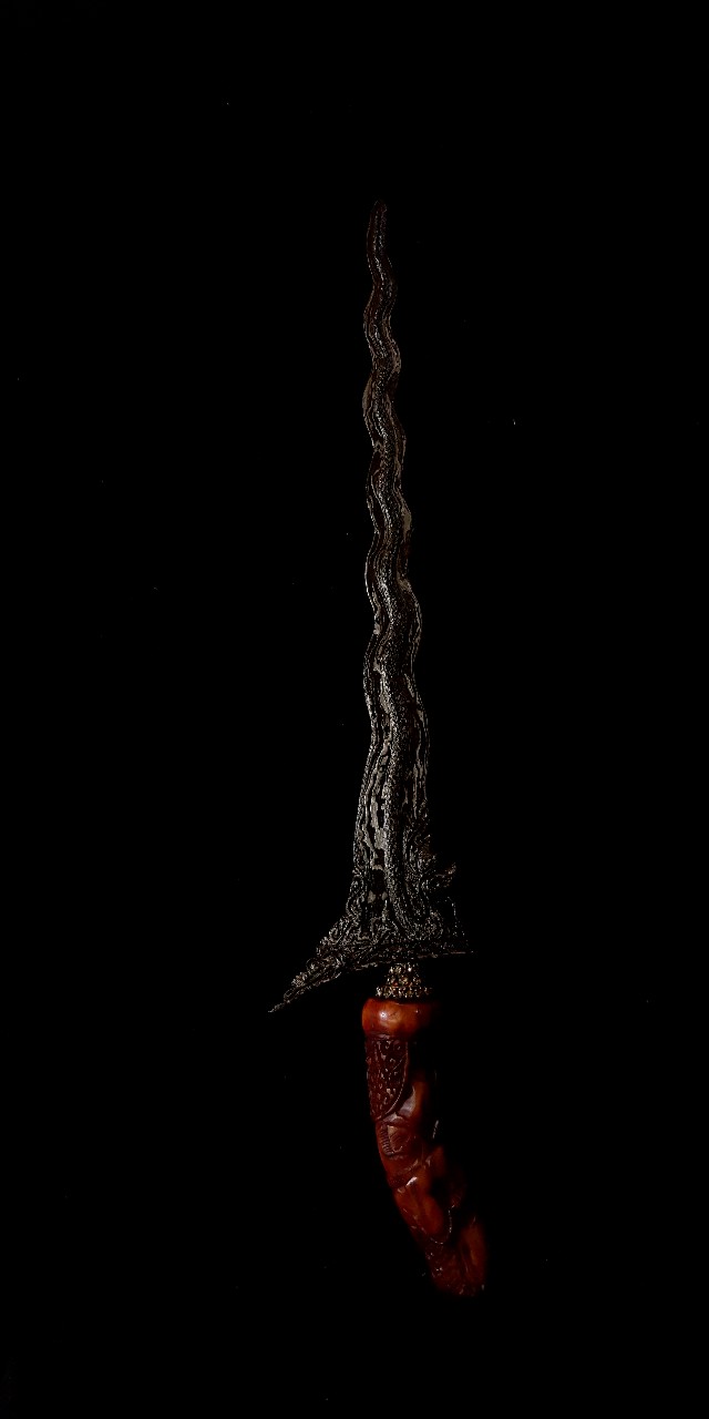

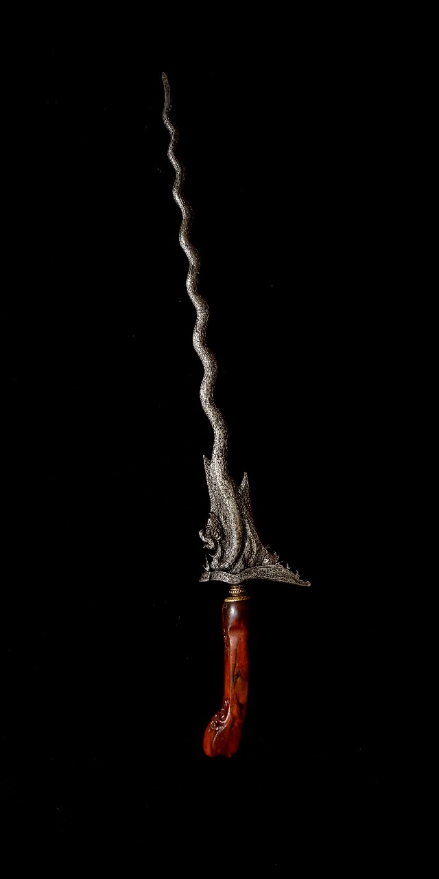

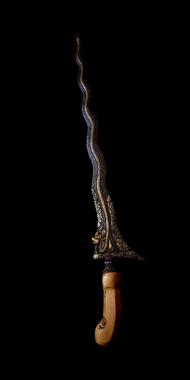

Hi Forum.
I really need your advice and comment. Which one of those keris with gandik Naga ornament is fake(not old keris)?
Thank you all

As Rick suggested in another thread, we need better photgraphs.
Also, i would not use the word "fake" to describe newer keris unless they are being presented to you as antiques. Even then the intention of the maker probably was not to create a "fake".
Owh ya..sorry for the picture David. I'll soon post more clear picture. Amd forgive me to use a word 'fake'. Is that any suggestion how to edit the titlle and my post?.if its a way to edit,i'll change it. Thank you so much for your attention.
Regards.

Instead of fake, may I suggest that you make your question more concrete, e.g. which of these keris are kemardikan? Or which of these keris are older than the 19th century?

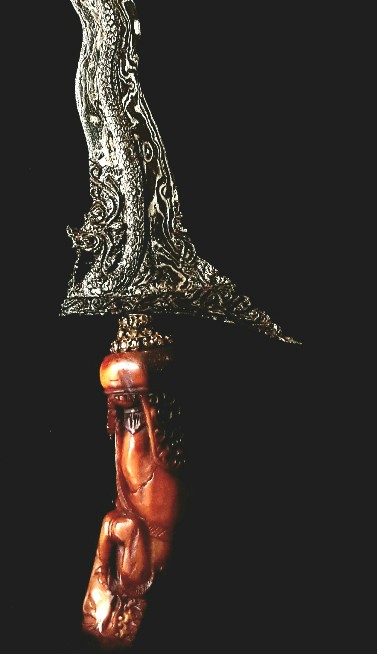

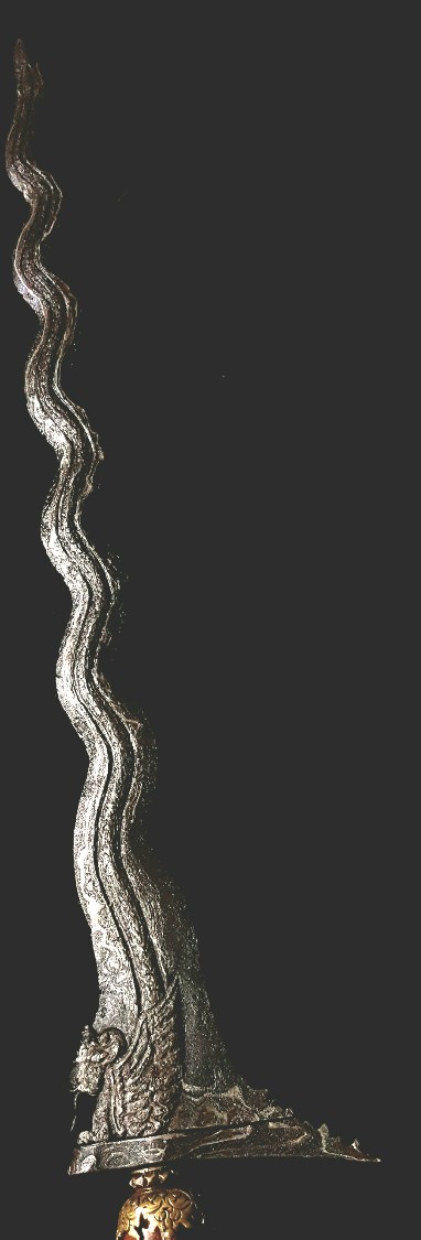

I make a litlle change to the picture. I know its not perfect enough,but i hope the new pict can give Rick more clear about the keris. I really want to take another picture with new angle and lighting soon.
Thank you for your kind.

Ridho, I'm not brave enough to jump in and declare that something in a picture on a screen is not old. By "old", I'm thinking in terms of pre-WWII.
But I will say this:- I have not seen, nor handled any keris that I knew to pre-date WWII that looked anything like any of these keris.
I began really looking at keris about 65 years ago, during that period I have handled literally thousands of keris, including many with genuine provenance that went back in some cases to pre-1700. No keris that I knew to pre-date WWII looked anything at all like any of these keris.

I think using a neutral gray and not a black background will make things clearer; also photos taken in outside light will much improve things.

Ridho, I do appreciate that you are trying to come to terms with a way in which to estimate blade age, but to the best of my knowledge there is no simple way or quick way or short way of doing this. It is not a matter of just looking what we can see in a picture, nor is it a matter of looking at what we can see with the blade in hand. I have handled more than a few pre-1700 blades in European museum collections, and many of those blades look as if they came off the work bench yesterday, mix them in with some kemardikan blades made in conventional forms and it would be more than a little bit difficult to say which are old and which are new.
There is no formula you can use.
According to traditional belief, some blades will have a greater or lesser number of layers that can be counted on either side of the core, however, how useful is this as an indicator when we know that we are looking at blades with varying levels or erosion?
About the only useful indicator that concerns layering of material in a blade, that I know is that Pajajaran blades often have the pamor layer very slightly separated from the layer beneath it, this is easy to see under magnification, but sometimes difficult to see without magnification.
There is a lot of belief that concerns iron types, supposed differences in forging , and differences in construction, in my opinion, most of this belief is simply that:- belief.
Learn the basics first, then learn how to actually make a blade, I do not mean theory from a book, I mean with a hammer in your hand, and then using chisels and other tools that you have made yourself. When you have done this, and you have many years of experience, you may have some chance of being able to estimate how old a blade is, and how to classify it.
Imagined differences in forge techniques will not help you at all.
When we build up layers of iron, or layers of iron and nickel, and then we polish that layered material it can be very difficult sometimes to see the layers, but if we then cause erosion of that layered surface we can see the layers easily, this is true of both newly forged material and old material.
If we begin the layering process with thick material we get thick layers, if with thin material, thin layers.
Within the tangguh system there are some indicators that do address number and thickness of material layers, but these indicators can only be used in combination with all the other indicators, never as stand alone indicators. As already mentioned, tangguh equates to classification, not necessarily age.

Yes Rick, I agree 100%.
Neutral grey back cloth, natural light in open shade, light from the south in the Southern Hemisphere, from the north in the Northern Hemisphere, bounce boards to throw light as compensation for the shade, avoid big apertures, maybe 3 or 4 F stops smaller than biggest aperture, tripod and time release or remote release if possible.
Alternatively, full auto with the flash deactivated and full natural light, avoid direct sunlight. With a point and shoot this will normally give something usable.
As a minimum, in processing:- resize for net use, remove cyan,sharpen (unsharp mask)
