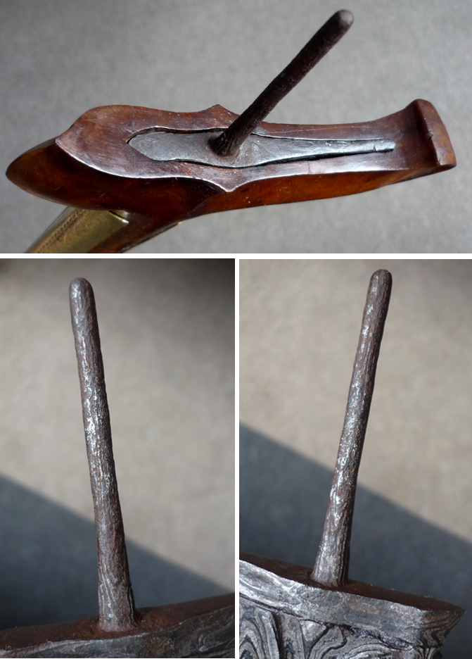

Looking closely at your photos of the gonjo area, it appears that the gonjo might be held in place with adhesive rather than by a metal to metal fit.
Is this so?

As far as I can see it is metal to metal fit.

Paul, you have it in your hand, I only have photos, but it looks to me as if there is an adhesive between the blade base and the gonjo base, and that there is also adhesive between the gonjo and the tang. The adhesive that is commonly used to fill these areas is normally a two part resin such as Araldite, mixed with iron filings or black artists colour.
We normally test if adhesive exists, with a needle, sometimes it is necessary to heat the needle.
This adhesive fill is common, even usual, for a very old or worn blade, it has been used in Jawa since two part resin became available ---1950's? --- its purpose in an old blade is to prevent further deterioration, and in an old, worn blade it is regarded as quite acceptable.
However, since about 1980-'82, it has also been used by some new makers as a shortcut to fix the gonjo. This blade of yours is not old, I cannot see a key used in the gonjo fit, the other acceptable way of fitting a gonjo if no key is used , is to work around the pesi and tighten the gonjo metal with a hammer and punch, this is easier and faster than using the key method, but it normally leaves punch marks on top of the gonjo and around the pesi. In the photo I cannot see these punch marks.
Because I cannot see the expected evidence of a metal to metal fit, my suspicion is that adhesive was used to fit the gonjo. If you have tested as I outlined, and there is no adhesive, then I still have no idea of exactly where this blade might come from. However, if there is adhesive, and especially if that adhesive is between the pesi and the tang, then this blade is most probably a recent Madura production, say, within the last 40 years.

Thanks, I tested it with a red heat needle and just some old dirt came out. With a magnifying glass I saw the metal to metal contact.
