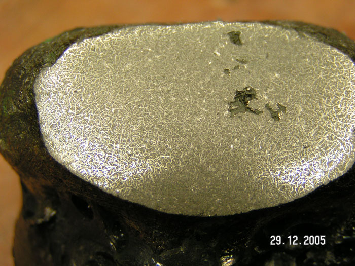

To add a bit to what Puff said, regarding bubbles:
I said 'air', but really it's carbon monoxide or oxygen, and they occur for a variety of reasons - undercooked ingots mostly (the melt has not reached equilibrium), but since liquid steel can hold more gasses in solution than solid steel, you can find porosity occuring during solidification too.
Regarding cracking, it can occur from working at too high or too low a temperature, or pushing the material too fast - the as-solidified grain stucture needs to be coaxed into a finer, more forgeable state. Impurities in the steel (oxygen, sulfur, phosphorus etc.) will precipitate out at grain boundaries during solidification, and can cause cracking too.
Forging temps for wootz are not high enough for cracks to get welded back together, so they don't go away. As Puff said, "Any flaw appear during forging stage can be easily work around by either trimming out or shortening the piece", and that's how those one-sword ingots get to be multiple-knife ingots.
I have some ingot slices that demonstrate most of the flaws you can run across, here's one ingot with some probable CO bubbles - cube is 1 cm for scale:
This ingot also suffered from too much intergranular oxygen and proved to be unworkable, after a lot of work!

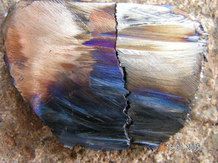

galvano
galvano's Avatar
Posts: 178
Default ingots
Here two ingots.
One with bubbles.
One with cracks. galvano.

Old 10th April 2006, 06:34 PM   #21
galvano
galvano's Avatar
Posts: 178
Default jeff pringle
it is not a artéfact.
Surface was attacked with ferric chloride.
galvano

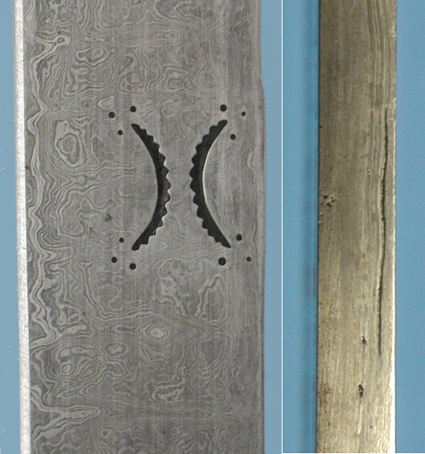

Smile Not A Threadjack But A Nagging Question
While we're discussing wootz ; I would like to dredge up a subject from the forum's past .
Once there was shown a sword with one side showing an active wootz pattern ; oddly enough though on the obverse the steel showed no pattern at all .
Any ideas on how this could have happened Jeff , or any other of our smiths ?

I see what you mean Jeff. How deep is a crack? If it is not too deep, you could make the blade a bit broader and grind the crack away – or is this solution too easy?
Interesting subject you bring forward Brian. I know tulwars exists having two different wootz patterns, one on each side, or wootz one side and steel without pattern on the other, but if it was possible to sandwich two half’s of a blade together, why does the cracks give so big problems? The wootz should be worked, like Puff writes, at cherry colour at about 800 C, and I understand it is rather difficult to work the wootz at such a low temperature. A higher temperature would make it easier, and also possible to remove the crack, but then the wootz pattern would have gone. I have a feeling that I am missing something – but what?
The attached picture is from a tulwar, I know it is not wootz, but have a look at the picture to the right – what is this, is it a crack or is it a scarf weld?
Old 12th April 2006, 03:59 PM   #30
Jeff Pringle
Jeff Pringle's Avatar
Join Date: Nov 2005
Posts: 189
That looks like a weld flaw - when doing layered damascus, it's easy to get small areas (or large areas ) that don't join up, that's what they look like in the finished product. If it was a crack, the 'texture' would be different, if a scarf weld, it would be going across the layers at an angle.
The missing bit of info might be that attempting to work wootz at welding temp results in more cracks, turning the ingot into something that reminds smiths of cottage cheese. It's not that the pattern goes away, the whole buiscut crumbles.
Which is interesting, because there are obvious examples of two ingots welded & turned into a sword and scarf welds joining two halves of a wootz blade as B.I. points out - this has mystified western smiths for hundreds of years. Obviously, they had a different way of welding than modern smiths are used to.
So the ways of getting non-patterned areas on wootz are -
- weld wootz to non-patterned steel, this should show a seam down the back/near the edge
- some methods of working wootz give it a decarburized outer layer which needs to be sanded off before the metal will show it's pattern - this usually shows up in patches, though - you'd have to be a very forgetful smith to leave an entire side of a blade in this condition
- obviously, sanding can remove the pattern, but re-etching should bring it back - that'd be the first thing I'd look at if a blade had one sided wootz and no visible seam on the back.
Here is a small test I did - wootz sides welded to 1070 commercial steel - the lower line is the weld zone, the upper line is the transition between hardended and unhardened metal - note the wootz pattern dissappeared in the hardened area. this method of pattern removal would be impossible to do on the side-to-side of a blade, but could happen on a top-to-bottom direction.
