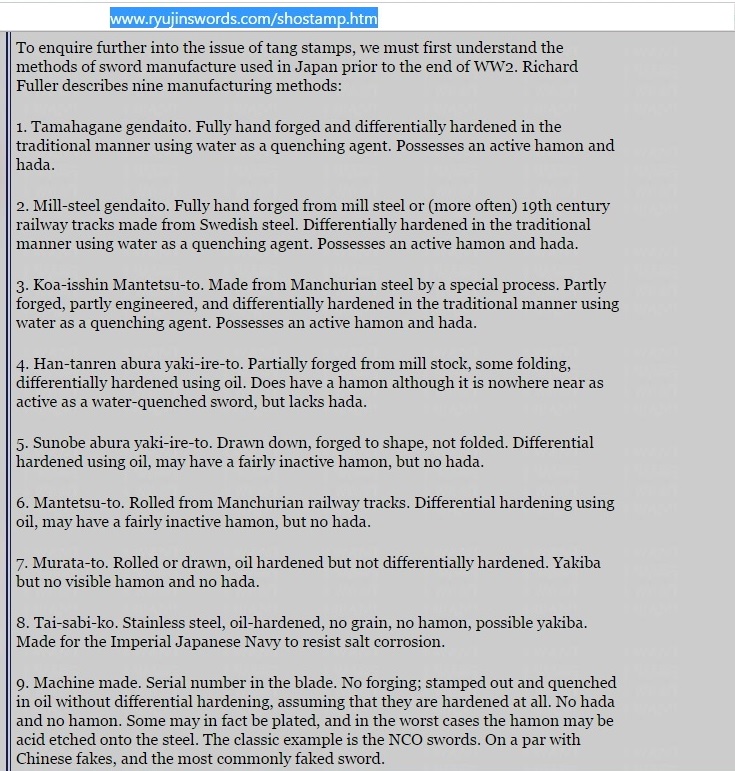

Not all WW2 blades had a hamon. NCO blades were plain tempered steel, and more than one signing smith made the same for officers Shin-Gunto. It's a very complicated subject. Patina on the nakago can be removed by over-cleaning. I would like to see pictures of the mounts as that can be a clue. I would take this over to one of the specialist pages like Nihonto Message board or warrelics.eu where there is a bigger pool of knowledge.

Not all WW2 blades had a hamon. NCO blades were plain tempered steel, and more than one signing smith made the same for officers Shin-Gunto. It's a very complicated subject. ...
Thanks Dave. Indeed, a complicated subject.

My mate has come up with the same list that David has shown us, and has formed the opinion that he has something that is probably the same as #8 on that list.
