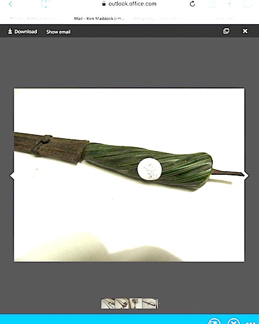

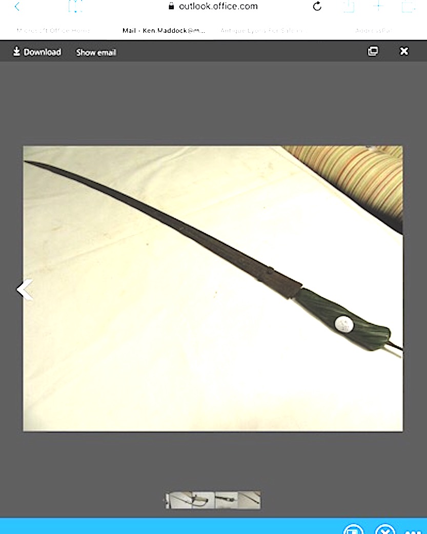

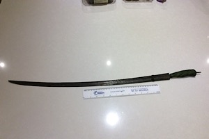

Hi All
Not much to go on I know
I will have item in a week or so and I have no info other than images I have put here
It is the green handled sword I am wondering about, looks like some sort of stone material on the handle
the spdroon looks nice as well, and the British sword should subsidize the price of the other two swords quiet well, I have put these to give idea of scale.
Anyone know what I have, ethnic or European I do not know
Any information much appreciated as always
Ken

Bizarre; isn't the (whatever) blade inside its sheath ?

Posts: 1,161
Green dyed Ivory grip, and a very battered 18th C. hunting sword??

Yes Fernando it looks as if the sword is in a scabard, I decided not to mention this to see if others taught the same.
Dyed Ivory was that a well known adaptation? I never heard of it, bu5 I don’t know a lot about a lot of things.

It does look like there are remnants of a scabbard but it is difficult to be sure. Dyed ivory is indeed a well known form of embellishment but not common.

Posts: 2,229
Just repeating and confirming what others have already said...18th century hanger, possibly English, French or American, dyed green ivory was in vogue mid/late 18th c., your piece appears to be missing its cross-guard and pommel cap, but need better pics. And yes, it appears to be stuck in its scabbard. Not an uncommon conundrum, unfortunately. Most of these were hunting pieces, but they were also popular with infantry and naval officers.

If that is the tang of the blade sticking way out, it may be a composite. It also seems to be missing a guard of any type.

I tried enhancing the pictures you posted, and the handle is a bit more visible in one of them.

That tang extension may have been for a missing pommel, possibly a lion or an eagle shape, as well as for holding the missing guard piece(s). the green grip may be a bit further forward that it was when the guard piece was there.

I'm relatively sure, that this is a so called "Jagdplaute", a German slightly curved hunting sword.
Please try this search and you will find more of them:
https://www.google.de/search?q=jagdp...w=1600&bih=864
or this link (only in German): http://www.zietenhusar.wg.am/jagdplaute/

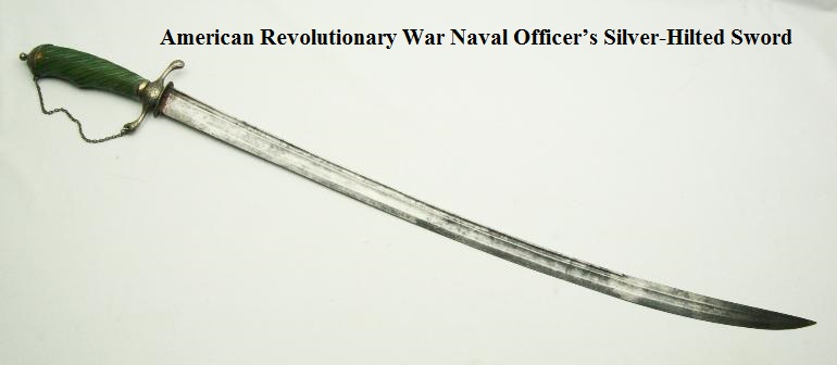

But there is another possibility, it could be an American revolutionary war naval officer's sword. https://www.google.de/search?q=ameri...=1521459846789
In my opinion it is quite unusual for a military sword.
Roland

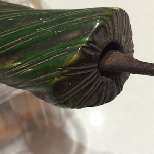

Posts: 6,421
I've got a suspicion that the Ivory is in fact a piece of Narwhal tusk.

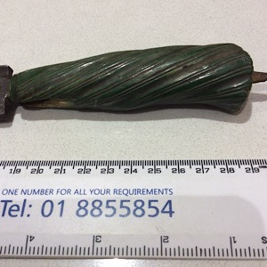

Hi All
Swords arrived

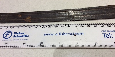

Here are some better images of my sword

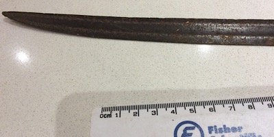

Length of blade is 75 cm
Handle is a further 11 cm
Blade has no markings but some very nice fuller work and is in good enough condition

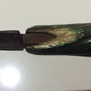

There is a bit missing from the handle so I can see inside
If it is narwhal or ivory or bone I do not known.
Has anyone got any opinion.It definitely does look like the sword Roland put up I put it closer to the American sword than the German one though?

Posts: 785
The thin lines going round the grip look manmade to me so I would guess it’s made from bone. See how those thin lines have been extended to the short side where the pommel would have been attached. May have been made to imitate narwal to keep costs down? Otherwise it could be narwal with decorative lines added by a craftsman.

I still stick with an English hanger, bone handle with green dye.

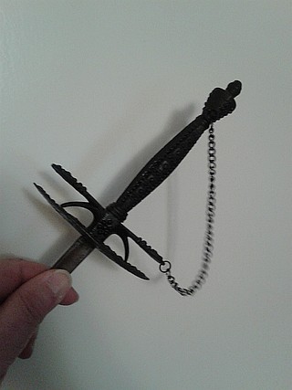

Thank you for the link to the excellent thread. Must be many threads like that lurking in the forum. I wish they were filed by topic but here the search function is very useful.

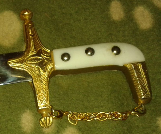

Does anyone know what that little chain on the American Revolutionary sword attaching the guard to the pommel is for? I can’t imagine its purpose is to protect the knuckle as it’s far too delicate. Could it be to prevent the wearer from dropping the sword (which would be especially annoying at sea where it might disappear under the waves forever!) like some portepee? Some Hungarian hussar sabres from the second half of the 17thC also have this feature.
Old 24th March 2018, 11:07 AM   #22
Posts: 4,285
Arabian swords, english mourning swords, and as you see, hunting swords, hangers, and others without knuckle guards can also. I favour the retention option. many still have sword knots...
