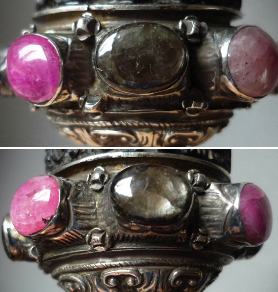

Originally Posted by Paul B.
Any idea about the semi-precious cabochon stones involved in the selut?
Well Paul, when you ask about age that was a red flag for me. Are they black in color. They look like they might be diopside which is not a stone i can see i have seen used on Bali hilts that are truly old. As Jean suggested the selut could be a newer addition, but it does make me suspicious of the age of the entire piece ash the color of the ivory does look dyed to me. Also the other diamond-like stones seem an unusual cut for older Balinese work.
The cabochon stones may be from black obsidian (volcano glass) which is used in Indonesia AFAIK but they are not suitable for a traditional Balinese selut indeed.
Yes Jean, could also be obsidian. While i have not seen similar stones used on older seluts i wonder why you suggest they are not "suitable".
Don't these look like low-quality black sapphires? (Basically with irregular layers of needles inside rather than clear or star sapphires?)

Obsidian seems not the case...shiny and pitchblack but not semi-translucent like the depicted uwer stones.
This is another probably similar cabochon stone and low quality sapphire is a good guess Kai. Optional: smokey quartz but tends to be more brownish.

These stones, both black and red, were very popular in Balinese silver jewellery from the early 1970's through to the mid-1980's. That is the time span I can vouch for, but they might have been used before the 1970's, have not seen the black stones like these in verifiable pre-WWII work. I think these stones are both still used, but not nearly as often as they used to be. During the 1970' -1980's the black stones were very prevalent. They used to call them black sapphires in Bali, something I've always found difficult to accept. Sapphire is corundum, if it is brilliant cut crystal, its a sapphire, if it is a dull black cab it is stuff that missed out on getting ground up and made into W&D paper. If it is a cab with a star, well, that's different. They were cheap stones.
Old 10th February 2018, 09:51 PM   #19
Posts: 7,303
Yes, real black star sapphire is actually a pretty pricey stone. That is why i suggested this might be black diopside, which has a similar look.
What you say here Alan confirms my own suspicions of the age of this hilt, or at least the selut. But the ivory still looks dyed to me and i suspect the entire hilt may well be from about the same period just as you do.
I don't particularly mean this as a criticism. It is still an attractive hilt. However, if indeed it is from this late 20th century period it is less likely to have had as much intention placed on an actual traditional figure than, say, if it where a 19th century piece.

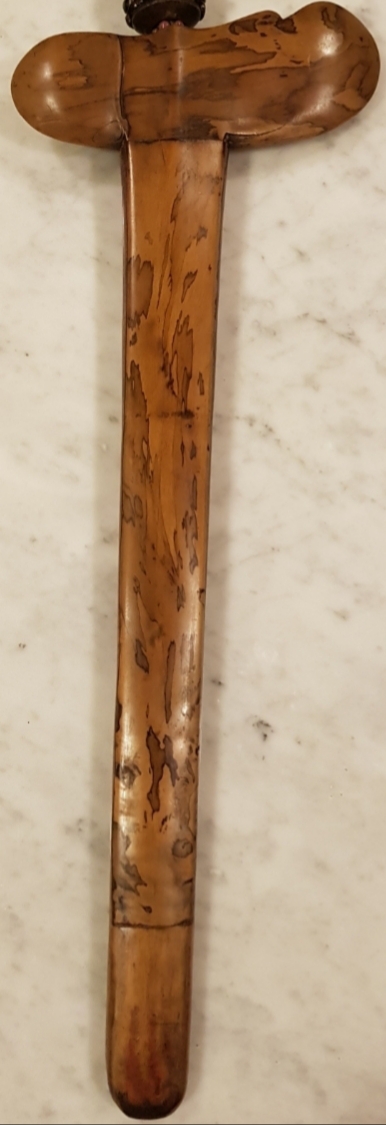

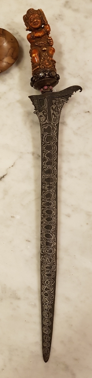

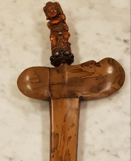

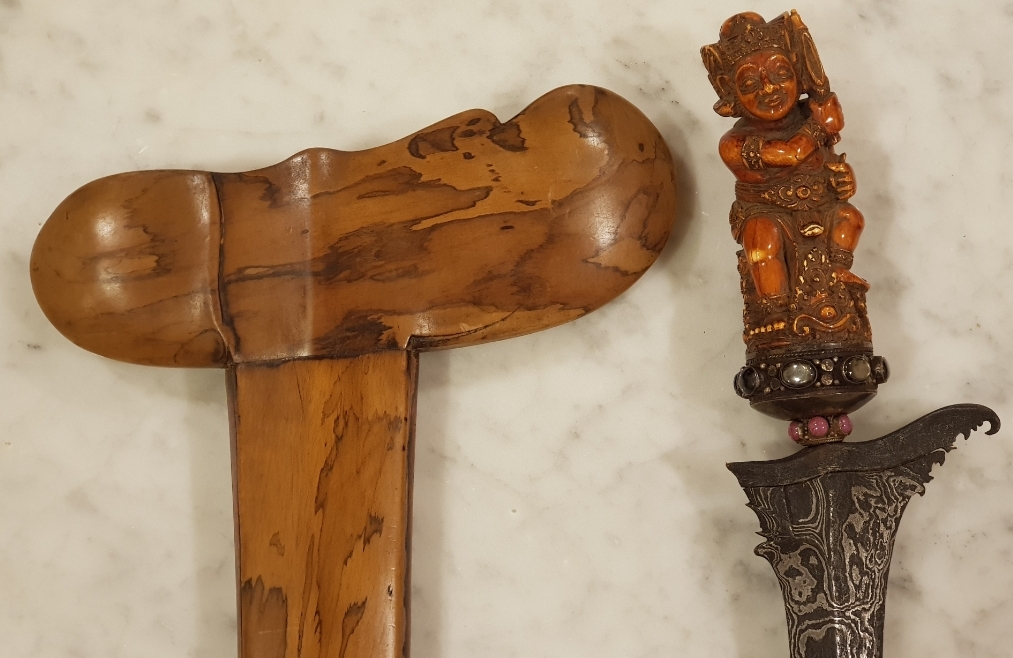

Here are the pics of the kris. Have to work on what I have in the album in my phone. Needed to edit to meet pixel limits. So in sections but hopefully u can visualise the whole kris.

Originally Posted by Paul de Souza
The wood in the sheath doesn't seem to have the pelet effect of older pieces eventhough I was told it is pelet wood.
From what I can see in the pictures, this scabbard, especially the wrangka, is pelet wood.
I will say though that I have heard that pelet wood is becoming endangered and good quality has been hard to come by since the 1990s.
