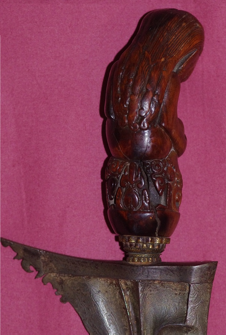

As asked by several of here you here is a subject specially for this keris.
The blade fits well in the sheath even if the ganja exceeds slightly.

I realize that I had forgotten to put the photo of the back of the handle.

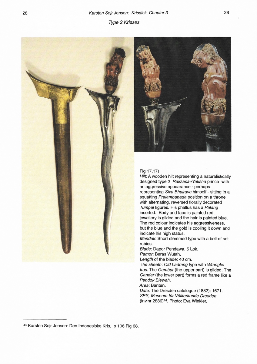

I attach a scanned picture of the kris #2886 in question taken from Jensen's Krisdisk, sorry for the quality.

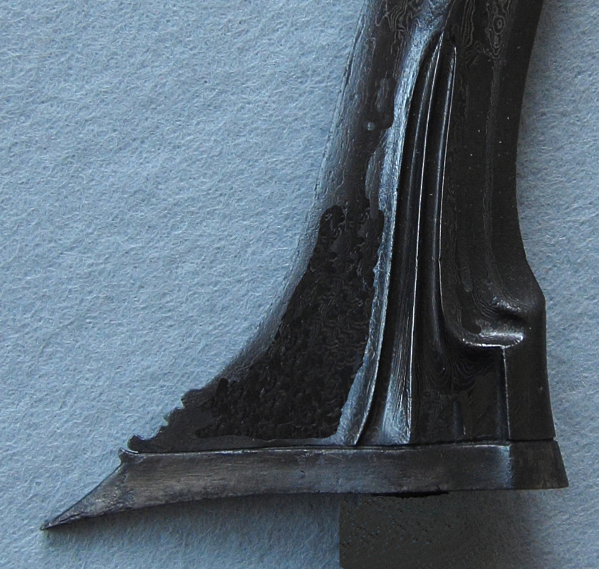

As you now can see the pics of the 2 krisses (from Athanase and Dresden #2886) I would like to initiate a comparison of the blades for your comments:
Both blades have a similar dapur with the following ricikan: smooth gandik, ada-ada, pejetan, long tikel alis & sraweyan (or short kruwingan), double sogokan, and greneng. Jensen calls this dapur pendawa but this is not correct as the blades have no kembang kacang? I cannot check the reference book Dhapur but this particular dapur is not listed in the EK so probably not a Central Java standard. This is not surprising if the blades do not originate from Central Java.
The differences between the 2 blades which I can notice are as follows:
. The Dresden blade has a thingil on the ganja while Ahanase's kris has a full greneng (double rondha). The ganja of the Dresden kris is not standard for a Banten kris and may have been replaced.
. The pejetan of the Dresden blade is slightly boto adeg (brick standing-up) while the pejetan of Athanase's blade is slightly boto rubuh (brick laying down).
. the Dresden blade is more worn and has less visible pamor than Athanase's kris and it may be older (before 1671).
My question is as follows:
Banten is not a recognized tangguh according to the Central Java classification, it was a trading center so the blades from Banten may have originated from elsewhere in Java (I hardly see any differences between the blades from Banten and Blambangan in the Krisdisk for instance). Accordingly it would not be surprising to find some slight differences in the ricikan of these blades.
If the Dresden blade is classified as from Banten (probably the area where it was purchased), and considering the small differences between the 2 blades, is it justified to reject the Banten classification (or at least origin) for Athanase's blade and what is the proposed alternative, Pajajaran? The Pajajaran kingdom was conquered by Banten in 1580 so it probably no longer existed when this blade was made, and the style of greneng of Athanase's blade (deep and sharp) does not match with the style of Pajajaran greneng (shallow) as shown on Alan's sketch. Also the ganja of Athanase's kris is curved on the back side (sebit rontal?) while the ganja of Pajajaran blades are flat and with parallel faces according to Alan' sketch.
For your consideration and comments.

In the case of Athanase's keris I have given the opinion that this keris is classifiable as Pajajaran. It is absolutely certain that this keris was not made during the Pajajaran era, and it is very far from a textbook example of a Pajajaran keris, but it has one major feature that makes it almost impossible to place into any other tangguh classification, and that is the form and proportions of its blumbangan. This blumbangan is relatively large, and it is wider than it is high.
A Mataram blumbangan is almost invariably square; a Surakarta blumbangan is taller than it is wide; a Majapahit blumbangan is similar to a Surakarta blumbangan; Pajajaran has several sub-tangguhs, and the form and size of the blumbangan can differ in these sub-tangguhs. So, if I see a blumbangan similar to the blumbangan that I believe I can see in Athanase's keris, I ask myself:-
"what tangguh classifications do I have to choose from that have a boto rubuh blumbangan?"
Using the major classical Surakarta tangguh classifications I have only Pajajaran, Pengging, and Segaluh, from which to choose. Segaluh is scarce and has a totally different pawakan (overall visual impression) to that of Athanase's keris; Pengging is even more scarce and even more different. The concave front edge of the gandhik in Athanase's keris is very common in a Pajajaran keris. I am left with Pajajaran. Nothing else will fit.
The gonjo on Athanase's keris I decided to disregard entirely as evidence of tangguh, because I believe close examination would reveal it as a replacement; material, and the deviant ron dha are not associated with the body of the wilah.
Why would a gonjo be replaced on a keris that appears to be in very good condition?
It seems to be unreasonable to claim that erosion of the gonjo was so bad that it needed to be replaced, so why replace it?
There are several reasons to replace a gonjo, one of the most common is where the gonjo of a pusaka keris needs to be incorporated into the manufacture of a new keris. Another common reason can be because a keris needs to be fitted to a new wrongko, this can occur because the form of the keris does not permit a harmonious fit to the new gambar, so a new gonjo is made with the curve of the gonjo made to align with the curve of the gambar.
Now the question arises whether we should qualify the Pajajaran opinion. It would be nice if we could.
Personally, I would like to qualify it as Tuban-Pajajaran, but the gulo milir ( the kruwingan work in the lower part of the blade), as well as the nicely cut sogokan do not permit this. This keris is simply too refined to be given as Tuban, even though it does bear some Tuban characteristics. With the replacement gonjo, the pawakan, but not the garap, have a vaguely Mataram trend, and if the blumbangan was square instead of boto rubuh, I would probably give it as Mataram, but without any sub-classification.
So, after looking at the possibilities that are open to me, all I have left on the table is Pajajaran.
My opinion is that Athanase's keris is classifiable as Tangguh Pajajaran.
But since we are dealing here with opinions, I am open to being persuaded to change my opinion.
Now we need to consider the keris identified as Dresden 2886.
In the published photographs of this keris the blumbangan appears to be boto adeg, but in fact it is not. The blumbangan of Dresden 2886 is square.
As already advised I have handled this keris and I have photographed it, but I am unable to publish a photograph of this keris, however, for those who have eyes to see, the photograph in this post will give an accurate representation of the blumbangan of Dresden 2886. It is a Mataram blumbangan.
Note also the concave face of the gandhik of Dresden 2886, a characteristic often associated with Pajajaran, seldom associated with Mataram.
Banten? I think not.
There are other inaccuracies in the published photos of Dresden 2886 also, I do not know how these occurred or why, however, I suspect that the published photos were produced by a professional photographer, and the photographer perhaps thought that a little bit of artistic improvement might be desirable in the finished product.
Herewith my notes made with Dresden 2886 in my hand:-
"L5. Blumbangan is M'ram but body cross section is rotan, shallow kruwingan in the gulo milir, greneng exists but the ron dha nunut is not a recognised form (possibility ron dha nunut damaged by erosion), WW pamor is not fine. Red & black polychrome demon, mendak West Jawa form, wrongko terusan, red & gilt, wrongko original to wilah, gonjo stands proud."
If the notes are read, and the photo is understood, I believe it will be very easy to understand why I can see no real relationship between Athanase's keris and Dresden 2886.
If I compare one keris to another, I need the two keris being compared to be of the same type, not just vaguely similar.
When we use Mr. Jensen as a source of information we need to be very careful of his classifications. He originated a system of keris classification that has the possibility of working quite well for a collector of keris who understands next to nothing about the Javanese belief systems that surround the keris and that form the foundation for a Javanese understanding of the keris. Mr. Jensen was a dedicated collector of the keris, and I have a great deal of respect for his efforts in making information on early keris available to collectors and students of the keris, but not everything that he published can be accepted as accurate.

I would just like to add that the Dresden kris 2886 is deemed to have been collected in Banten from historical records but not necessarily made there indeed.
Old 6th January 2018, 10:23 AM   #29
Posts: 7,188
Jean, I have no doubt at all that Dresden 2886 was collected in Banten, but where it was collected, when it was collected, is really of no interest to me at all.
If it had been collected in New York City in 2017, my comments would be exactly the same.
