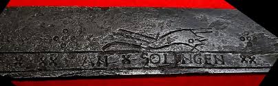

These typically highly stylized chiseled renderings of what are held to be images of a running wolf began in Passau in the 14th century when the use of such a mark was awarded officially to knife makers. Soon it of course expanded to blade makers.
As the blade making industry in Solingen flourished later, it seems that in some cases they produced some blades by contract for Passau shops, and with these they added the now well established wolf mark. As this became more positively associated with quality, it was steadily purloined by other makers outside those circumstances.
These familiar images have often been perceived in earlier years as makers marks or guild marks, but clearly their placement typically was outside those parameters as they became so often used outside such definitions.
Also confounding is the fact that these are individually chiseled in far less than artistic or even distinguishable character, and almost random as none seem to even be the same. This has typically defied the notion that they were applied in the same shop, or by the same maker or worker.

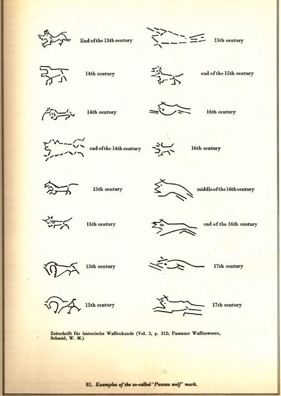

One of the most commonly seen groupings of these running wolf marks is the chart which appeared in "Cut and Thrust Weapons" (Wagner, 1967).
The chart suggests that there is some chronological development of these in their style, however it is my view that these simply reflect the period of blade examples they were drawn from.
These randomly styled images depended on the skill or manner of the person applying them, and are so erratically dissimilar in so many cases, many are completely indistinguishable, often as if placement was simply a token gesture.

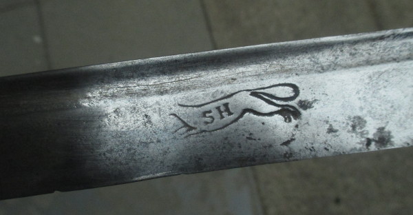

The use of this fox may have been brought about years later in Birmingham England primarily by Samuel Harvey, who used his initials SH on the fox. Other examples of the fox without initials may have been used by John Dawes also of Birmingham.
The idea presumably was to draw on the reputation of Shotley Bridge as well as Hounslow and Solingen with this famed mark of imbued quality, as Birmingham blades earlier were regarded poorly for their defects.

1.) The 'chart' from Wagner (1967)

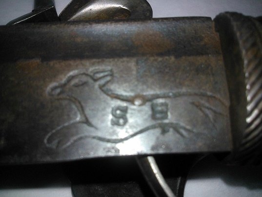

2.) The Samuel Harvey fox c. 1750 ('Birmingham fox')

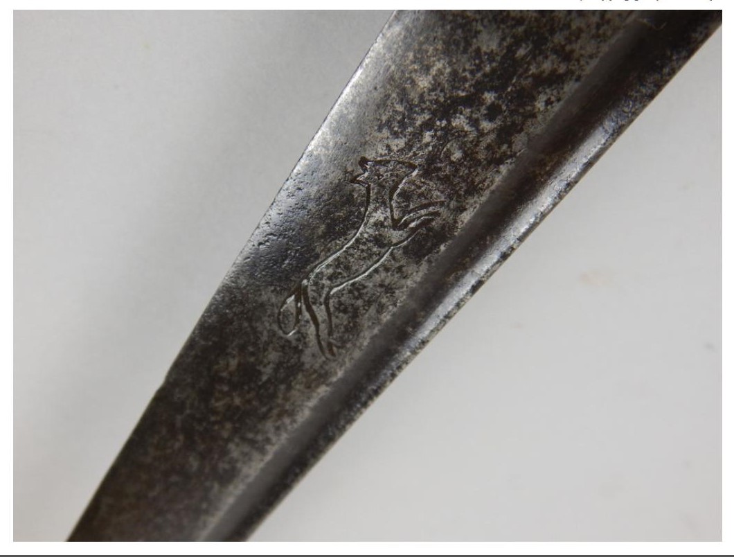

3.) Presumed Shotley Bridge 'fox', note the upside down orientation as seen in German placed running wolf mark. It remains unclear whether or not both types were used at Shotley as examples marked SHOTLEY and BRIDG obverse side and German wolf are known. As seen in fig. (4)

I read with interest your notes on the Shotley Bridge situation and wondered if in fact Shotley Bridge ever produced the Running Fox (bushy tail) or if in fact it was only done at Birmingham. Please see for reference http://www.vikingsword.com/vb/showth...ht=blade+marks
Certainly the Solingen version of the Running Wolf.. (in fact not a stamp but a hammer and chiseled stick like motif) ..was a Shotley Bridge addition; or at least appeared on their swords. Their is some contention even with this since it could be that blades for refinishing were smuggled from Solingen to the Shotley makers by Mohll himself and it is possible they were struck in Solingen previously. It is also entirely feasible that the Running Wolf were done in Shotley Bridge; Solingen being the origin of those swordmakers.
What is clear is the Running Wolf became a mark placed by various schools of sword production and copied by many others in a similar way to Eye lash /Hogs Back marks / ANDREA FERRERA and other classic marks to infer quality. The Running Wolf or Passau Wolf has moved across international boundaries and almost takes on an air of Talismanic proportions.

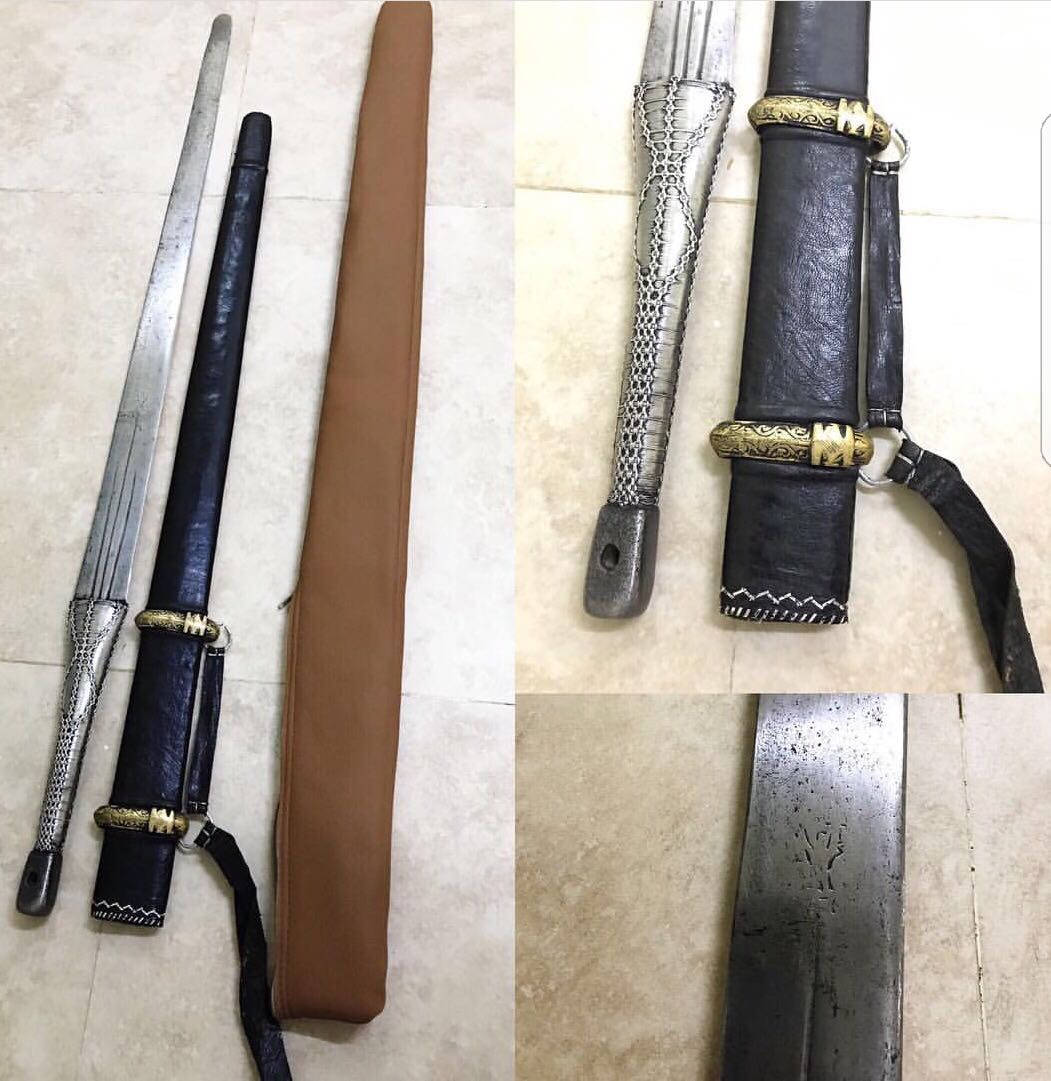

Here is the mark on an Omani Dancing Sword randomly struck and somewhat unrecognizable... I place the Running Fox of Samuel Harvey Birmingham with initials and a Solingen Running Wolf for comparison.

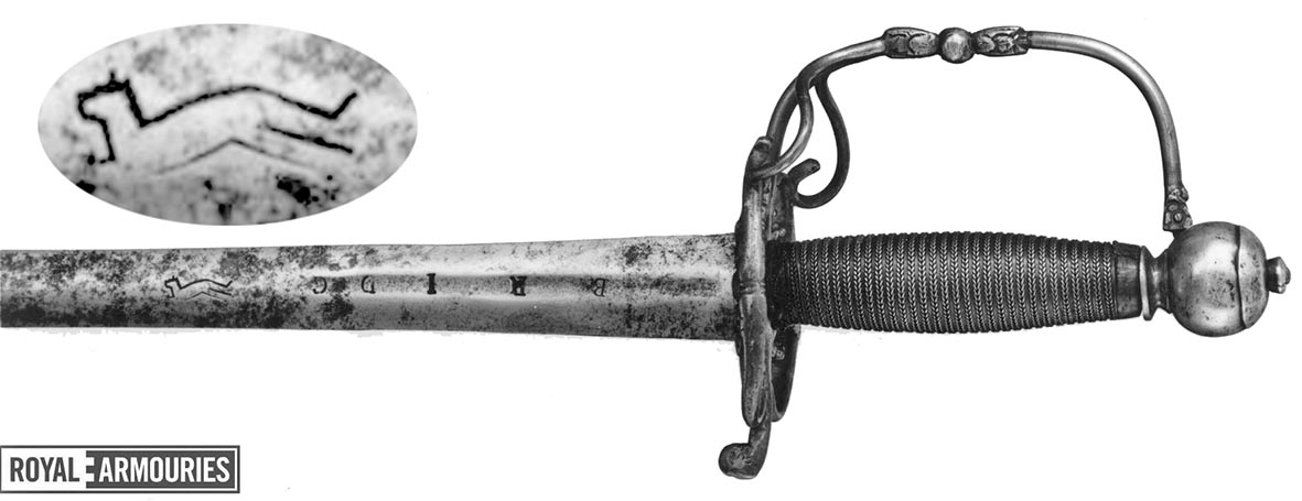

Quote"Sword, highly composite, the steel blade nearly flat with a short fuller near the hilt and stamped on either side with two different blademaker's marks, a running wolf, and the inscription SAHAGOM. The grip silver, octagonal in section, ornamented alternately with scrolls in relief and nielloed designs of: Tarquin and Lucretia, Hero and Leander, Judgement of Paris, etc. The arms of the silver-gilt, S-curved cross are spirally twisted and chased with leaves on the front side only. The cross terminals have been engraved to resemble small quatrefoils. The cross includes an integral collar, decorated with a foliate scroll; the pommel area above the grip (but made in one with it) has been decorated with a band of gilding, the area also decorated with foliage in an attempt to match it to the cross collar."Unquote.
