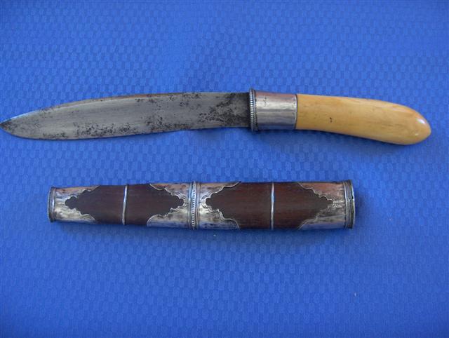

I have attached image of another type of Burmese knife/dha. This one is very solidly made and the hilt is a large piece of ivory. The decorative style is quite different although it comes from the same region. I suspect this is a little older than your piece but wiser folk may care to set me right on this. I have posted a picture of this on the board before.
cheers

I agree, this one is older. Perhaps late 19th century, or early 20th.
I think these are a distinctly different form of knife. Generally, the quality of these are better than the "Shan" knives we were discussing earlier in the thread. These are distinct with the rounded, slightly down-tilted handles, single ferules and tapering scabbards.
I've seen knives of this form reliably attributed to Burma (Burmese writing along with silver koftgari on the blade). Enough that I'd suggest this form is Burman.
However, others, of substantially similar form, have been reported as Thai and, I believe the scabbards like your example demonstrate Chinese decorative motifs.

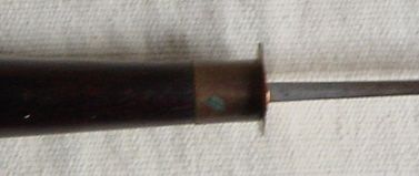

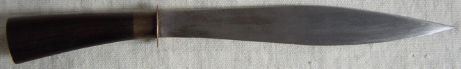

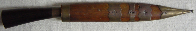

Puff, what do you make of this one. 26 cm blade, elegant and comfortable in the hand.
Old 22nd May 2006, 08:26 PM   #22
Posts: 6,002
These pictures of the brass work compered to that of a dha are quite interesting, hinting of a regional center of manufacture? Could this form also be found in Burma? I think this knife is from the late 1930s.

What is going on here? could the spread of this form of knife be quite extensive? up to north western areas?

Sword/knife manufacture has historically been a centralized industry in Burma/Thailand/Yunnan, with dominant manufacturing centers exporting their blades (mounted or unmounted) throughout the area. There was always a village industry, but this produced cruder blades, or focused on repair. Such smiths were often part time (at least in Burma according turn of the century English sources), and worked on everything from dha to cook pots.
I would expect that in recent times it has become even more so.
