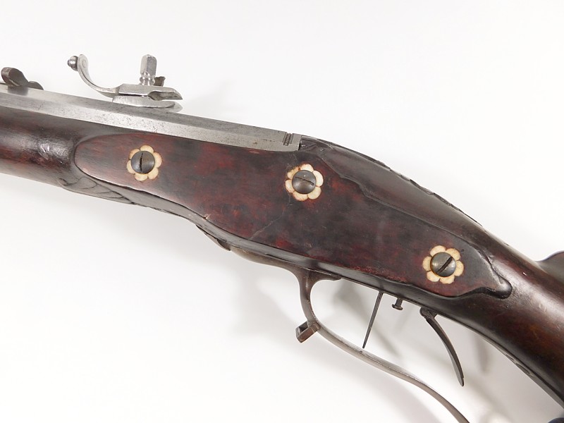

Very interesting rifle you have, and no, it is not an "economy" grade.
It was made in the Brandenburg area, sometimes called the Brandenburg school, or sometimes "Prussian" school of gunmaking.
It is beautifully made, and actually much more what we would expect from that area in decoration. Jasper's rifle is a Very uncommon piece for this area!
Frederick Wilhelm 1, and later his son, Frederick the great, were rather austere gentlemen, rather frowning on over elaborate decoration in or on anything. Very much plain and simple types.
This spilled over into guns made in that area, and this is why Jaspers is so unusual, and yours is not.
Certain features always ("Always" is a very dangerous word!!) show up in Brandenburg arms, are the bellied stock rounded on the underside, the type of guard as is on yours, 9 times out of ten, High quality craftsmanship but not elaborate, and simple understated stock carving.
Yours ticks all the boxes.

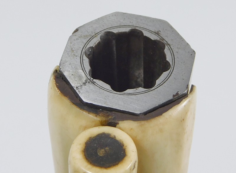

The barrel length (excluding the 4.1cm tang) is 67.2 cm. The caliber is 16mm with a rifling depth of 1.5mm.
I have attached photos of the plate opposite the lock as well as the muzzle.

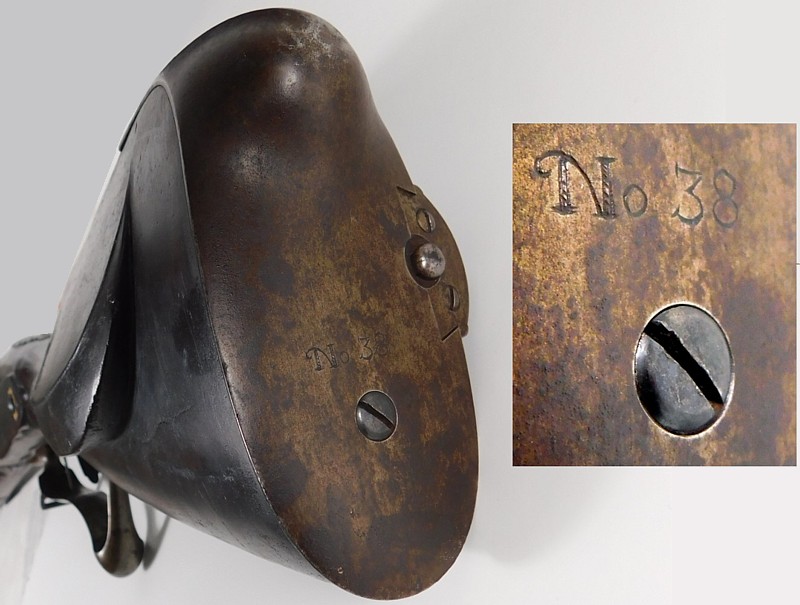

Also; interestingly the butt plate has an engraved serial number. I'm not sure if that would indicate (as modern serial numbers do) that there are at least 37 others produced in the identical manner? or could it indicate this is the 38th rifle which this particular gun-maker made.

Even the three ivory flower escutcheons around the sidenails are Identical to those seen on some Brandenburg guns, as is the muzzle cap and shape of the buttplate.
