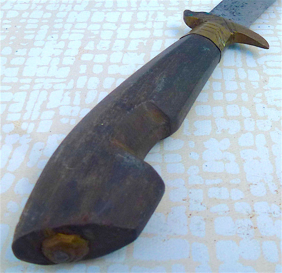

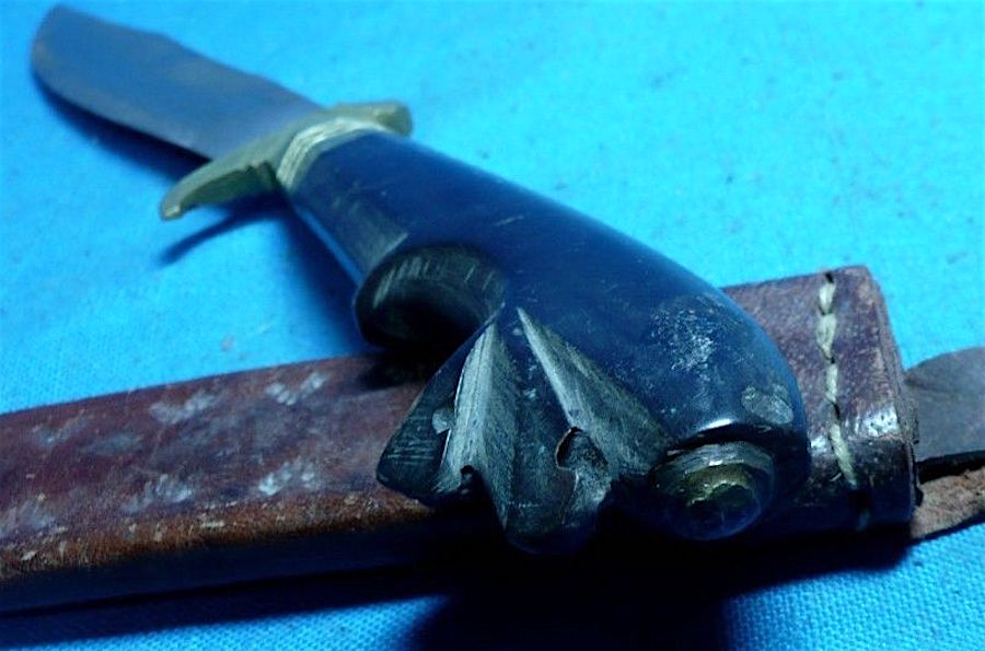

The end of the horn hilt is almost always carved in a characteristic fashion. About 1.5–2 inches from the end of the handle, there is a prominent groove on the under surface of the hilt (i.e., the side continuous with the edge of the blade), after which the pommel widens into a three-lobed structure that might represent a flower bud. The tang protrudes slightly from the middle lobe of this structure, where it is either peened over a plate, or threaded to take a nut and washer to secure the hilt to the blade. On the "Bowie" style and intermediate, "recurved blade" forms, the tang bends down a little at the pommel. In contrast, the "kris" style has a straight tang, and the groove that precedes the three-lobed structure may continue all the way around the hilt.
The groove just before the pommel seems to accommodate the little finger ("pinky notch") and may be a feature that assists in gripping the bolo. The "Bowie" and "recurved blade" styles, being single-edged, need only one such notch, whereas the double-edged "kris" style has one on each side to accommodate gripping the knife from either side of the hilt (see attached pictures).

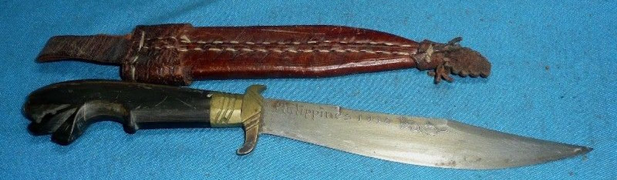

Figure 2. Typical "Negrito bolo" (Kris type). "Negrito bolo" inscribed on blade.

Figure 1. Ilocano knife from Calaciao, Pangasinan Province. Note the brass ferrule and "pinky notch" with tri-lobed pommel. Tang is placed off center. This knife was discussed here previously.
Figure 2. Ilocano dahong palay. The brass guard and integrated ferrule are well seen, as well as the off center placement of the tang.

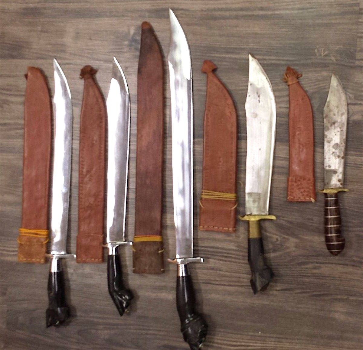

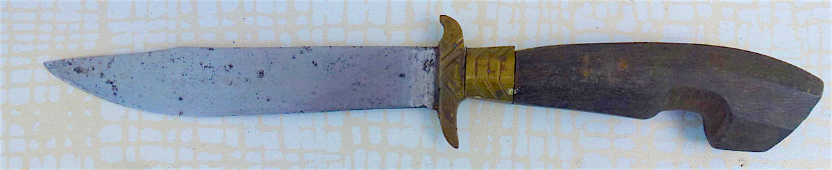

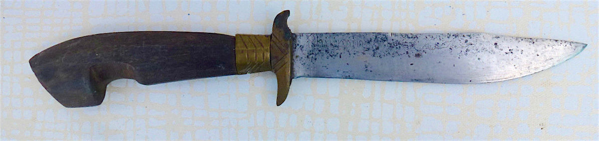

Some recently sold Ilocano/Negrito knives.
The three on the left, with steel guards and ferrules, are all of recent manufacture--late 20th C. to the present. The largest one in the middle has a fist pommel, indicating that this style of hilt is still being made.
The two on the right have traditional brass fittings and are post-WWII but older than the others. The one on the farthest right has an atypical stacked hilt and no ferrule--perhaps a modified or custom made piece.
Ian.

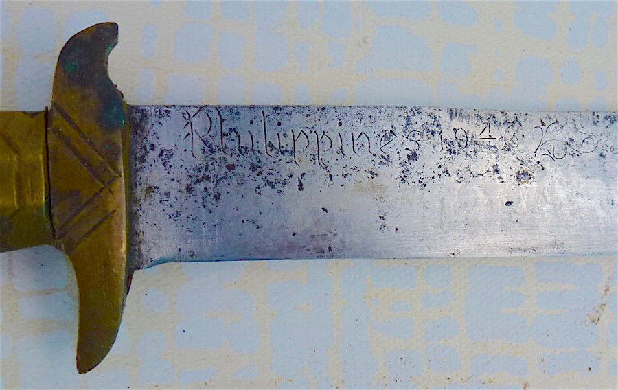

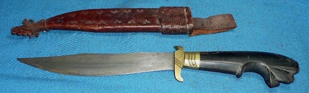

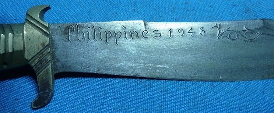

This one is interesting. Dated "1946," it is one of the earliest of this distinct style of knives which likely were produced near the old US Clark AFB and sold extensively to US servicemen.
The pommel on this one appears to show a very early form of the tri-lobed form that is seen on so many of these knives. Unlike later versions, however, the tang emerges not from the center lobe but from the lobe at the back of the hilt. I have never seen this before. If you look at all the other pics in this post of the tri-lobed feature, the hilts have a curved tang that is peined over the end of the middle lobe. The knife shown here also has a particularly deep "pinky notch" that could only be achieved if the tang was straighter than later examples. Perhaps this knife represents a transition from an earlier style which just featured the "pinky notch" and a simpler style of pommel--such examples exist and are also reasonably common.
These Negrito/Ilocano knives are found frequently online, and are still being made. I think one can appreciate how the "Negrito" styles evolved from previous Ilocano knives at the end of WWII, why the "Negrito" inscriptions and other decorations were added, and how features/materials on these distinctive knives have shifted over time.
Addendum: I have added pics of another similar knife with an older style of hilt, also dated on the blade "1946," to show how the first knife may have evolved from the earlier simple form into the tri-lobed pommel form.
