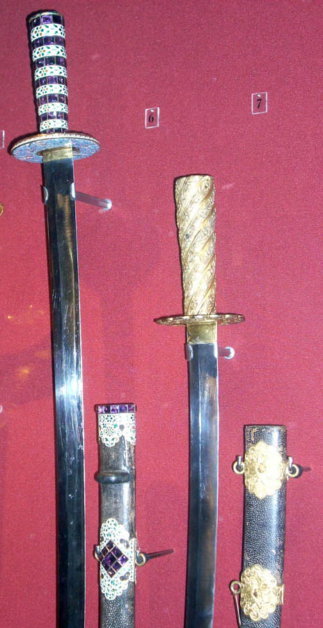

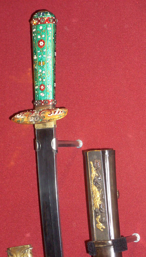

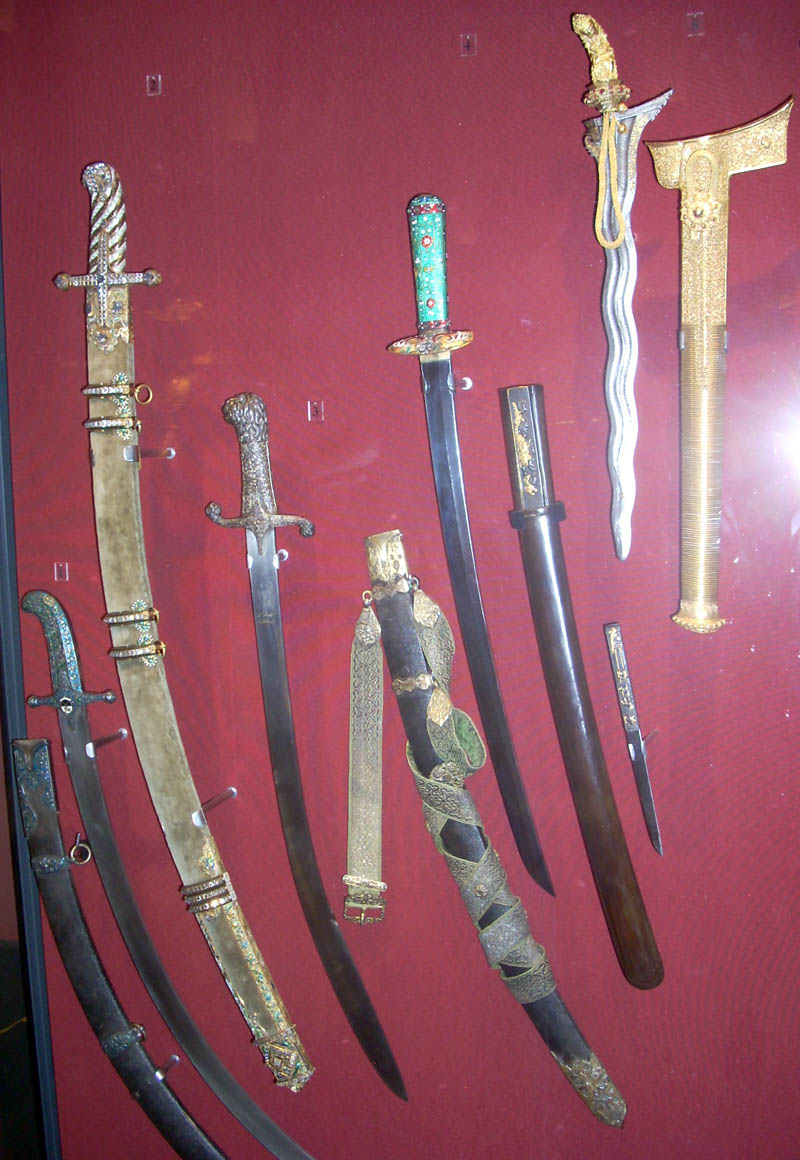

The type of sword in the image reminds me of some swords in images posted on the forum some years ago from a European collection, which I won't try to pretend that I remember the name of.
However I repost those images here, which show dha and Japanese influenced swords likely made for high ranking members of a European court, or fops such as that in the image. So, it stands to reason that dhas did end up in Europe and both could have been worn and influence European sword design, though one would expect the decoration on the example in the painting to be more European influenced such as those examples in the images I post (though they seem to be composites of Asian origin blades and some fittings and mainly European fittings).
What is the origin of the painting? Polish?

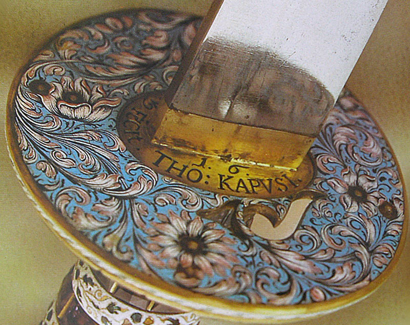

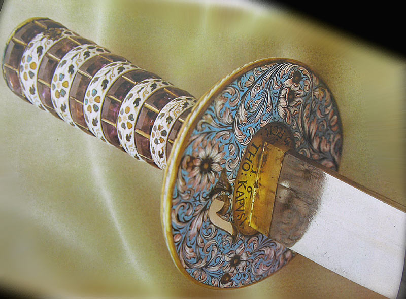

Some more images. I believe this Dresden...
The sword of Thomas Kapustran, Klauzenburg / Siebenbiurgen (Romania), 1674
Blade and scabbard, Japanese
Also to stress that these are not mine, but a forum member who posted these some years ago, here is the link as well:

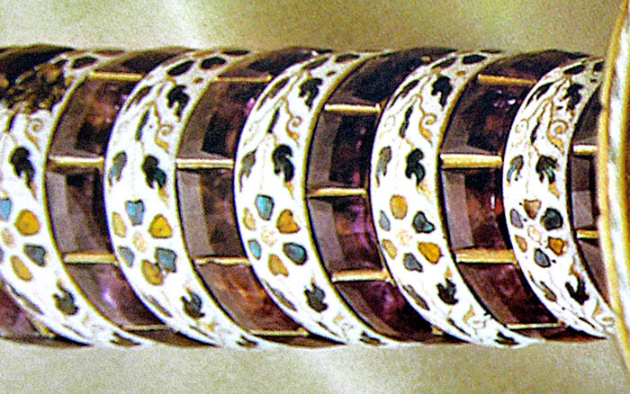

You can view the painting here in very high resolution which shows the detail on the hilt and scabbard to very good effect.
http://www.daytonartinstitute.org/ar.../ferdinand-bol
The description of the painting is fascinating and notes that both Rembrandt and Bol used the same "props" and the same are found in a painting in the Hermitage. Though on viewing that example the sword is quite different. The description from the Dayton Art Institute is below:
"This full-length and larger-than-life-sized portrait of a young dandy, once thought to be a self-portrait, most certainly dates from Ferdinand Bol's years in Rembrandt van Rijn's studio. It would seem to be inspired by several of Rembrandt's self-portraits and other works of the same period. Rembrandt's Reconciliation of David and Absalom of 1642, in the collection of the Hermitage in St. Petersburg, uses almost identical objects to the ones found in Bol's portrait. In the aforementioned Rembrandt and in Bol's portrait, a quiver of arrows, a heavily embroidered velvet tunic, and a velvet scabbarded sword are the studio props evidently shared by master and pupil.
Bol also shared Rembrandt's fascination with unusual costumes and gear. The great sword, fashionable high-heeled leather boots, the richly embroidered clothes, velvet cloak, and plumed cap are far removed from the sober, black garb of most Dutch citizens. Rather, they have more in common with the brightly colored costumes of the subjects favored by Michelangelo Merisi da Caravaggio (1573 - 1610), a revolutionary and controversial Italian artist whose paintings influenced a generation of artists across Europe. Although grounded in a keen observation of detail, the sensuously depicted, exotic finery lends an air of fantasy to this portrait of an unknown friend or artist colleague of Bol's."
To my eye, the embossing on the middle part of the hilt does appear to have some aspects reminiscent of Thai swords.
