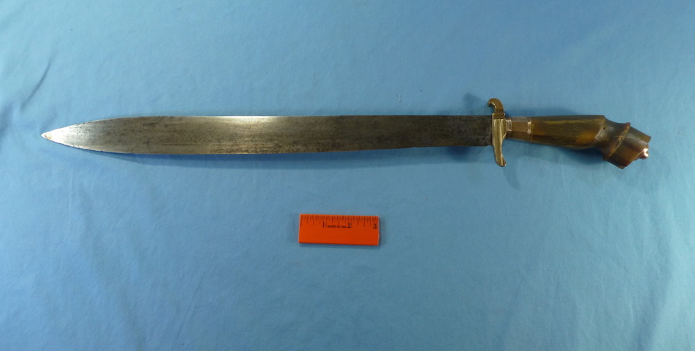

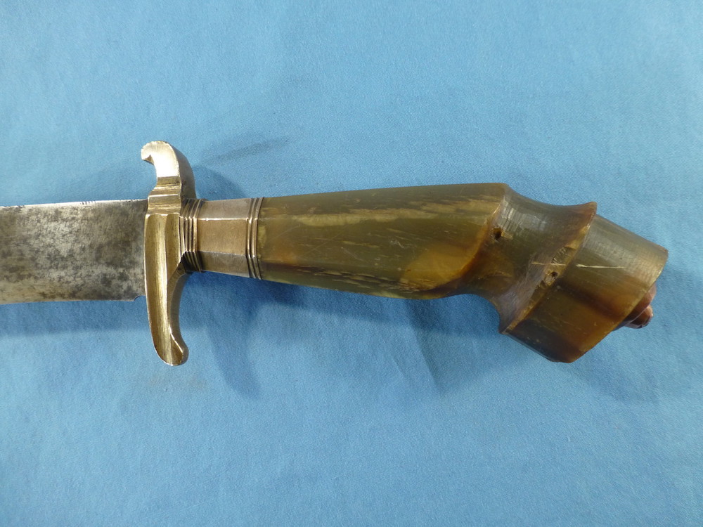

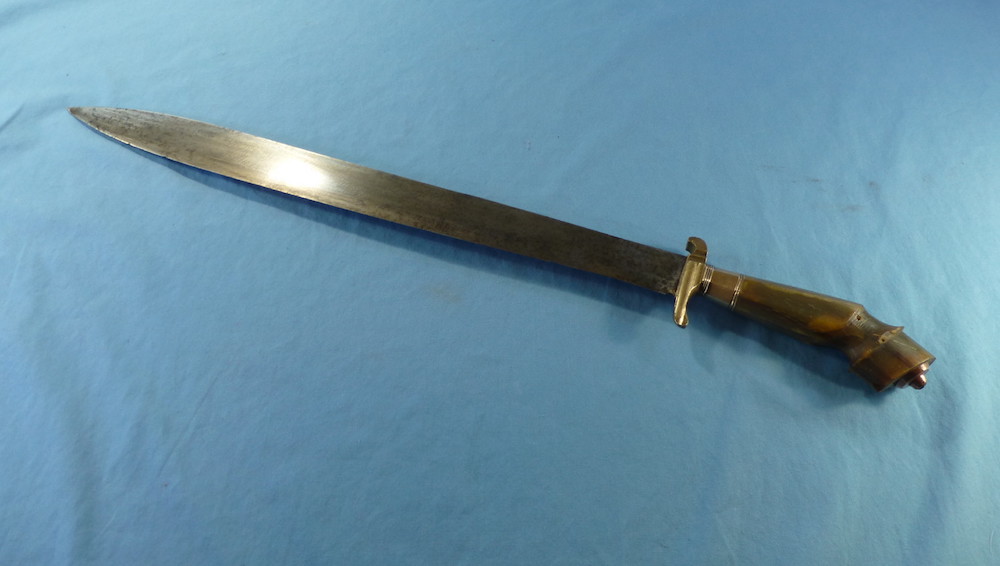

I bought this sword from Ian through our swap forum. His identification was as follows:

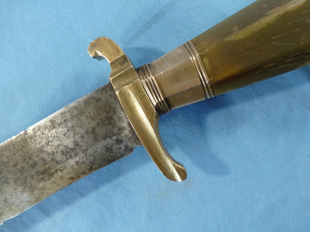

" This is a dahong palay, so named because the shape of the blade resembles either a rice leaf or a venomous snake of the same name. This is usually a Tagalog (central Luzon) blade form but here it is in Ilocano dress as shown by the brass cross guard and integral ferrule, while the bent tang and shape of the "horse hoof" pommel are consistent with older Ilocano work.
The heavy blade has obvious lamination and appears to have a hardened edge. The blade has been fitted to the hilt perfectly.
Dimensions:
OAL.......... 24 5/8 in
Blade........ 18 3/8 in
Hilt........... 6 1/4 in
Thickness of blade at forte.... 5/16 in

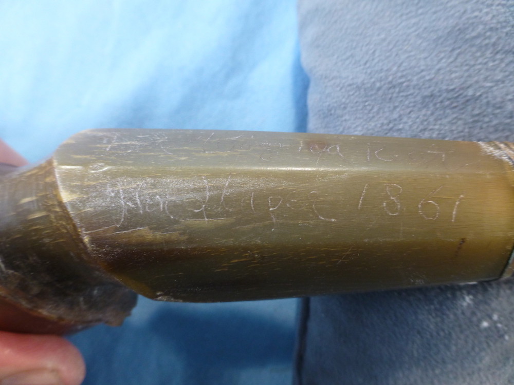

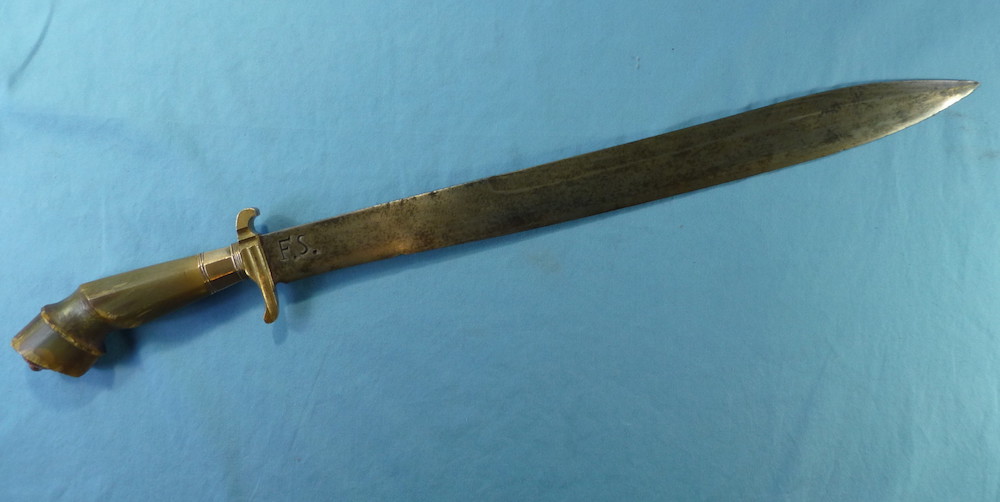

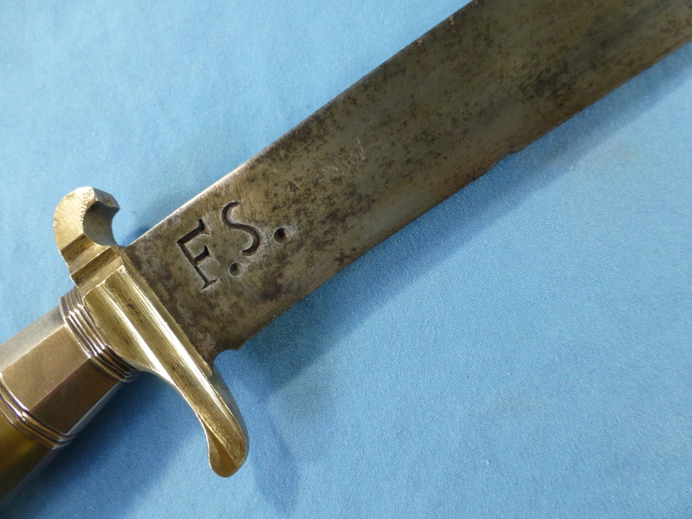

A couple of very small minor areas of damage to the horn hilt. Scratched on the hilt is the name "John Ikaver 1861." The initials "F.S." are incised deeply at forte."

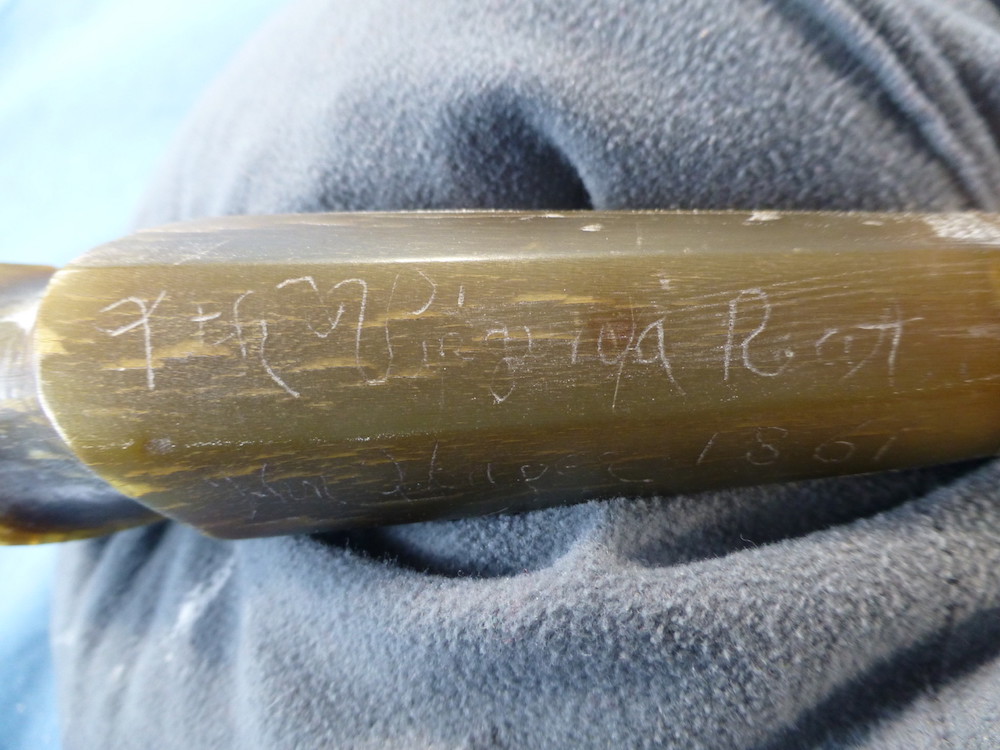

Something that Ian missed is that also scratched on the hilt is “9th Virginia Regt.” (or it could be a crossed 7). Also, I read the name as "John Q. Leaper”.
Once I pointed out the second inscription, based on his identification of the piece as a dahong palay, Ian suggested an association with the US 9th Infantry regiment that fought in the Philippine war. A couple of points challenge that interpretation. The problem is there is no clear connection between "Virginia" and the 9th Regiment that fought in the Philippines. There was a 9th Virginia Regt. in the Continental army. It was formed prior to the Revolution but it was disbanded on November 15, 1783. There was also a 9th Virginia Regt. in the Army of the Confederacy, and that unit was formed in July of 1861, consistent with the date. Incidentally, there was also a 7th Virginia Regt. in the Army of the Confederacy, which was formed in May of 1861.
In any case, by the time of the Philippine war, it was no longer customary to identify US military units with specific states, unless they were volunteer units recruited for specific conflicts, such as the Spanish American War. Furthermore, the US 9th infantry regiment that fought in the Philippines was first formed in Maryland, not Virginia.
All of the above considerations leave me with a sword identified as Philippine, likely from circa 1900. Without the inscriptions one could imagine that came to the US as a trophy or souvenir from the Philippines.
However, what if the inscriptions on the hilt are credible? Is it plausible that this is not from the Philippines at all and really was made by a Virginia blacksmith (F.S.) in 1861?

The horse hoof horn pommel and the ferrule/guard are pure Filipino.

Forgive me for stating the obvious:
Somewhere in its recent history, someone scratched the inscription into
the grip in order to pass it off as a Confederate sidearm.

Hello Marcus,
<snip>
While the year might be explained away by regarding it as a birthdate or some other memento, you seem to be correct, that the inscription doesn't make any sense if placed in the period of US colonial presence in the Philippines.
However, I agree with Ian that this certainly is a Filipino dahong palay. The scratched inscription may point to the US civil war but I doubt that this sloppy inscription would have been put on a good short sword in those times.
AFAIK, quite a few Filipino blades have been offered in the US market as genuine civil war artefacts to solicit a much higher selling price; I believe the most likely explanation for this enigma is that someone wanted to bolster the civil war attribution and added a fake inscription...
I'm with you, Oliver! I did not saw that you already answered since I got sidetracked and took a while to complete my post...

They might have done better if they had etched "9th Manchu Regt." and made the date 1901 instead of 1861, then they could have tried to pass it off as associated with in the massacre of Balangiga in Samal, September 28 1901.

They would have done best to leave it alone

Absolutely. I am afraid i have to concur with Oliver that these markings were somebody's lame attempt to try to pass this off as a Civil War weapon. It is clearly a Philippines blade. If the inscription was shallow enough i would even consider buffing it off, but it probably runs to deep for that. A beautiful knife regardless.

I would not dream of buffing it out. Its story is its story.

Well, i believe it is its outright "lie" more than its "story" Marcus. IMHO it is more like ugly graffiti on a beautiful building. To conserve the building i would remove the graffiti if possible and return it to its original and intended condition. What's more, it's grafiti meant to deceive. The only "story" this tells is that someone in contemporary times saw fit to deface this hilt in an attempt to defraud the public. This is not a part of this knife ethnographic history though. History perhaps, but not one i see any reason to preserve. It is wholly unrelated to its life and use in its cultural environment. So if it were mine and if the inscription was shallow enough to buff out without removing an obvious amount of material from the hilt i would not hesitate to do so. Of course it is not mine and the damage may be to great to repair. But we each have to do what we see as right for our own collections. I was not suggesting that you need to do what i suggest, only saying what i would do if it were mine and possible.

Actually I see both sides of the 'story'. As a historian, I see weapons as a kind of montage of distinguishing features and elements which represent the entire working life of the piece. In many respects, its disposition after being removed from its working life, whatever the case, sometimes presents interesting subsequent history in who might have held it as either trophy or collected.
I entirely see what David is saying though, in that this seems more a case of deliberate defacing of an otherwise extremely attractive sword in the too often seen deception of 'innovative' sellers. The often crude and ersatz character of Confederate weaponry has encouraged all manner of contrivances labelling many types of unusual arms as 'Confederate'.
Sometimes these ploys are almost bizarre, as in this case. We can think of any number of tenuous speculations as to how a Filipino sword might have fallen into Confederate hands but even as a novelty, why would someone insist on placing their name and unit info on the weapon. One of the most typical aspects of actual Confederate arms as I have often read, is that there are seldom such unit or personal data emplaced on them. Obviously there are exceptions, but few.
I think David is right, and this defacing should be removed if possible without causing further damage. If these persons trying to create deceptive historical identity for weapons were only intelligent or skilled enough to at least KNOW something of the history they are trying to allude to, they might be more of a threat.....instead they are just vandals.

BTW, does anyone know what these large initials F.S. stand for? It seems like it might have been for one of the insurrection groups or of that ilk.

Unfortunately I have seen far too many Philippine edged weapons that have been altered in this manner with monetary gain the vandals [not the term I would normally use] only concern. It is my opinion that the information scratched into the hilt is not only misleading but a distracting eyesore that should be completely removed from this otherwise very attractive sword. From what I can tell by looking at the photos, if done carefully this should be fairly easy to accomplish without causing any excess lose or further damage to the horn hilt.
The initials I believe are most likely those of the maker.
Robert
Old 20th January 2017, 06:40 PM   #18
Posts: 10,782

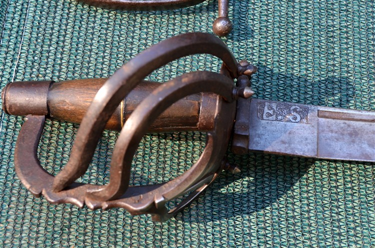

I think quite likely as Robert suggests, these initials are for the maker as I have seen the same application at the same location on the blade on some espada ancha. The connections between colonial New Spain in the Americas, Cuba and Mexico with the Philippines being the far western segment of the Spanish Main relayed these influences notably.
It is always interesting to see the subtle similarities in some Philippine weapons to these Spanish colonial weapons of the Americas.
