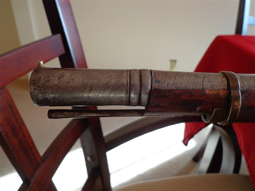

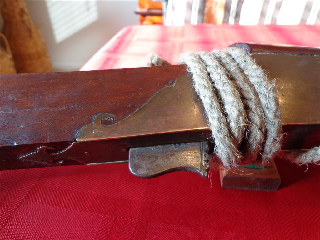

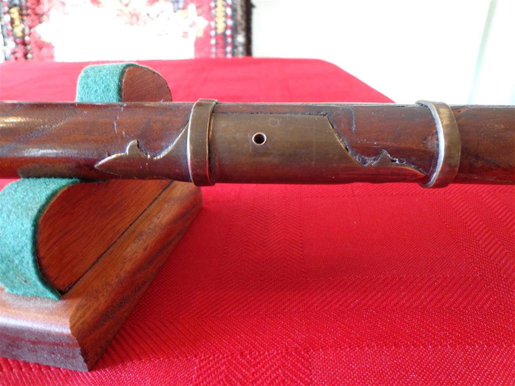

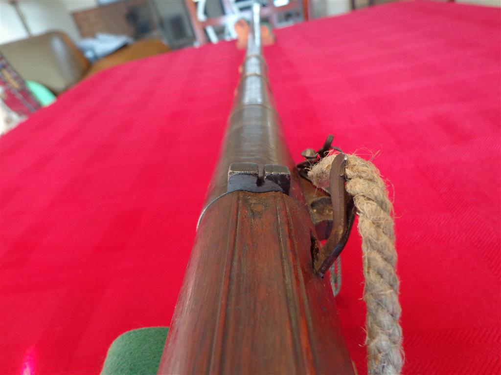

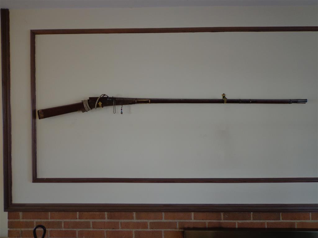

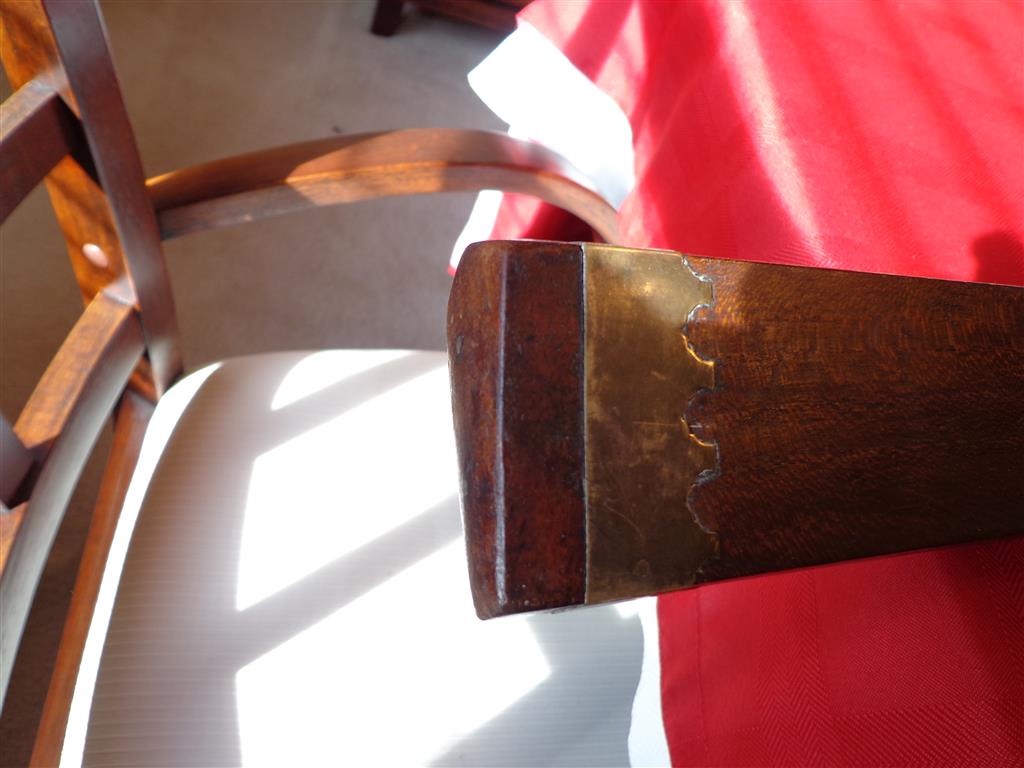

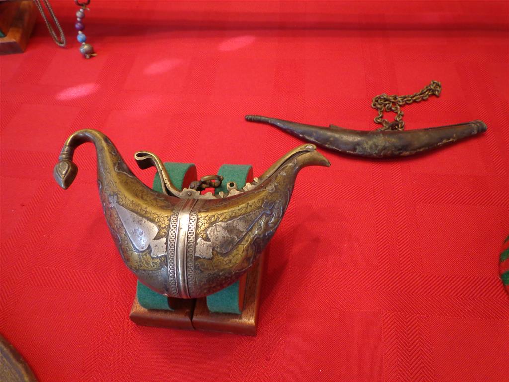

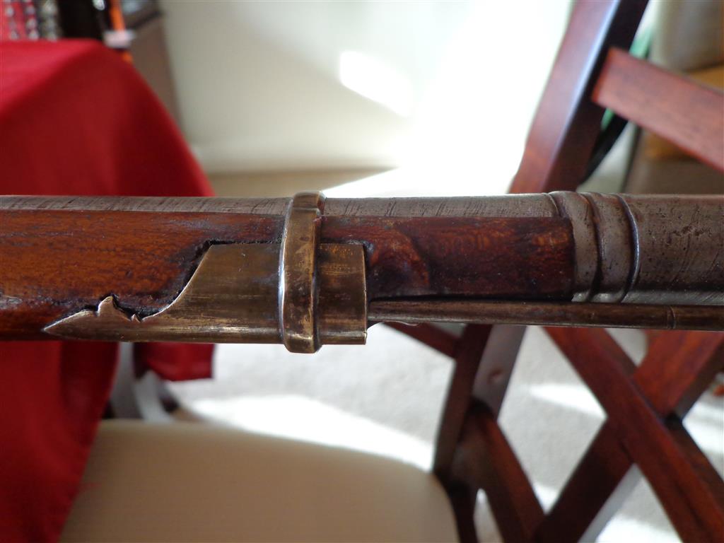

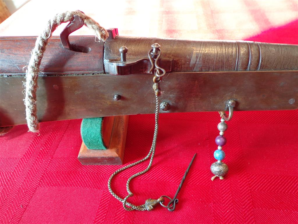

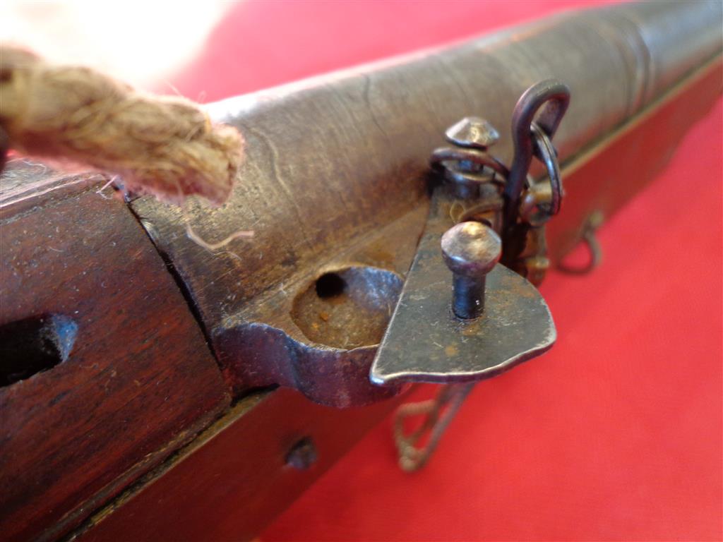

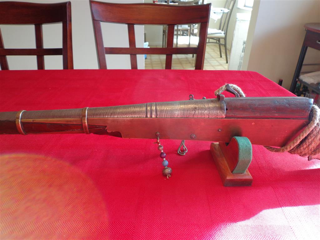

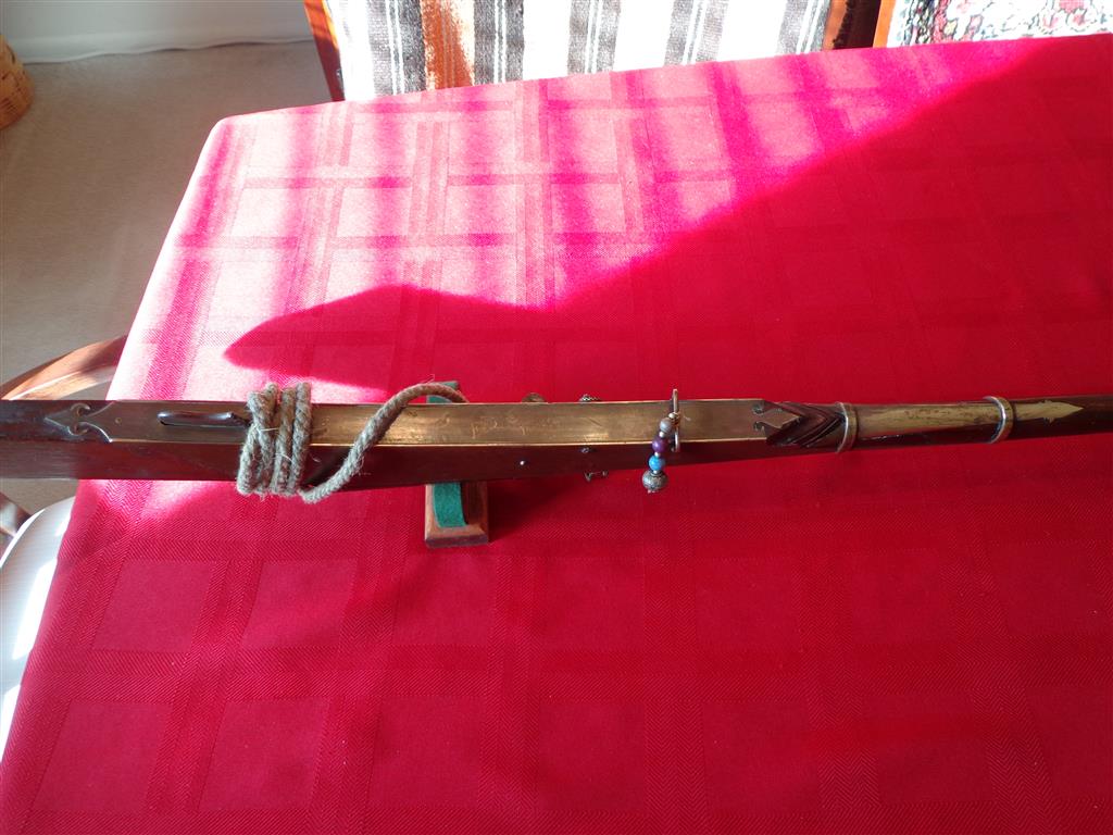

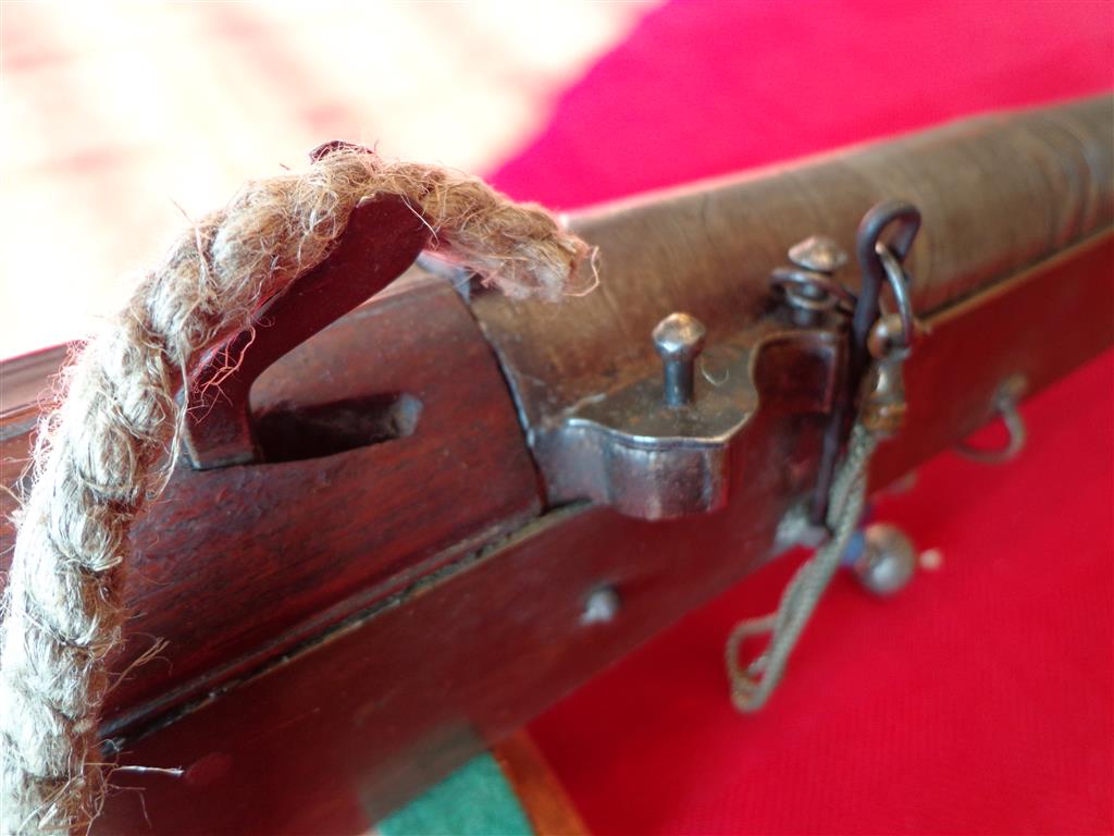

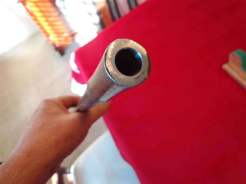

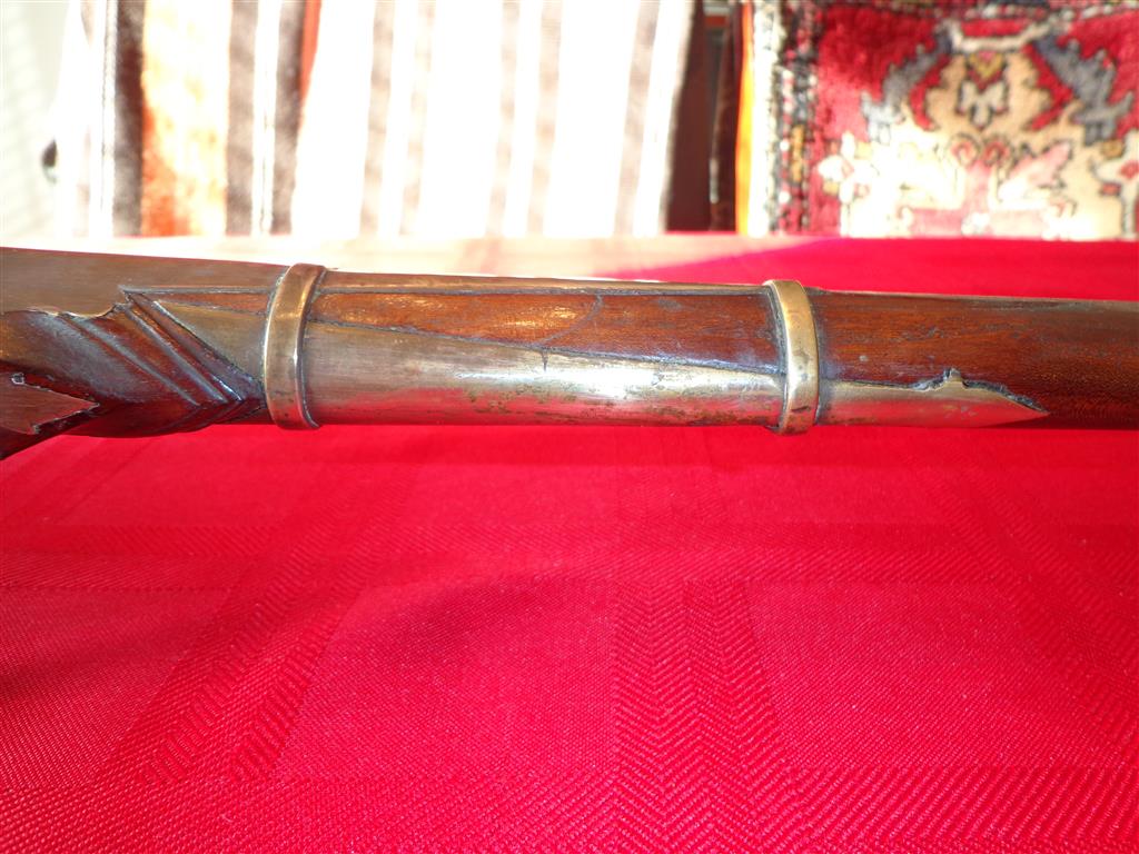

Hello All.
I guess this is actually Part IV of the Torador Barrel Investigation Threads I posted earlier. But thought I would start a new Thread since the gun is now complete.
The Torador musket is now re-assembled and complete. It's now safe, and ready to be test fired. Can't wait to try it out.
The OAL length is 75" (191cm) with a barrel length of 55.5" (141cm). The original caliber was about .65 (17mm). It has a new steel liner in the bore and a sleeve inside the breech area. It is now a .54 (14mm) caliber smoothbore.
It has a new brass front bead sight. The clean break in the forearm wood was repaired, which doesn't even show. The original pan cover was missing. So a new one was made. I added a vent pick and chain. The bead work is just me playing around. LOL Original powder and priming flasks in working order. I will use these to load. Should be much fun.
Anyway, picture heavy here. Comments most appreciated. And thanks for looking.

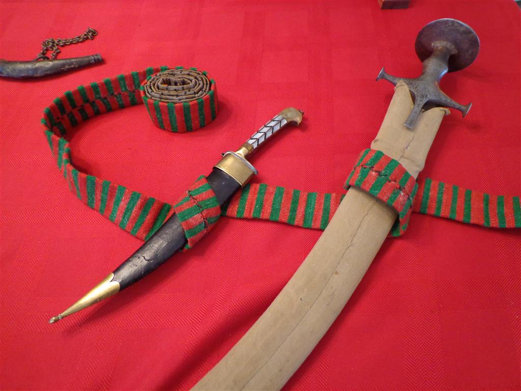

VERY NICE!!! I really like the pic with all the accoutrements! We tend to forget what is also carried with guns............
Stu
Old 21st December 2016, 07:08 PM   #6
Norman McCormick
Norman McCormick's Avatar
Posts: 1,657
Hi Rick,
Great work as always and I'm with Stu on the bits, nicely done. There's quite a lot of Toradors in the U.K., bring backs during the Raj, most of which are in a sorry state stuffed in garages and attics but the bits are much more difficult to find so it's nice to see them together. I've not been about much lately, have you got a liner in the barrel and if you have what is it like to shoot?
Norman.

Hi Stu.
Thanks for the comment. I plan on using the flasks to load while test firing and set the other accoutrements on the shooting bench next to me just to add to the "atmosphere" if you get what I mean. LOL. Should be great fun.

Hi Norman.
Thanks for your comments. The barrel does in fact have a new steel liner. It's now a .54 caliber (14mm) smoothbore. I can load, shoot, and clean just like any other muzzle loader. It was just finished, so I have not fired it yet. Will probably wait till early Spring so I can have someone shoot a video.
Next Project, I'm sending off the barrel of an Albanian Tanchika long gun to have a liner installed. LOL

Look forward to a range report Rick!
Like I said elsewhere, I believe this gun came from Jaipur originally, going by the metal re-enforcing and decorative style.
Looks well now. Maybe polish the scratches out on the muzzle end a bit.. :-)

Hi Roland.
LOL!!!! That's a good one. Yes, it's a smoothbore. I have never seen any Torador that was not.
With the barrel liner I've dramatically changed the bore configuration from it's original design. So I'm guessing it will shoot similar to other smoothbore muskets now. It would have been very interesting to know how the original bore design would shoot. But I was not willing to risk it. LOL
