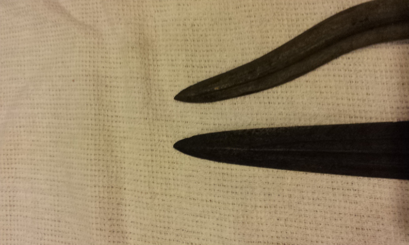

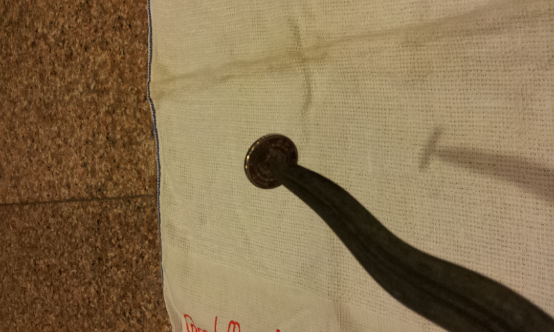

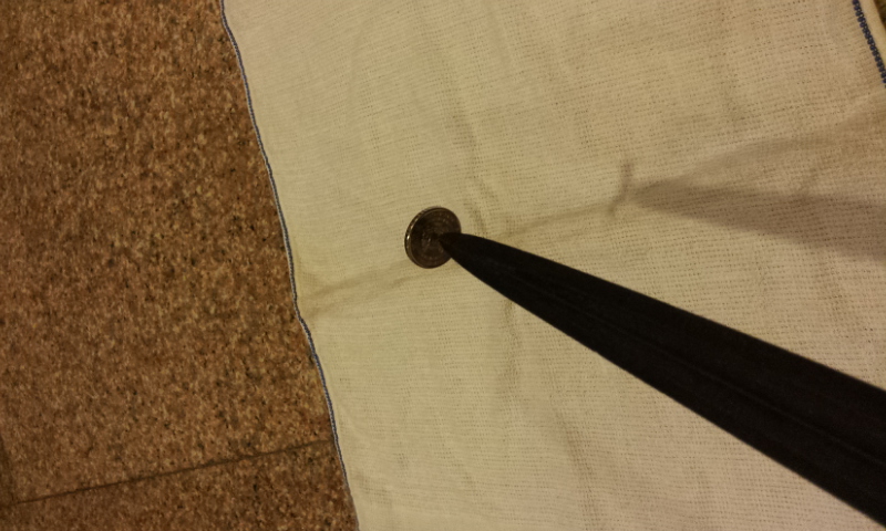

One way dealers and sellers here ups a price of a keris is by saying that it is "armour piercing" ie the fact that the keris can lift a coin after a single tap on the coin.
I admit, not all my keris can do it. What is your take on it? Is it really "armour piercing" or a just a case of good tempering and manufacture?

To me it is obviously a coin-chipping Keris!
Without being too knowledgeable on the subject, I believe it is pure marketing BS. Something like the trick with the standing Keris.
PS: And I suspect that a guy who is doing this to sell a Keris, is selling nothing but crap...

Hello Paul,
I'm pretty much with Marius on this one:
The usual copper-based alloys for coins are quite soft - it doesn't need any sophisticated heat treatment for even very mild steel to become tougher than coins! (BTW, keris are traditionally not tempered which would need controlled re-heating the hardened blade to a fairly low, bluish temp specific for any given iron alloy - not really needed nor practical for laminated blades.)
You show two keris with very pronounced ada-ada: In my experience any of the traditional blade and tip geometries do perfectly well for coins... (Since armour in the Malay/Indo world tended to be pretty basic, I doubt that nicking coins tells us much about fighting function in the old times. )
Any keris blade that does not pass this coin test needs to be retired from "active service" as a sidearm and it usually will be a "ghost" blade that lost much of its body from erosion (rust and washings). Of course, such a worn blade may still be a valuable pusaka and/or retain any intrinsic powers (isi, etc.).

As with many good stories, this one has a basis in fact.
During the Kartosuro era, one problem faced by Javanese warriors was the fact that their kerises were unable to pierce Dutch breast plates. The Javanese keris was made as a personal weapon, and if carried into battle, it was a weapon of last resort, but that last resort was no resort at all if faced by a Dutchman wearing a breast plate. At that time, normal Javanese dress was naked from the waist up, so you didn't need a particularly robust keris to be able to stick your dhuwung into your brother-in-law's kidneys if he stole your terkuku.
Enter Brojoguno I.
His claim to fame was that he could make keris that were able to pierce Dutch breast plates. The recognised test for a keris that was claimed to be able to do the breast plate thing became the ability to pierce a copper coin:- copper coin on a wooden bench, pierce that and you were accepted as having proved your point.
Brojoguno was not born in Kartosuro, he came from outside, I don't know where, but very probably Madura or the North Coast. His descendants all took the name of Brojoguno.

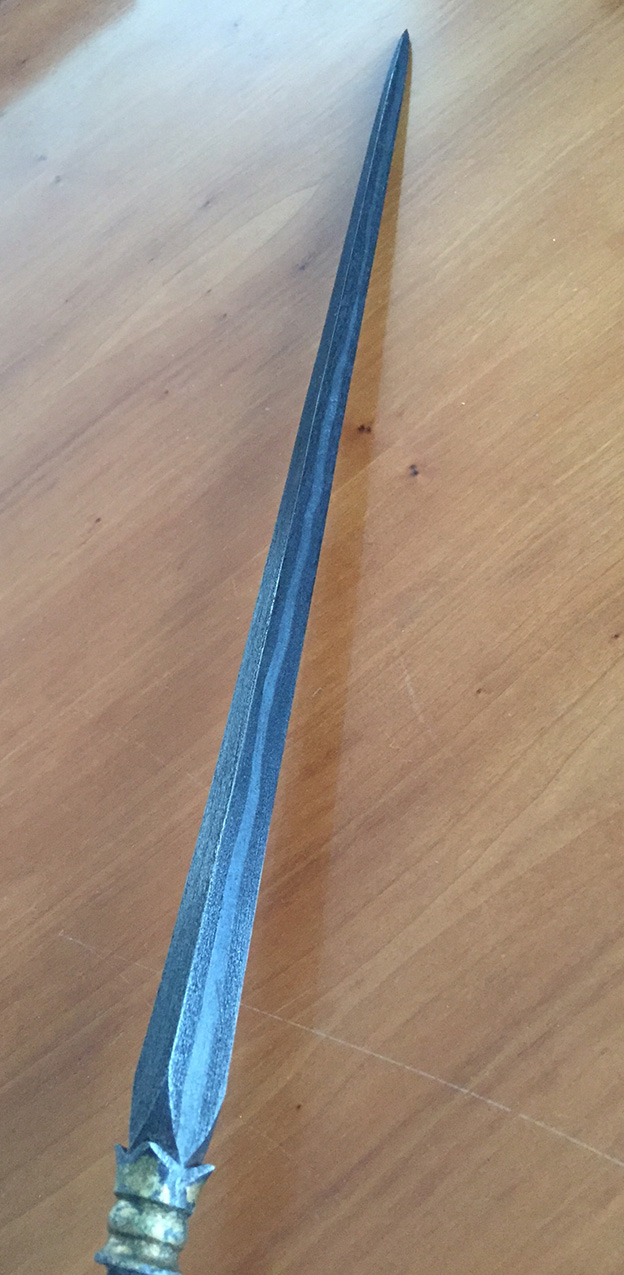

Now you mention it Ariel, yes, the cross section of this type of keris --- the Brojoguno style and his copiers --- is something like an estoc.
There is also a tombak that will pierce breast plates, it is the "sajen ampel" form, and it is a distinctly diamond shape cross section.

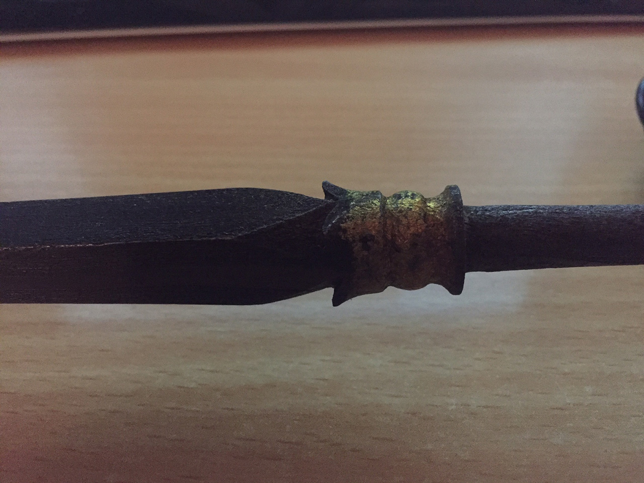

Could this be the tombak you mentioned?
Kulino is offline   Reply With Quote

Kulino, how many edges does this tombak have, 3, or 4?
3 I think
Donny
satsujinken is offline   Reply With Quote
It is diamond shaped.
Old 20th December 2016, 10:47 AM   #24
Posts: 7,228
I think it is probably valid to call this a sajen ampel, but it is much finer than any I have handled.

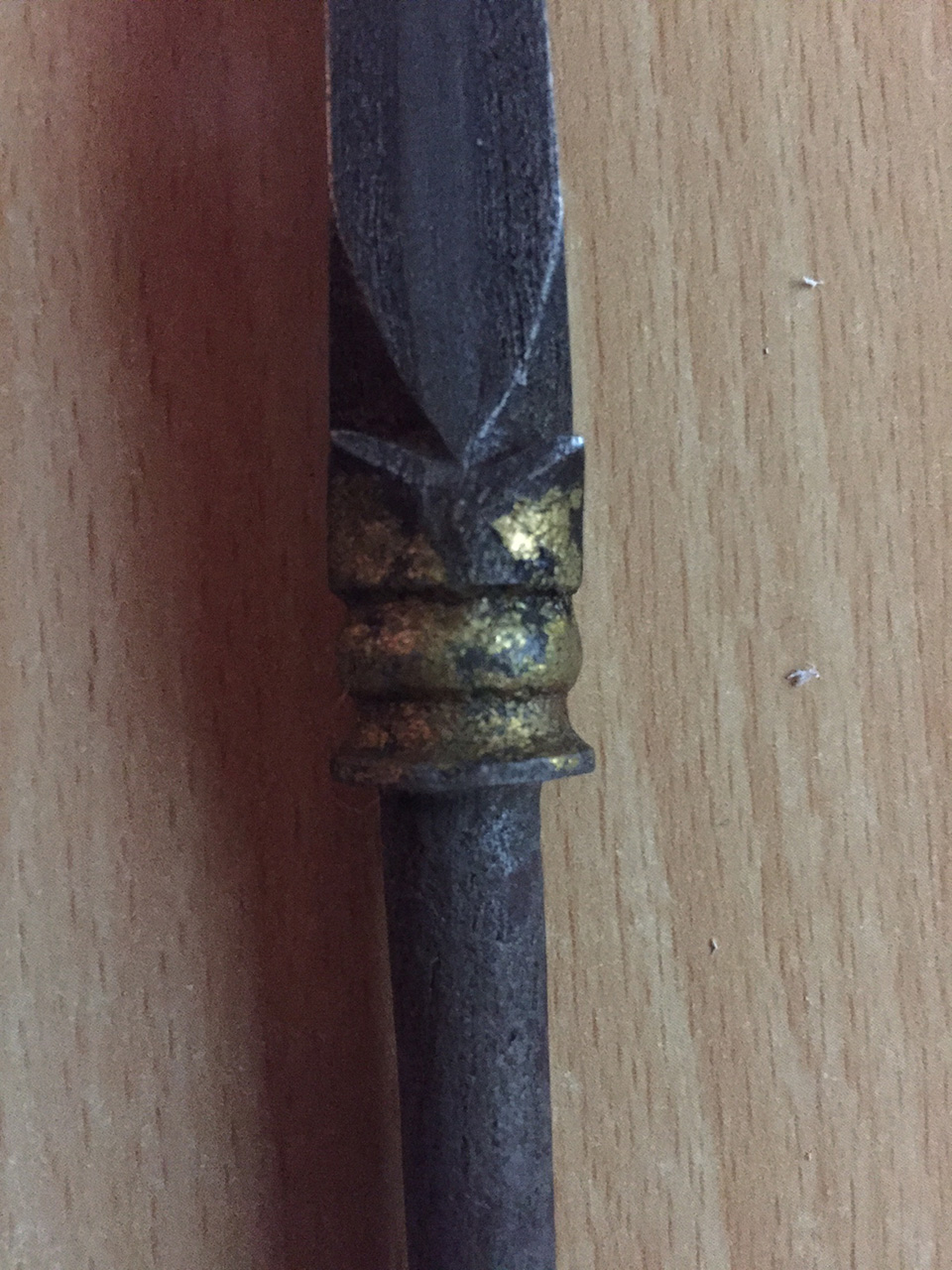

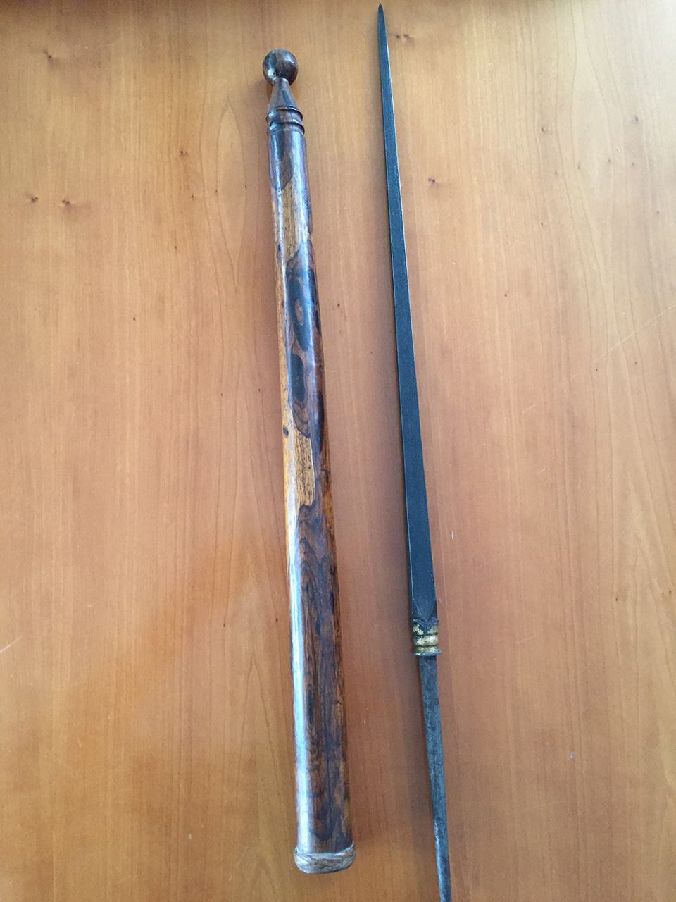

Any idea about age?
What does the kinatah tell? As far as I can tell it is a kind of lotus. Nothing like an anggrek.

Please let me have a good, clear close-up of the base of the blade, taken at 90 degrees.
I may or may not be able to give an opinion.

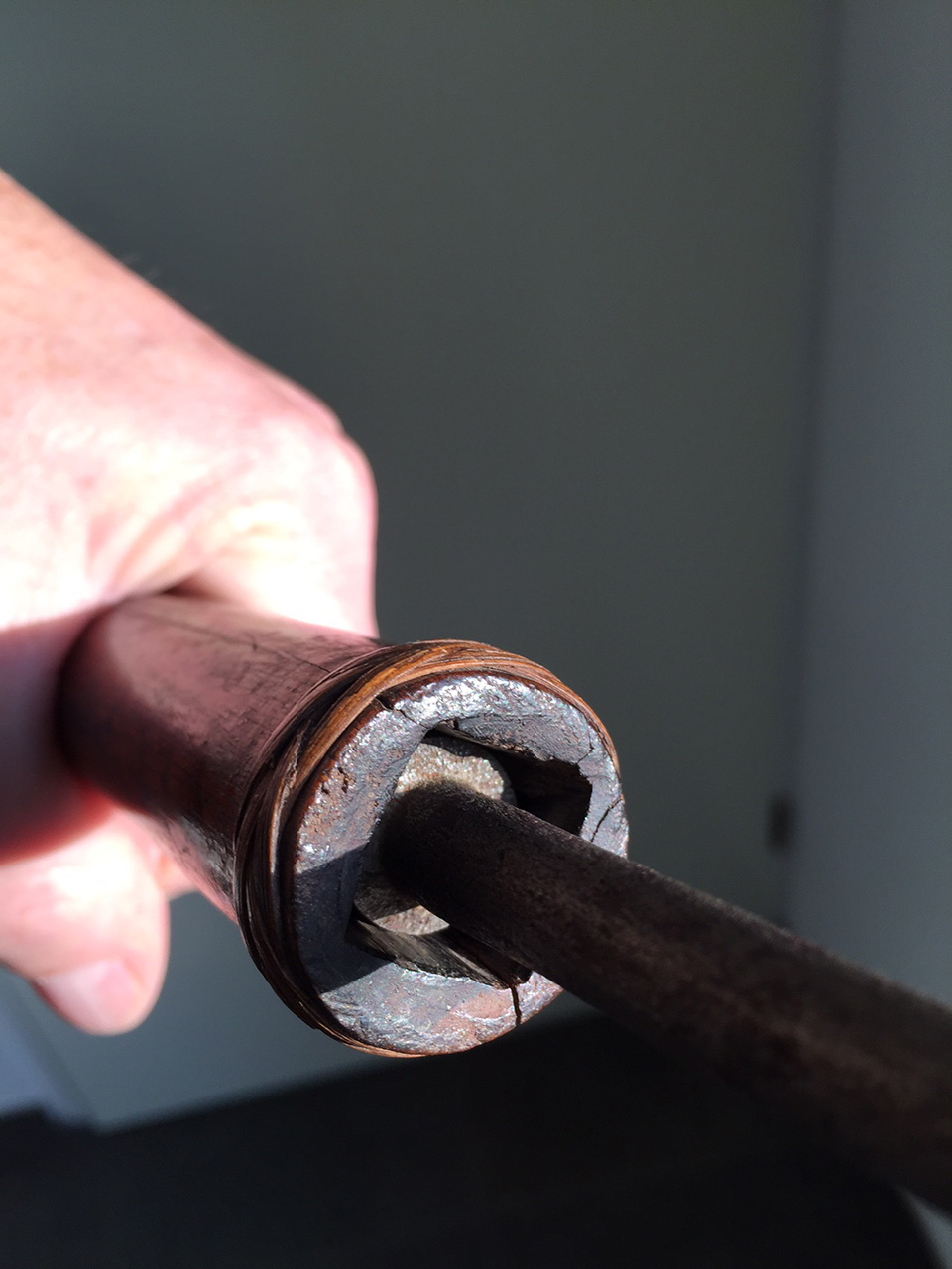

Based upon what I can see in the photos, this is a North Coast Jawa tombak, probably classifiable as Tuban, quality is not as fine as I had thought from the previous photos, the factor that puts it into a lower class being that it is metuk iras.
I am not prepared to take any guesses at age, nor at the design factors.

Dear Alan,
Could you please elaborate on the Mentuk Iras?

Originally Posted by Kulino
Dear Alan,
I am sure that Alan will be able to elaborate further, but he is referring to the metuk as being all one piece with the pesi. It was not a piece added on and welded in place.
