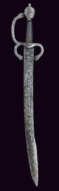

O.L. 78.5 cm ; blade L. 65 cm; blade width at hilt 3.7 cm.
In Norman it seems there is no similar pommel to this one .Even the hilt I don’t see the same.
Any comment on it would be welcome.
Best
Cerjak

I think this is a late 16th century or ca 1600 sword for the foot. Possibly a Pikeman's sword. The grip and wire wrap is new. 16th Century grips and wire wraps are slightly different. Your grip and wire wrap is made after late 17th early 18th century style. The Turk heads could be original in my subjective opinion.

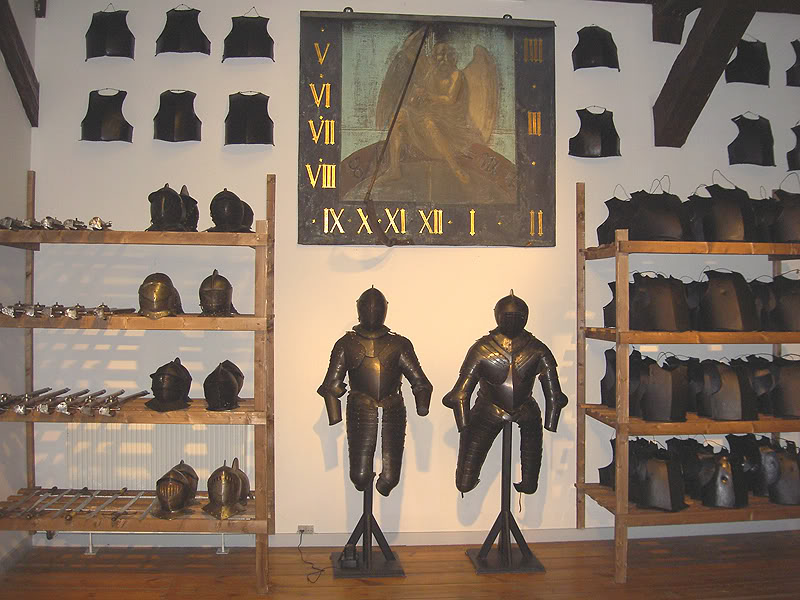

If you take a look at the attached photo, you will see similar "flat" swords at the bottom left in the photo. The difference is that the pommel on the swords attached is more egg shaped but also flat as yours with the same simple guard. The blades are longer and the hilts larger, thus making them more suitable for the horse. Armies often / sometimes used similar swords for the foot and horse, but the dimensions are different and fitted to what type of use the sword is intended for. Swords for the horse also tend to show a little better craftsmanship but not as a rule.

It's a military sword of the seventeenth century ( south German or Venetian ). On the blade the wolfsmark of Passau.

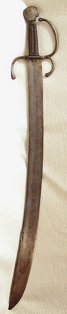

This type of hilt, with flattened pommels in the plan of the blade, actually occurs frequently at Italian storta type swords of the 17thC.
Actually one would expect a single edged blade here.

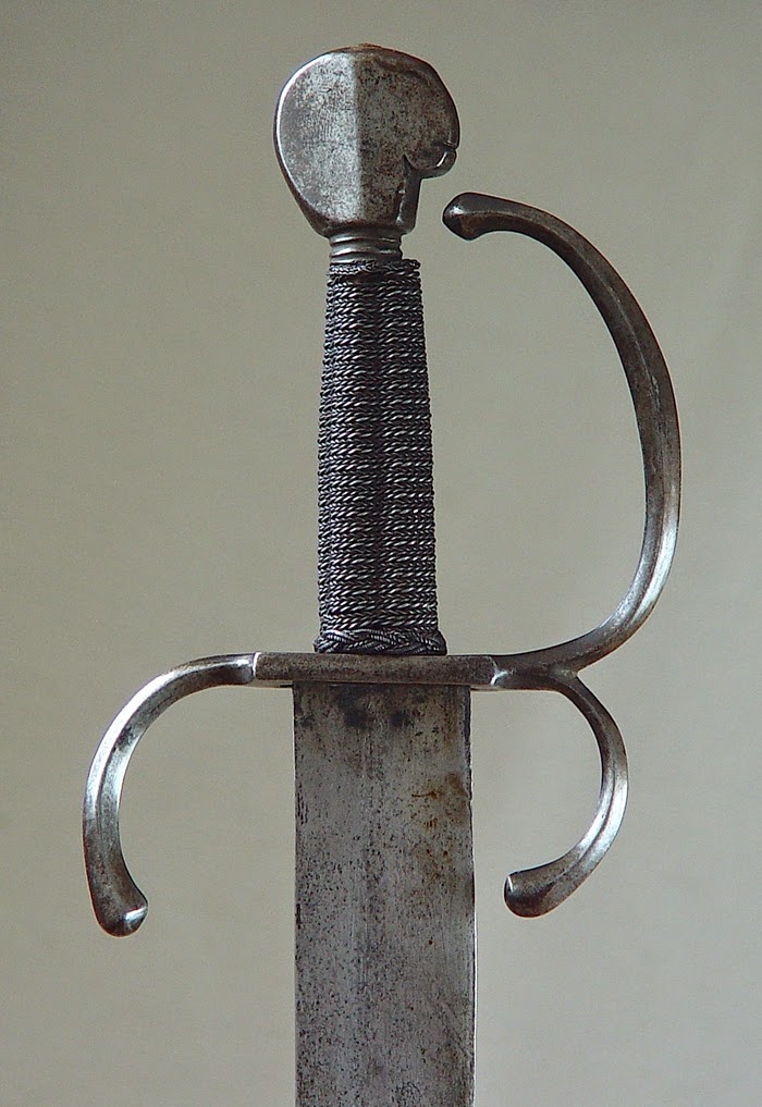

yes this can possible, you have to check the ricasso block for signs if there has been another blade mounted before this one, there is one in the dutch army Museum with a straight 2 edged blade. the indicated timespan of 1600-1650 for this sword is realistic.
Attachement: JP Puype van maurits naar munster.

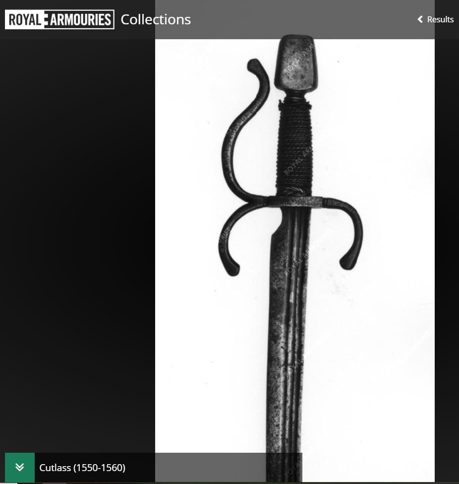

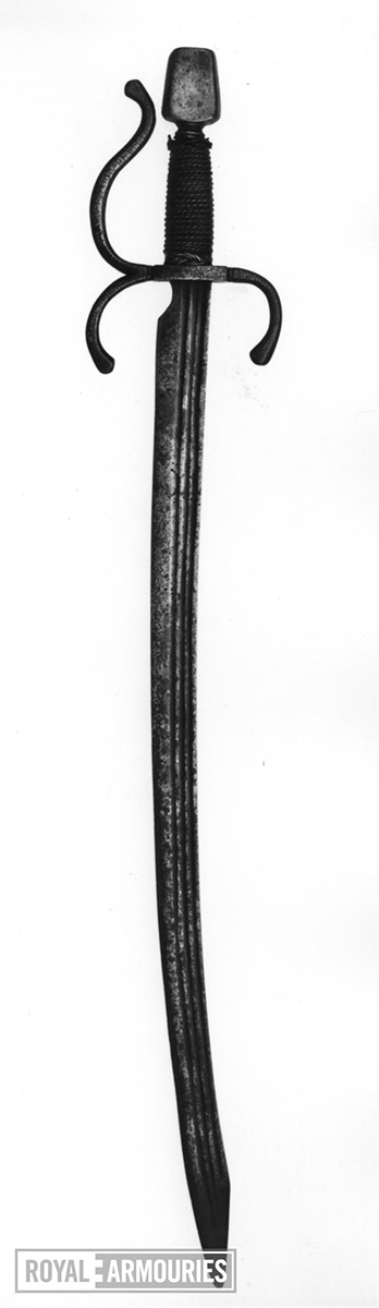

in the royal armoury with similar hilt circa 1550-1560

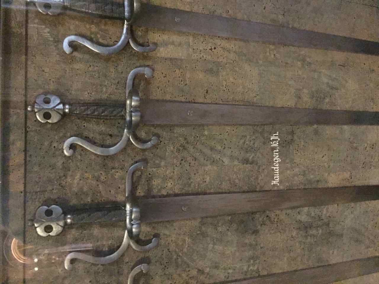

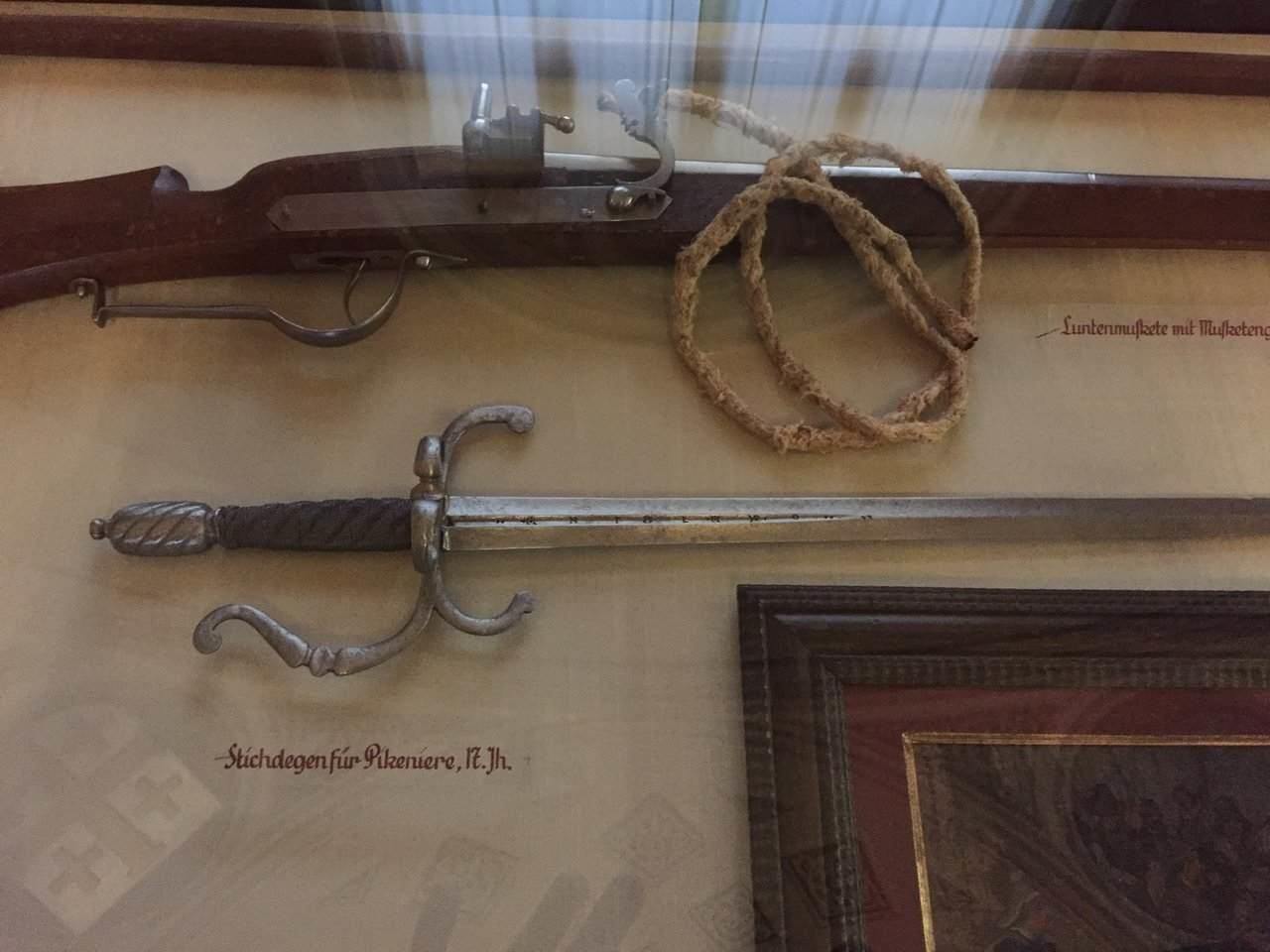

These are from the Heeresgeschichtliches (Army) Museum in Vienna. One is a thrusting sword for pikemen (17thC) and the others are cutting cavalry swords (16thC).

Thank you Vitrix for these pics ,the but the hilt is somewhat different.My sword and the one from the royal armory are with asymmetrical quillons and also no ring guard.
Best
