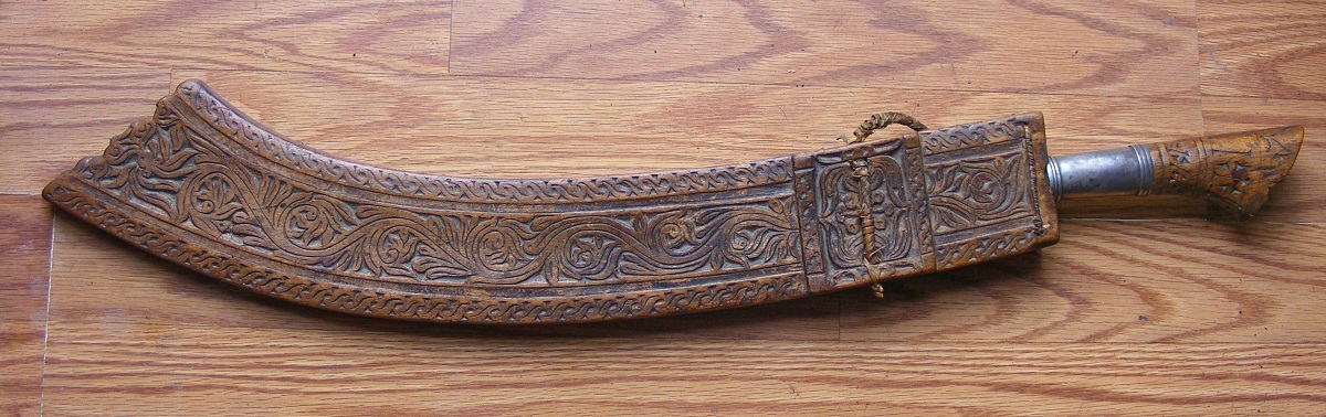

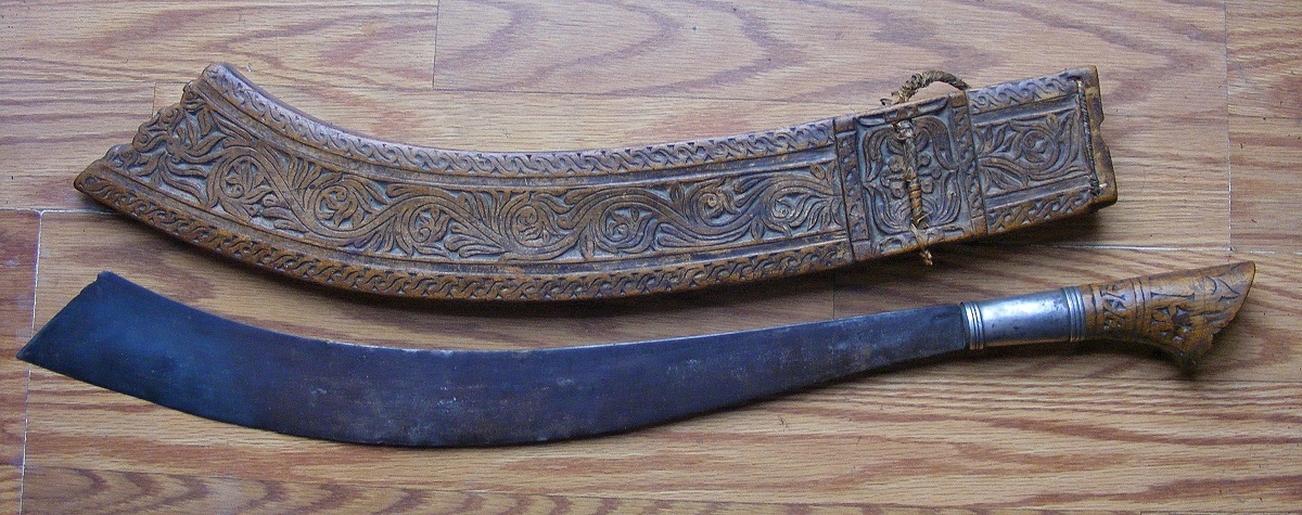

Hello All,
Some time ago I was fortunate enough to secure this rather nice Parang which I am confident originates from Borneo. My assumption is based mainly on the carvings, which are very similar to those illustrated by Banks (Sea Dayak Carving). I am, of course, no expert and am happy to entertain another origin if sufficient evidence can be provided.
The only other similar example I have been able to find on the forum is this one:
http://www.vikingsword.com/vb/showth...y+type+panabas
In that thread there was some discussion of these being a Moro weapon/tool, which doesn't sit well with my (albeit limited) knowledge. I would greatly appreciate forum members' thoughts.
Details:
Overall length = 63.5 cm
Blade length = 45 cm
Blade thickness = 7 mm (at ferrule)
Cheers, Russel

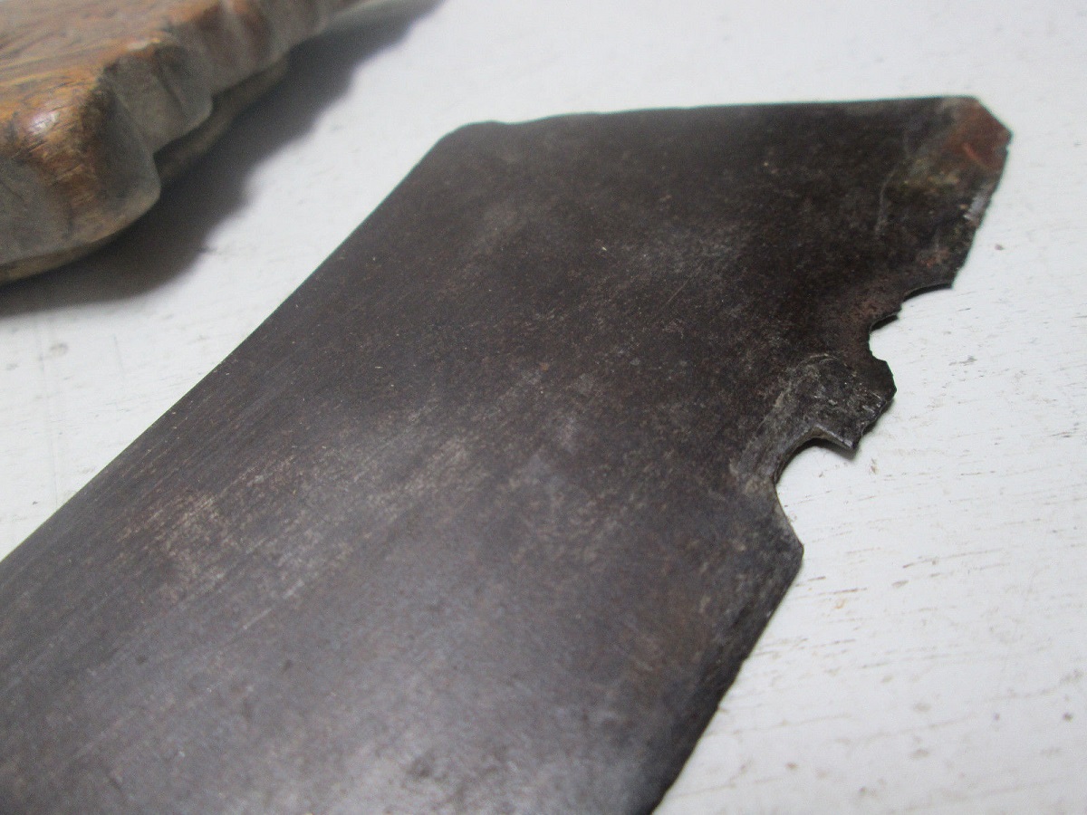

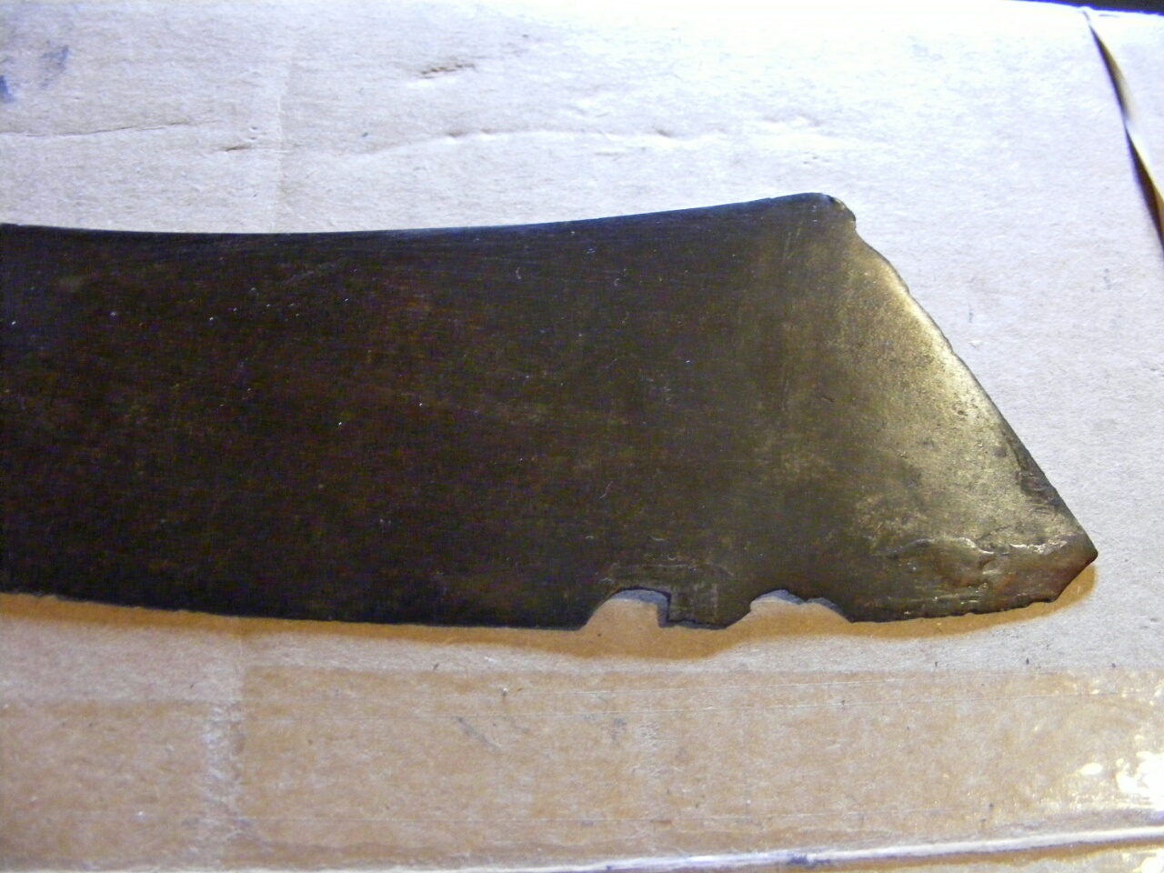

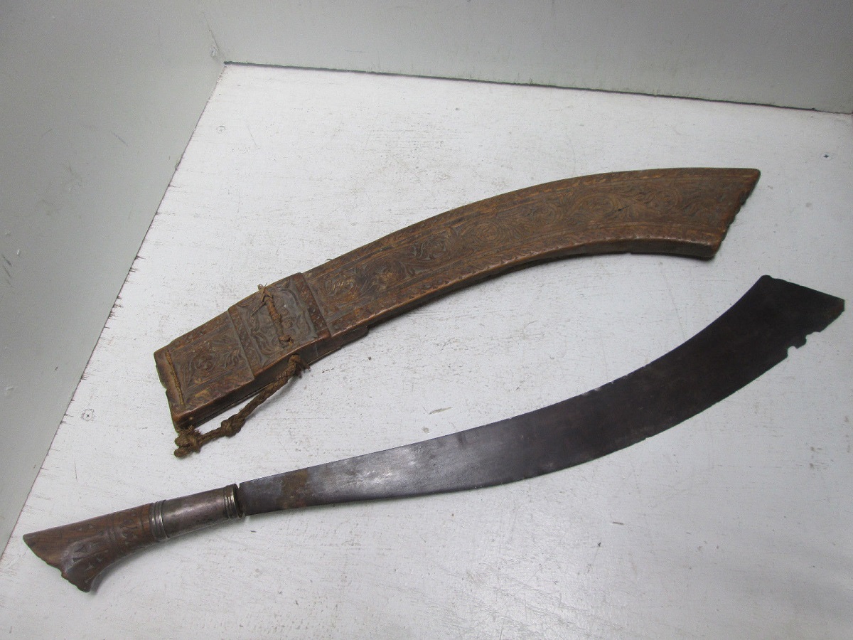

I should also mention the (yet again) extraordinary work Robert did in bringing this Parang back to life. It was in quite a sorry state when purchased, as usual Robert did an amazing job. Following are a couple of images prior to his efforts.

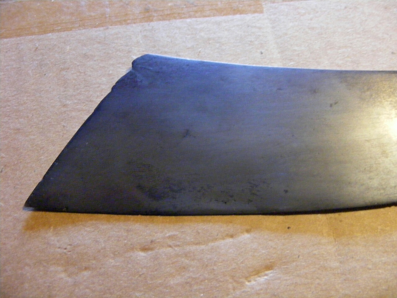

The blade's edge was not ground down or the tip reprofiled. The nicks in the blade as well as the broken tip were welded back by the use of both mig and tig welding and the use of heatsink paste. As I have already promised Detlef a line drawing showing how this was accomplished if anyone else is interested I will also post the drawing here as well. Please remember this procedure it not one to be taken on by anyone who is not an accomplished welder in both methods that I have mentioned and can easily result in damaging the blade even more or its complete ruin if not done properly. Thank you all for your kind words in reference to my work.

Before:
Old 4th November 2016, 12:16 AM   #11
russel
Join Date: Jul 2012
Location: Tasmania, Australia
Posts: 238
Default Close-ups
After:
